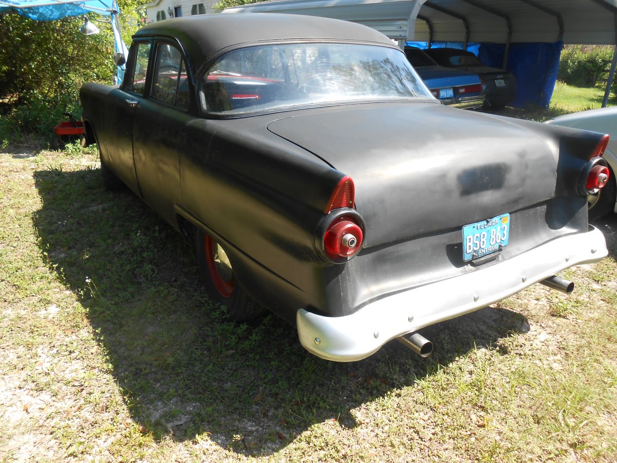

  22. Hdonlybob
    Joined: Feb 1, 2005
    Posts: 3,931
    Hdonlybob
    Most folks here do not like painted bumpers.
    I however do, based on the alternatives.
    Re chrome is very expensive.
    A good non shiny aluminum or light grey looks good.
    Also depending on the car, painting the bumpers a different color can be very effective.
    I chose to paint the bumpers a satin black on my car, even though the chrome bumpers were in very nice shape.. Biscayne Computer screen  pic.JPG
