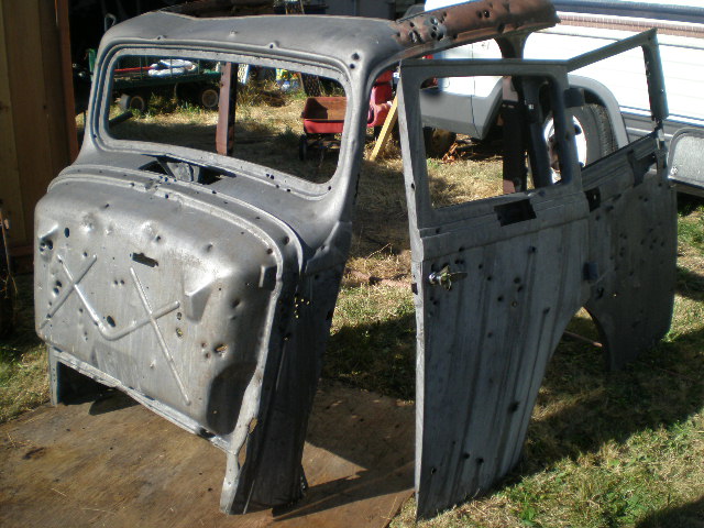

  22. 53 COE
    Joined: Oct 8, 2011
    Posts: 688
    53 COE
    from PNW
