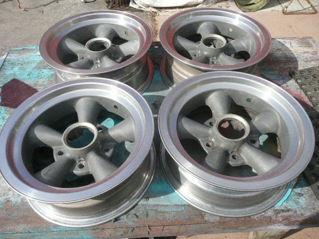

  1. When you call back on Monday and talk to Kim ask him about the possibility of plugging the 4 3/4 holes and then drilling the 5" bolt pattern. Might cost a little more but a better and safer way for the extra piece of mind and you will have an actual 5" pattern.

    Thanks. Lets see what Monday brings. If it warms up enough I can get the Belair out and measure and compare the hubs. That would be the easiest way if it would work. Somehow I doubt it though but cant hurt to scope it out

    Checked with him a while ago. 14x6 with a 5 on 5 is a real oddball

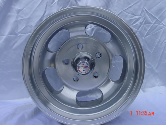

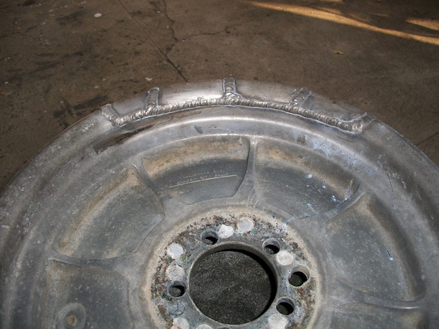

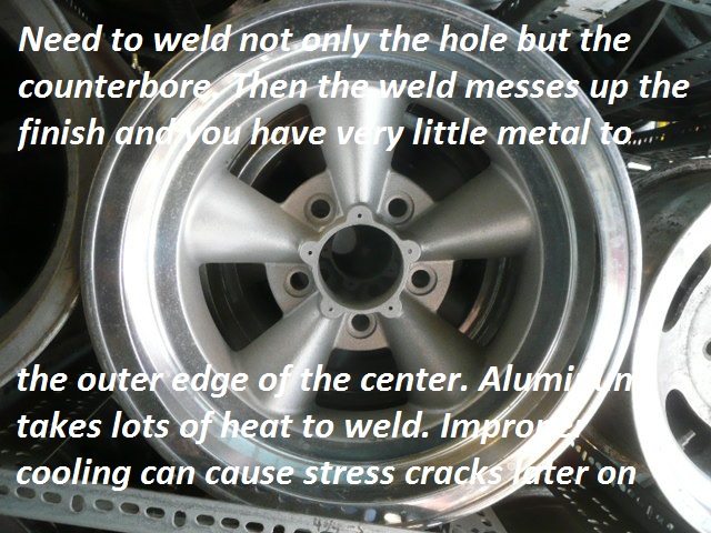

    Nope, you buy a dual pattern wheel to use for a spare. Surely people can forgo looking cool long enough to get to a tire store. What everyone is ignoring here is that plugging holes with weld introduces stresses into the wheel that could prove harmful. The construction of some aluminum wheels with a big flat center section makes it easy to redrill them. The wheels in question do not have that luxury and would need welding.
    I'm not a pro welder, but I know aluminum takes a lot of heat to weld and can cause stress and even warping. Friend brought me an aluminum oil pan he had managed to crack when a jack slipped. The particular aluminum composition of the cast aluminum pan made it difficult to weld properly. I would weld it and it looked fine. Then after a couple minutes I would hear a "pop/crack" sound. I ground the weld off and tried again.........pop/crack again. I could weld slowly and in short beads (1/2") with cooling in between and the inside weld looked perfect.Even used a heat gun after each short weld so that the pan cooling was very slow. Flipped the pan over and repeated the slow weld process on the other side. Then the inside would crack again. Spent about 4 hrs welding/ cooling/rewelding/recooling and no matter what I did, it would crack again. Did some research and found the proper way was to grind ALL of the metal out of the crack and try to fill the hole left behind. Threw the pan away and got a new steel one. Didn't want to be driving and have the pan crack under heat from the engine oil and lose all the oil and ruin the engine.......if I ever manged to get it welded without cracking. When you fool with welding aluminum, you can create a lot of problems if the component is in a high stress environment like a wheel is. Personally I wouldn't want to weld this particular style of wheel. ;)

    Two step process with a milling machine on the 2nd wheel you posted, one to take some out of the hole, the other to get the recess.
    Now IF (I wouldn't) I had to fill a hole, I'd press slip a slug then redrill/bore it, that would give you what might be needed without issue of heat on the wheel. Then again, that's a lot of work, and I'm a simple man.

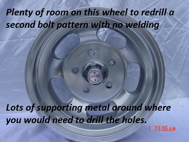

    If you have a classic or expensive wheel that has a hole or two buggered up, Your only option is to repair it.
    That can possibly be done by drilling oversize. Depends on the wheel in question and how its designed. If its not possible to enlarge the holes, then the ONLY option becomes welding. For buggered edges on a hole, minimal material will need to be deposited and less heat input into the wheel. Very little chance of inducing stress.
    The point you are missing is that having someone who is a qualified/certified/ makes their living welding.......and having your buddy Joes good friend weld your aluminum wheel can present a world of difference in the result you get. Thats why I posted the example of my self taught welding attempts on an aluminum oil pan crack. With the buggered wheel you are starting with a wheel that is already damaged and requires something be done in order to save it. In the case presented in this thread, nothing is wrong with the wheel and there are other better and safer options. Its simply a matter of choosing a similar cost option that doesn't weaken the wheel .
    Can the wheel be welded and remachined. Yes........but get someone who is an expert welder to do it. It won't be any cheaper to weld then remachine the wheels than it will be to redrill the Pontiac hub, as there is plenty of metal on the hub and its stronger to begin with.
    (Note: There are lots of videos on line showing welding being done on aluminum wheels. Almost all of them seem to be about repairing the outer edge of the wheel because a pothole broke it. The center mounting of the wheel is the focal point of all stresses exerted on the wheel, which makes a big difference )
    You don't need a drill fixture if you have a machine shop redrill the hub. They should have a rotary table that quickly and easily positions the hub for drilling. They can press the lugs out and reinstall them with their hydraulic press.
    Characterizing things as overthinking and preaching are convenient misdirection, but the truth is that there are risks to welding and remachining, or just machining an elongated hole. The first/best option is a hub with the correct bolt pattern like a Chevy, but my understanding now is that the Chevy is NOT a direct fit. Second option is to remachine the thick and rugged Pontiac hub to have a Chevy pattern staggered inside the Pontiac pattern.
    The wheel by design doesn't have a lot of excess metal and being aluminum, it needs all the strength it can get. Can you simply machine the slots out a little and use quality shouldered nuts to retain them? Yep ! You still have to buy new nuts and pay for the machine work. The logical thing is to pay to have the hubs machined rather than pay to have the wheels machined. If you want to call that "overthinking" and "preaching", I'm good with that. It sure beats the hell out of "underthinking" and then finding out that you made a bad decision when you have your family along with you and are trying to keep up with the 80 mph traffic on the freeway and suddenly have to panic brake to avoid the slowing cars ahead.....or just encounter a pothole. After all, its just an insignificant little wheel that you want to modify..........

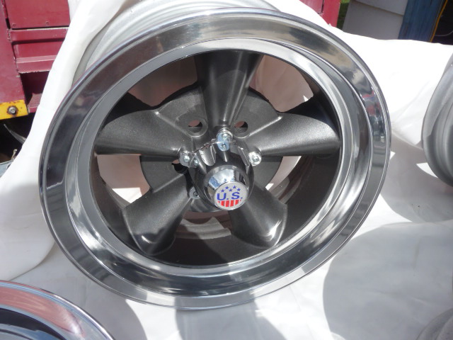

    Here are my 14 inch 5 spokes mounted on my 63 Star Chief. They should clear[​IMG]
