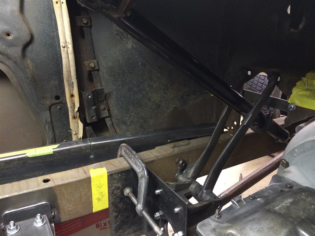

    I have 2 sets of F1 pedals that I am trying to use in my 26 Model T project... I channeled the body 4 1/2" over a Model A frame.

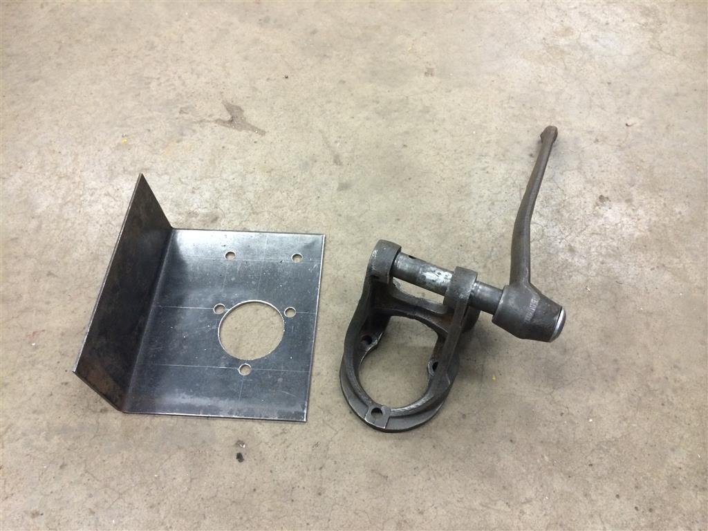

    So last night I made a quick bracket so I could C clamp the pedals in place...
    Now that I have my steering column in place, the pedals are way too high.... (somebody hacked the ends off, but you get the idea...)
    So it looks like I need to shorten the pedal by 3" or so (I really can't lower them...)
    So I know I will affect the geometry of the braking, but has anyone else done this successfully? Ideas or pics would be appreciated...
