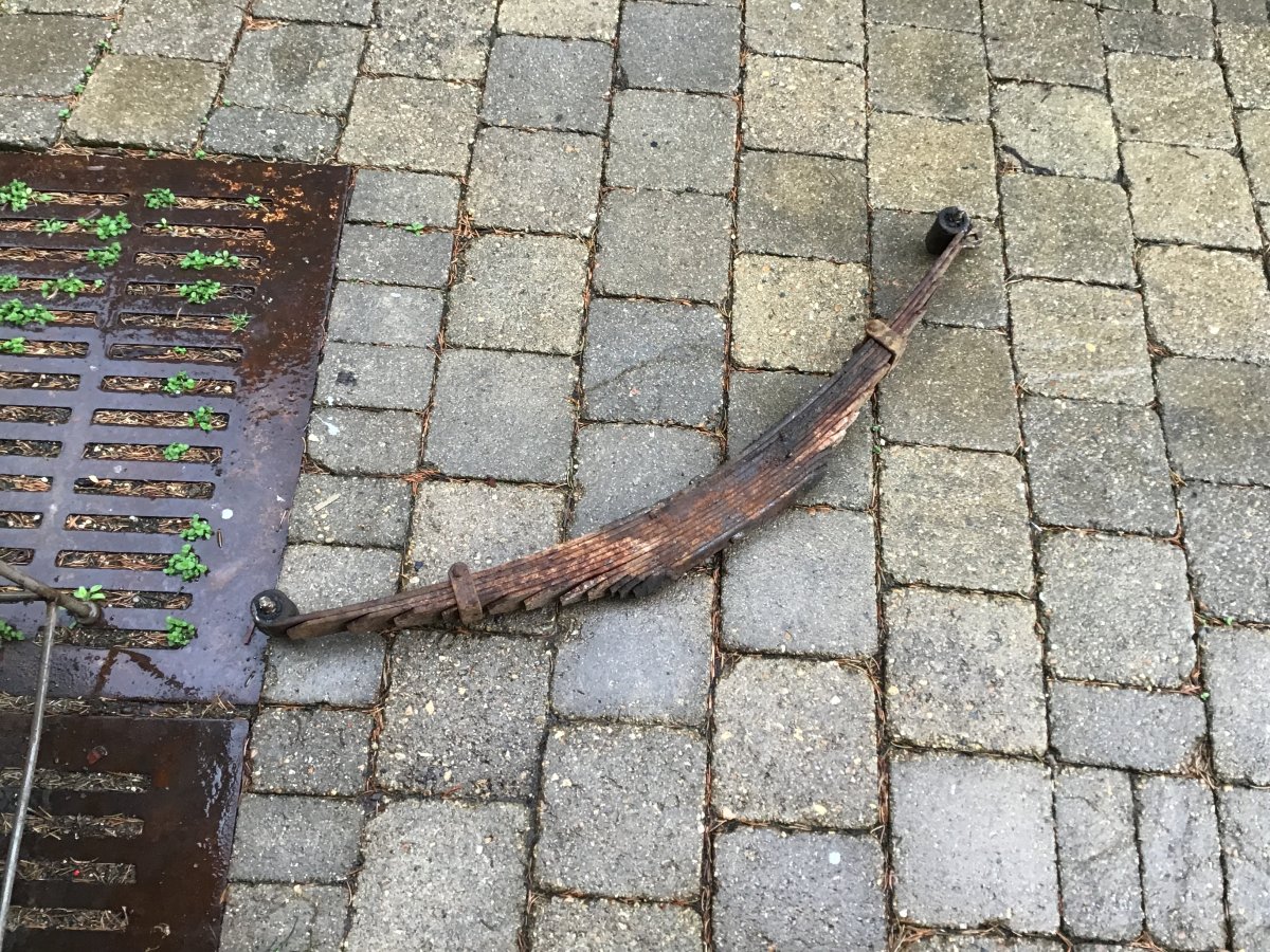

    I want to lower my 1946 ford fordor.
    After taking my spring apart i found out it has a channel/ reverse bead ( sorry I don’t know the right word) on top of the leafs.
    It looks factory but i’m not sure , i never saw this on my model A springs.
    First question: is this factory or just worn out ?
    Second : if it is factory can i reverse the spring ? The channel will then be on the bottom of the spring.
    thanks,
    Dennis

    The Groove Is Factory And Allows Grease To Be Pumped In Between The Leaves....Proceed..

    Is that a crack in the spring in that picture? That would be a definate no for me if so.
  5. dutchrod
    Joined: Feb 5, 2009
    Posts: 449
    dutchrod
    no crack , i made some scratches when scraping the dirt off

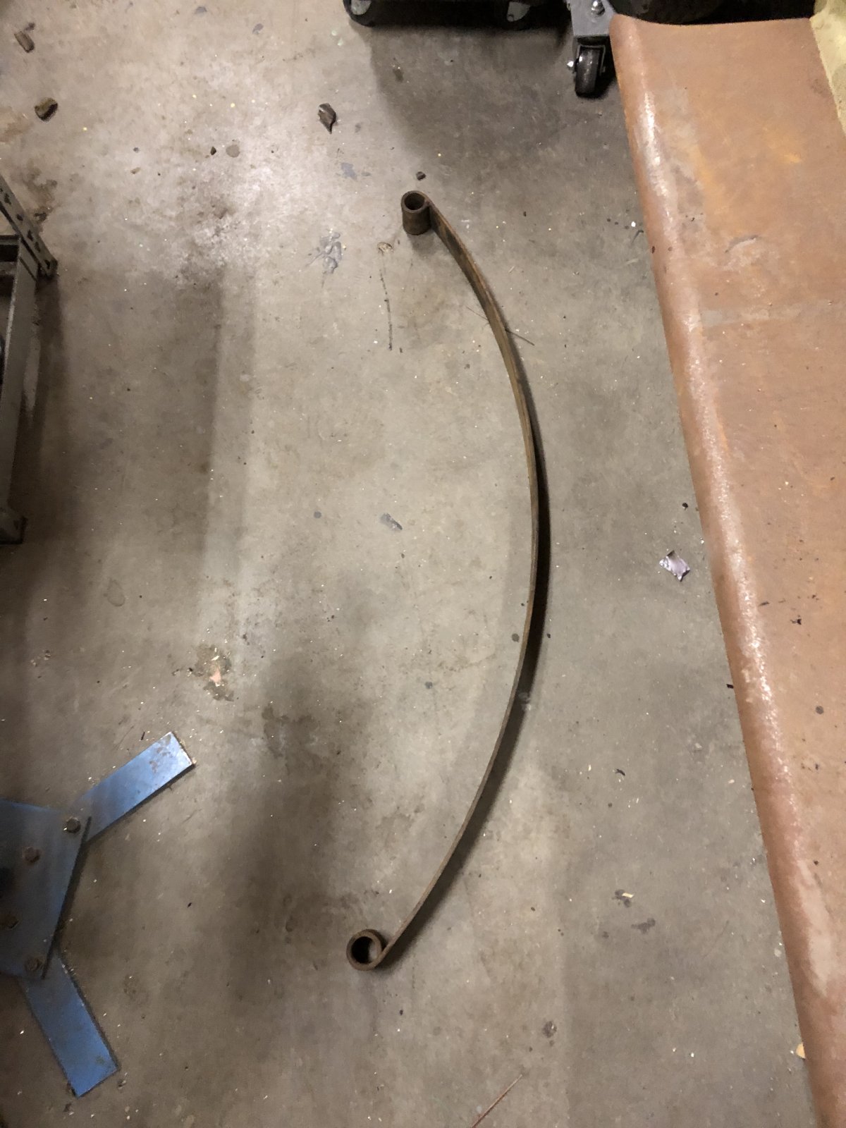

    When you reverse the main leaf the eyes get further apart, this means the shackles hang down, so best to take it to the spring shop to get it sorted.

    In that case go for it. Ive done it 2 ways. Either way I trace the spring on the garage floor. Then I mark the spring every couple inches like frets on a guitar.
    The first time I reversed one I used a 3 pound sledge hammer and hit the spring at every mark over an I beam. Didnt taken that long really but I was in my 20s. Now I put them in a press at every mark. Check it against the outline on the floor. Usually takes 3 passes on the press. I always over arch it a bit

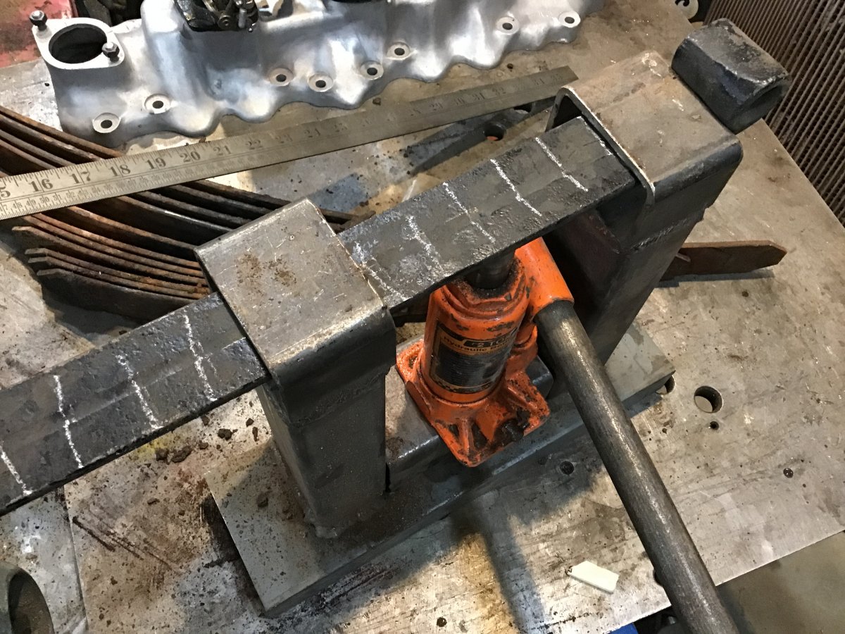

    I made a simple fixture
    I copied it off the hamb years and it works great and have done a truck load ..
    I mark the spring curve arc on the floor and will copy the . I then mark every inch with chalk and install into fixture. I then Jack it up in the position. Then move to the next go slow and nice and quiet enjoy. 3AD801D9-57A7-476C-8A1D-E9525E9961C9.jpeg 64A0C2E4-1731-4630-ABB7-FEB464703997.jpeg 5B062E8E-7B5D-4AAF-BB9E-166E93DF24F5.jpeg 14389D0D-15A4-44D0-80EB-0C5F92AC86AC.jpeg 975D7825-51BE-43AF-9102-CE4FF97B5341.jpeg 35E68FA2-8718-4823-9BA5-6D2C0A660045.jpeg

    @seb fontana like the fixture and dial indicator on top great idea. Worked in a spring company for 20 years and rolled the spring into shape but Jack will do the same job . As they say more the one way to skin a cat..
