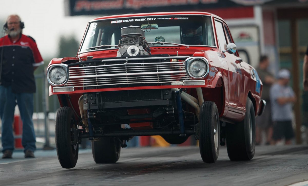

  12. Bandit Billy
    Joined: Sep 16, 2014
    Posts: 12,375
    Bandit Billy
    That looks exactly like my Nova! 'cept mine has a hood and the front tires are always on the ground, and mine isn't very fast...but other than that...
  13. squirrel
    Joined: Sep 23, 2004
    Posts: 56,085
    squirrel
    I have a torch, I can cut a lot of stuff, too. But making it look and work like it ought to...that's a whole nuther can of worms
  14. DDDenny
    Posts: 19,265
    Right
    Just like it but completely different, but that can be easily retified!
    dwollam and Bandit Billy like this.
