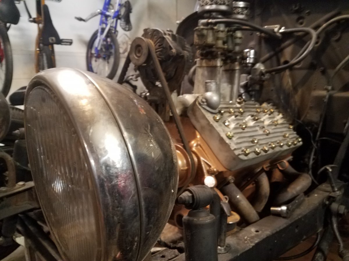

    I soon took the engine apart to check and inspect but got side tracked for awhile. In the mean time the tired flatty in my coupe just kept on going. Wasn't long after this that Harry passed away and it always bothered me that he didn't get to see his ol flathead in my hotrod. Fast forward to last July and my son said we should take the coupe the the Hamb Drags. It is a 6 hour drive and I asked if we should finish the HO flathead or just go wth the one that works? He said HO! and then we will race for fastest flathead award.
    That was the push that I needed . We had under 4 weeks to make this happen. This is also in our very busy Bmx season so with work, racing, and also being very involved with the local bmx track this was a lot on my plate.
    I did get the engine assembled and installed my Sharp high compression heads that I scored from Tuck. I also stripped off the Ford blue and sprayed it bronze 20180807_233826.jpg 20180813_212456.jpg 20180807_233826.jpg 20180813_212456.jpg
