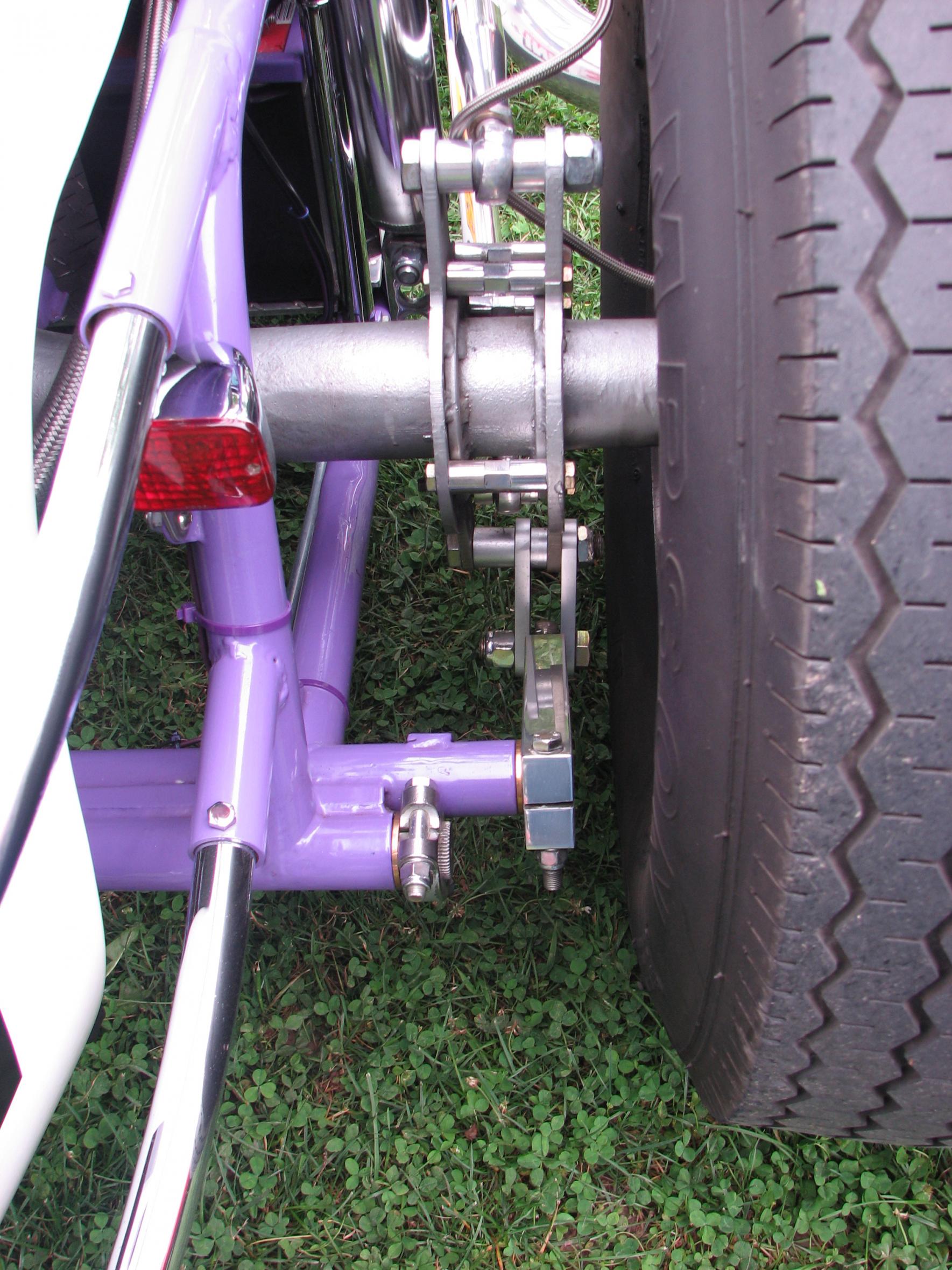

    I am looking at a street rod that has sprint car torsion bar susp front and rear. The aluminum Torsion bar control arms ride/rub/support directly on the axle tubes. Is this a reasonable system? I can deal with periodic maintenence if required. IMG_0001.JPG
    Regards,
    FRank

    Joined: Oct 31, 2006
    Posts: 26
    00fxd
    from BC Canada
    Any thoughts anyone?
