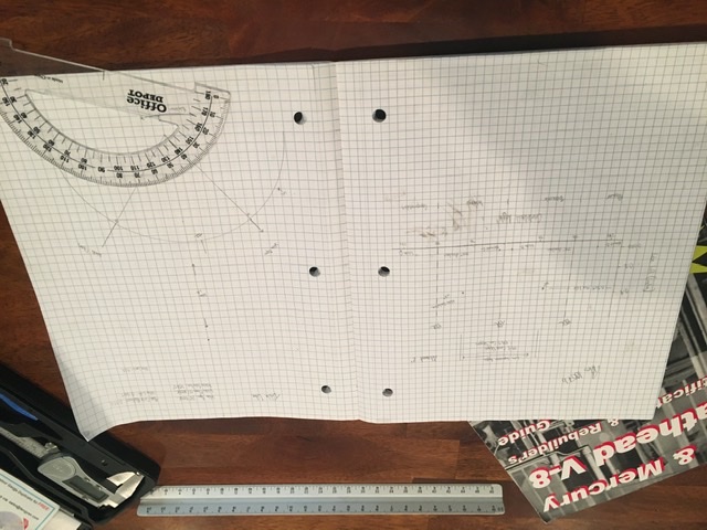

    Hey all you cam nerds! Who here is taking the time to put pencil to graph paper when making camshaft selections!? I recently inquired about having a ‘regrind’ not knowing enough about the dynamics once I got the specs back I started diving into the theory. It’s pretty neat what kind of numbers you can derive out of timing specs alone. The more I learn the more questions I have. Rod length affects cam timing?
