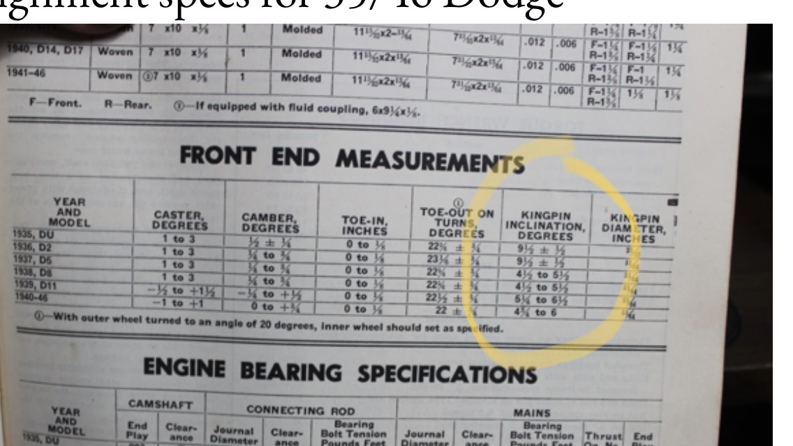

    Thanks for posting that @Mr48chev, I looked but couldn’t find those specs.
    There is a difference between ‘35-‘36 and ‘37 and up, could be a mismatch of axle to spindles.

    Some snooping shows that 36 and 37 have the same king pins Probably making a junk yard spindle snag from the wrong year real easy.

    the axle has the curve in the middle, it faces forward so it can't be backwards. My spindles are 36-59 truck or 40-42 car according to RustyHope's website, 4 hole, top holes 3.5 inches apart. They have a pic on there of them also. I guess someone could of used truck spindles on whatever year axle this is. I did mount the calipers on the rear if nothing else for looks. Only thing I know to do is use a rose bud and heat them and set the camber at a 1/4+. From the info posted that is what the 40-42 cars called for. I can't help but wonder if at one time this axle was under an old farmers trailer. It looks just like a few trailers I've seen that was over loaded. The spring pads were removed when I got it and it was mounted suicide style as can be seen in the pics. The big round tube and spring bracket are going to be cut off and frame horns added.
  7. nobby
    Joined: Jan 8, 2006
    Posts: 1,217
    nobby
    is it about 3 degrees out
    are some spindles 10 and some 7 degrees, king pin to spindle
    -i.e. you can't run a F1 spindle on an early ford axle even if the pin bore is the
    is that the same axle as what you have?, this one is running ford spindles, I think you have f1

    He has a tube axle and damned few guys who do I beam axles every day of the week are going to want to even try in it and sure not for 5 degrees. Maybe 1/2 degree to correct a tweak from hitting a big pothole but any more than that is going to be a serous challenge.
    I'd still have to believe someone who had it before he did scrounged a pair of 37 spindles from a donor and stuck them on the 36 axle as that would throw the camber off just about exactly what he is seeing.

    Wrong spindle for that axle is my 2 cents . A good front end man and 2 priests will not be able to tweak that into specs with out damaging the axle beyond repair . Cutting and welding the axle , why ? Find the correct spindle .
