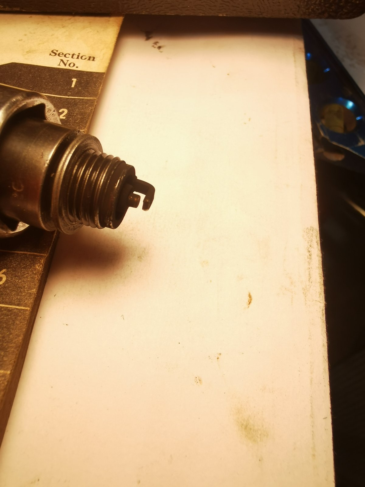

    I installed 57 jets. Seemed to run nice but still rich. See photos.
    Also changed them to 55 jets. Still seems rich. See photos of spark plugs. Last photo is 55 jet.
    Compression on motor is 150 to 155 on all cylinders,as per manual.
    Let me know what ya think. Smaller jets?

  28. Are you running now with the end carbs blocked off? You must rule out the fact that those end carbs could be leaking by the throttle blades.
    bchctybob likes this.

    Running centre carb only, others are blocked off. Ran motor for 20 min on each set of jets. Cleaned plugs before running jets.
  30. What happens when you drive the car under full throttle acceleration? That's where you don't want to be too lean. Does it ping?
    The plugs are black, but not that bad for just idling. Reading plugs with today's gasoline is pretty difficult.
    Judging the air/fuel mixture efficiency based on an idling engine is not that helpful. A 50 miles drive by the feel in the seat is more important.
