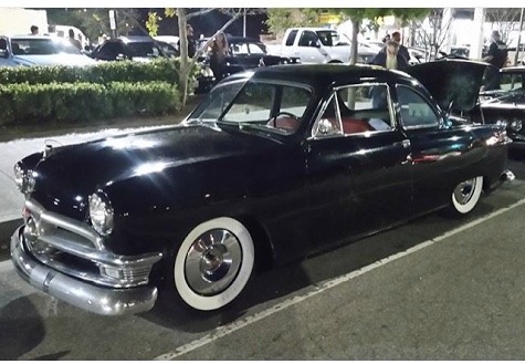

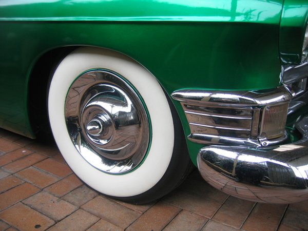

    I just did two sets of brand-new McVeys last week, and have done at least 12 sets in the past few years... I weld a trim ring to the backside of the sombreros. Send me a message for pricing. Reproduction (McVeys) or original- same prices to modify.
    I also modify the '53 Cadillac hubcaps in addition to the '47-'52 sombreros.
    Here are some pictures:
    EVL401, Sprout and The Shift Wizard like this.
