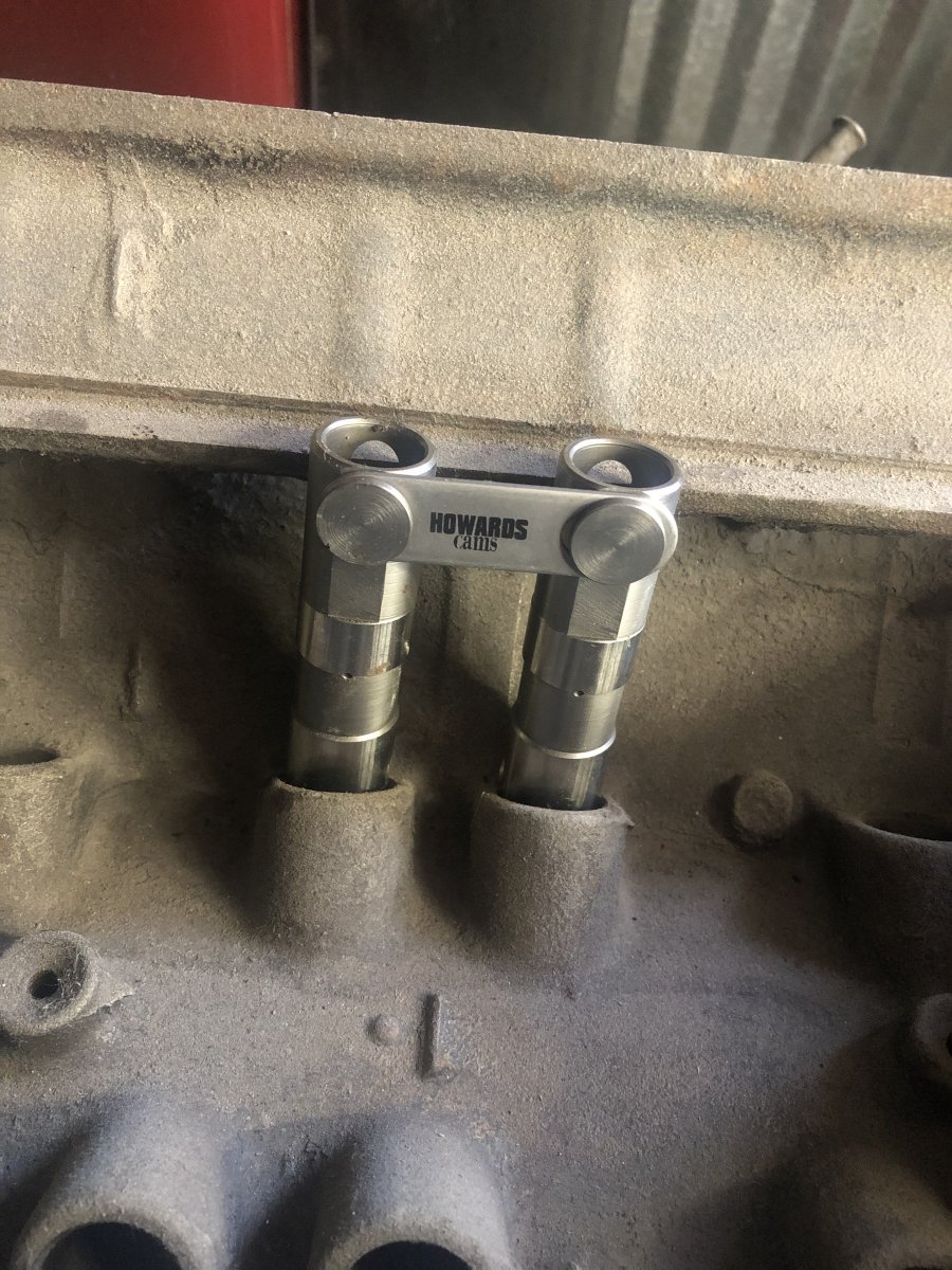

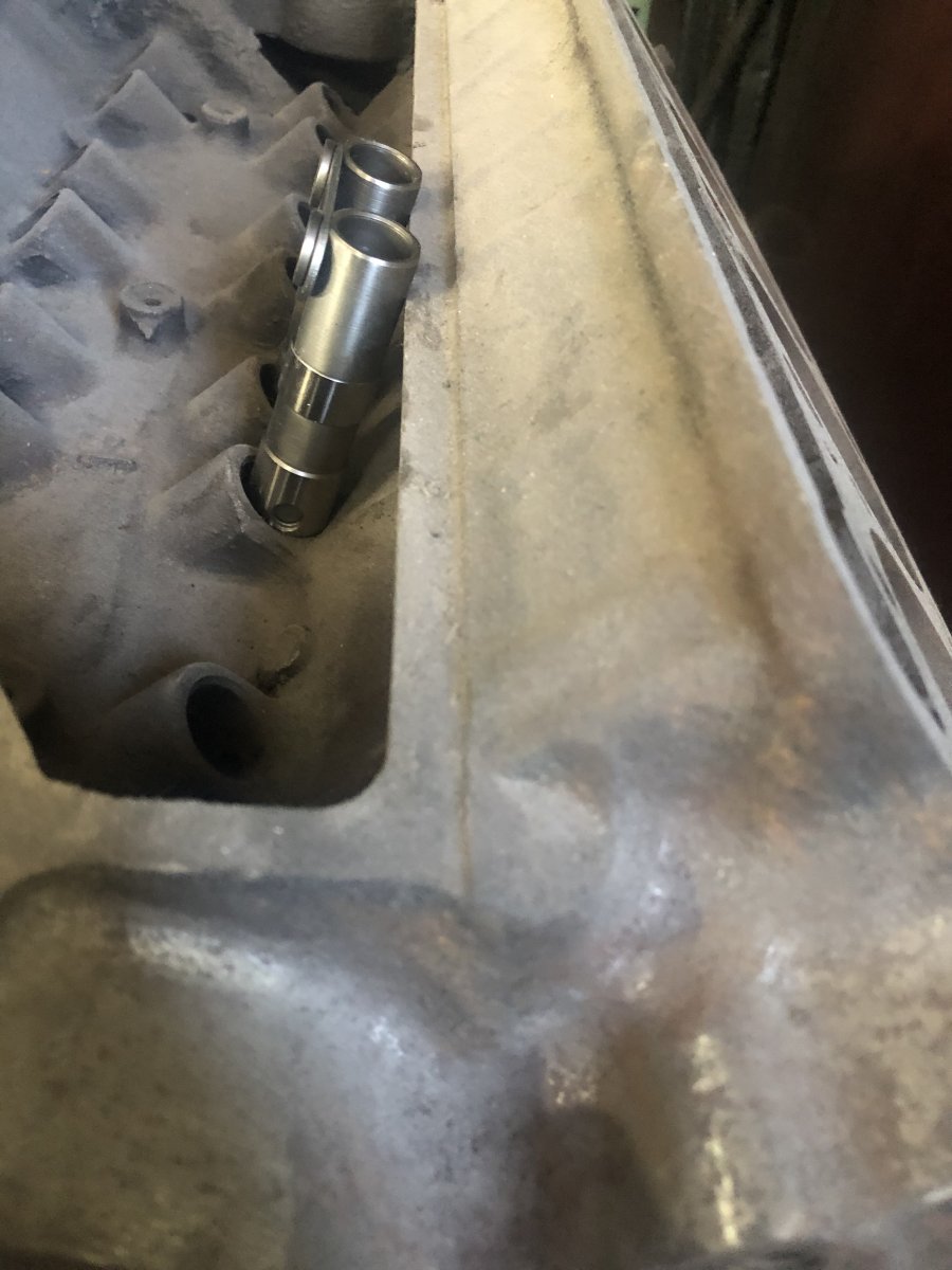

  10. Roothawg
    Joined: Mar 14, 2001
    Posts: 24,589
    Roothawg
    CADDY BLOCK
    FACTORY ROLLER BLOCK

  14. Roothawg
    Posts: 24,589
    Roothawg
    The Caddy is kinda a one of a kind blank.
    Pics for reference.

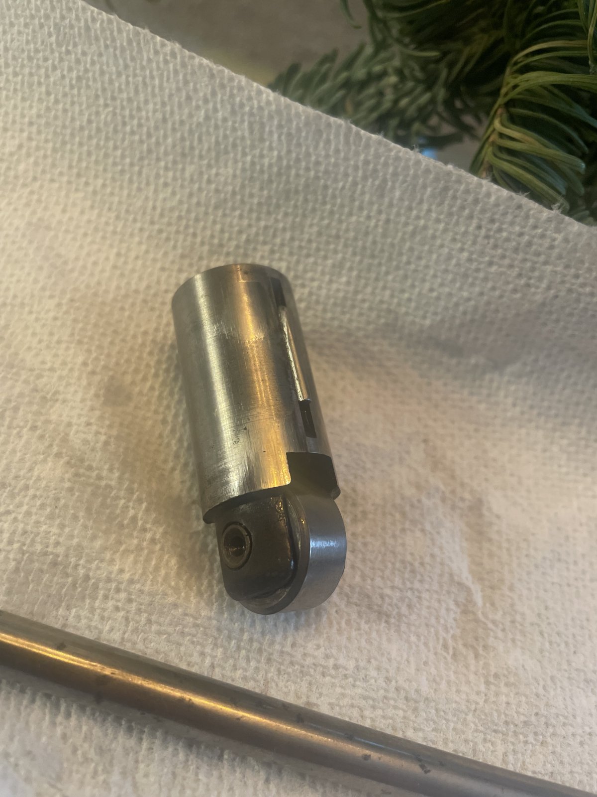

    I bought a 55 tbird that has a Cadillac 390 thats been worked long ago. Doing some investigating, the engine has a roller cam with keyed lifters, not sure who made this setup, anyway the engine ate one of the lifters (and probably the cam) and now I have my engine that has been machined (unless a slotted sleeve was installed and I didn't notice)for these keyed lifters and no replacements to be found.
  20. Mitchell Rish
    Joined: Jun 10, 2007
    Posts: 1,911
    Mitchell Rish
    from Houston MS
    Didn't Crower use that style at one time. I have seen some SBC short roller lifters that had a single roller bead/key much like that. Uncle Marion used to have several sets .We used a lot of his Used trade in stuff in the early 80s . I remember them because the block had to be broached/ grooved with a tool that fit in the lifter bore.

  22. CNC-Dude
    Joined: Nov 23, 2007
    Posts: 1,032
    CNC-Dude
    Yes, Crower made them like that for the Flathead Ford and probably others back in the day. Jesel and others make them today. Expensive I'm sure whomever you get them from.

  28. flamedabone
    Joined: Aug 3, 2001
    Posts: 5,453
    flamedabone
    That too tall to clear the valley deal kind of kicks the whole thing in the nuts. I'm waiting to see what you do as I will be building mine in late '23.
