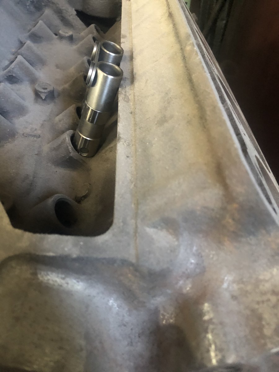

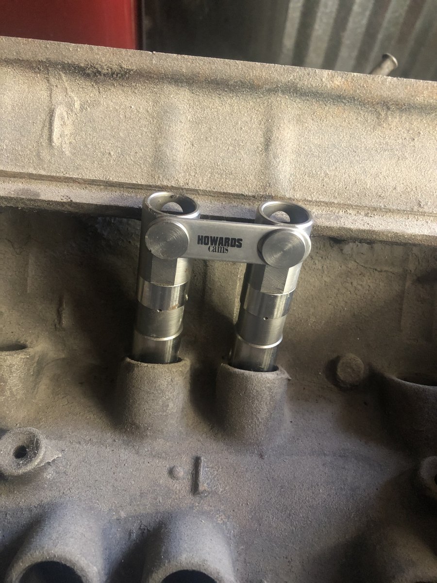

    Ok, new issue. I tried a set of Howard’s hyd rollers and the spacing it the same, but the Caddy has an overhang in the block that the sbc doesn’t have.
    Not sure how tall the OEM rollers are with the valley spider? I’d have to research the heights n all the different mfgs. B4AD6F5A-BF76-4319-9300-DD3C4611519E.jpeg 83FBC90F-DE30-4355-AE72-7E40D3BF88F1.jpeg

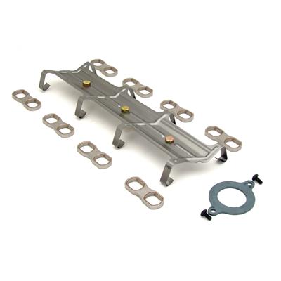

    When GM went to the roller cams in small block Chevy engines they used a bar that has a slot in each end to orient the lifters. Each lifter drops in singularly. Each lifter is flat on the sides. Then the bar with the slots in it slips over the two lifters after they are installed. That type should work for you. Probably cheaper to buy too. The video below is not exactly the same, because the bar has open ends whereas the GM OEM is closed on the ends.

  21. triumph 1
    Joined: Feb 9, 2011
    Posts: 591
    triumph 1
    1987 & up with factory roller cam
    (Corvettes & tpi Camaro’s)
    Roothawg likes this.

    The howards lifter can be relieved for valley pan lip clearance to get them in. That top area is non functional except for the side that has the anti-rotation bars attached. I have some from a SBC that are cut away, probably for weight reduction.

    This is what the stock 87 up “spider” looks like. It bolts down in the valley and the fingers simply keep pressure on the center of the link plates. I don’t have one here to try but I bet it would be pretty straight forward to adapt to the Cadillac. 6320DDE3-ED09-431F-BDAB-7AB70B8891DC.jpeg
