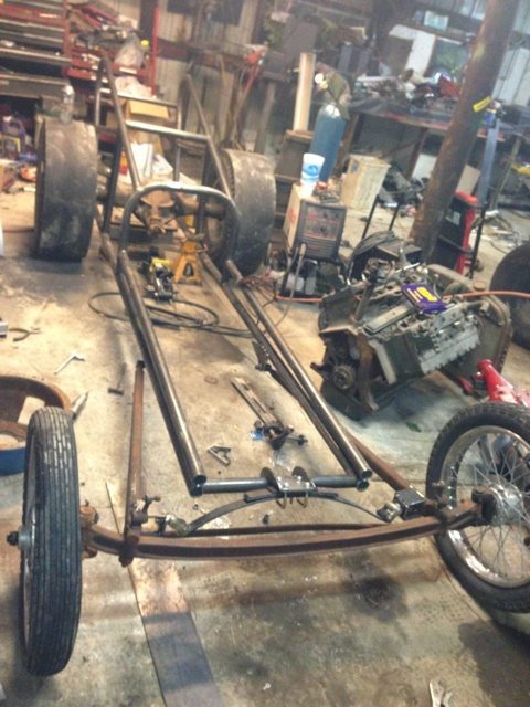

    Well I was able to make some progress tonight I narrowed up an 8 3/4 Chrysler housing I had and stabbed a center section in it then cut down some old broken axles I had laying around so I could at least make a roller out of it then fabbed up some mounting plates for the rear mounted up a set of wore out pie crust slicks on some old slot mags I had for some set up rollers and voila I now have a rear end tacked in place I also mounted they spindles I machined to accept some vintage 19" wire motorcycle wheels I scored awhile back on the 40 ford axle I'm using and as soon as I get a couple more pieces made I will be able to mount the front end in it and the digger will be a roller here are a few pics

    Thanks for the good words Carl Tim and Tom you guys are an inspiration to me on this build after watching you guys build your cars a thought I gotta have one myself anywho I got the front suspension tacked in place last night still got a lot to do but at least it's sprung and Rollin now I'm gonna try to get this thing outside this weekend for some better pics in the daylight

    I was able to get the digger outside today for a few pics and maybe even sweep the shop up a bit

    That's a great looking build you have going there. Looking forward to seeing it with the Cadillac Flathead in place.

    Thanks I too am ready to see the caddy mill sitting in it better yet I'm ready to blast down the quarter mile in this thing
