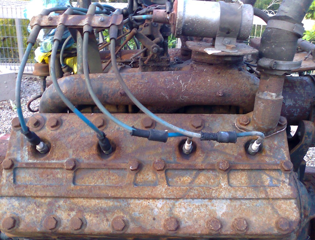

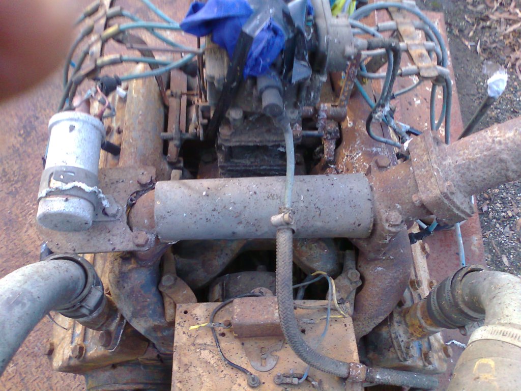

    Hi Fiftyv8. Got another Flat Cad... The interesting thing with this one, from a Genset, is the Exhaust manifolds.. Whilst a fabricated set of Lakes style would be ideal these may give me some options, the ability to use the stock holdowns with the blower manifold
    In the pics you'll see that the only exit, on each manifold, is via the front located crossover pipe.. remove that, swap from side to side and I'll have outward located exits on each side, at the rear of the engine.. won't be as 'neat' as a set of 'lakes' style but stock hold downs and OK clearance between the heads, exhaust exits, blower manifold and the 4:71 case make it worth looking at.. will do a strip down and mockup to see how it all works.
