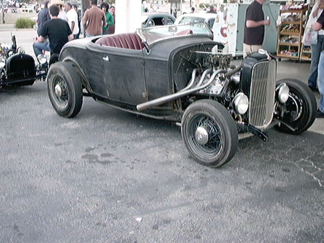

  6. Heres a picture of the rest of the car.
    CBB

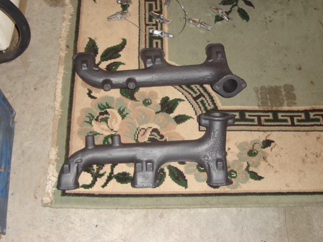

    Never did make those headers, I found me a pair of what seemed to be unusual exhaust manifolds that were not joined with the usual bridge pipe setup, so for now I have decided to run with them.
    Pic's posted.
    If I am unhappy with them or they crack etc, I will probably make my own and steal a few ideas from that ace set up made by 38flattie on his Bonneville project engine.
