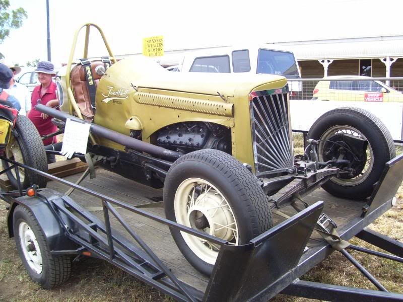

  5. Sounds bad ass, may we see?

  7. 38FLATTIE
    Joined: Oct 26, 2008
    Posts: 4,349
    38FLATTIE
    from Colorado
    Cool car. I've got a tranny if you need one.

    James Corbett,An Artist from Australia who is having an exhibiton in London at the moment built this and races it very successfullty down here. The rules are pretty strict,no later components from beyond the cars era.
