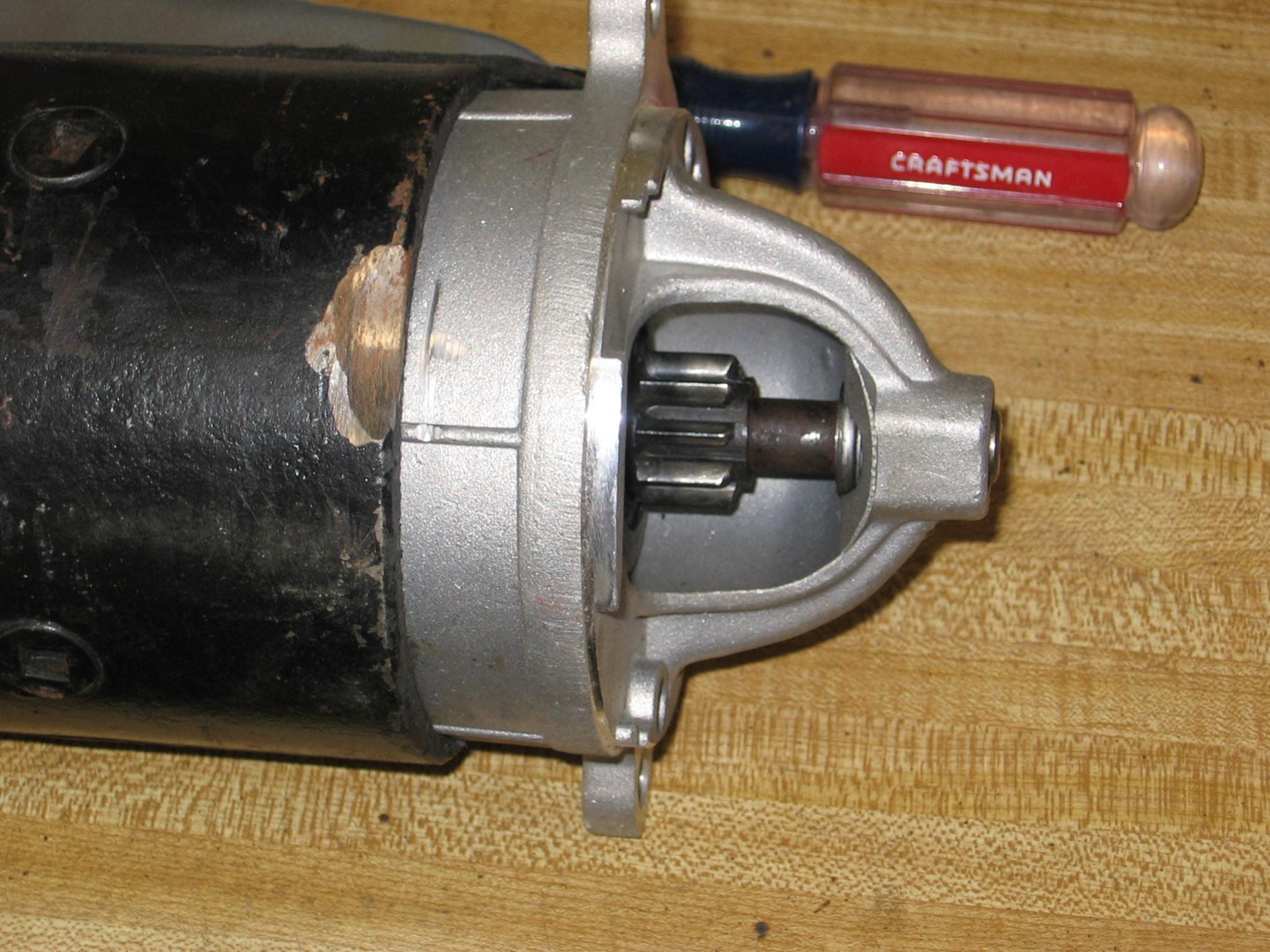

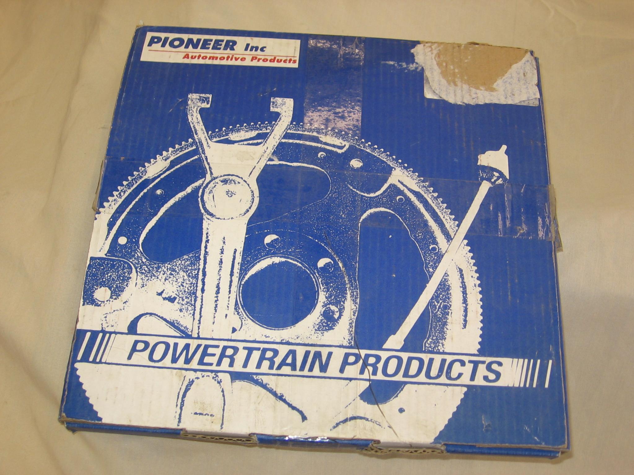

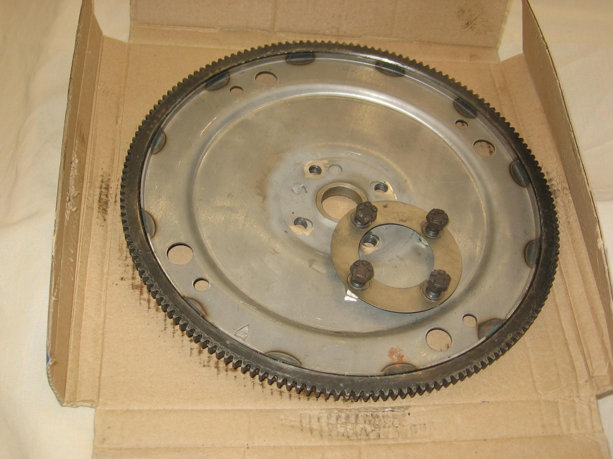

  23. This is what a adapter kit looks like........they're quite simple really, & not expensive, just make sure you get the kit with the larger flywheel. I think it's got 164 teeth. :cool: Kit includes a starter end that fits a common 1970s -1990s Ford 12V starter. You have to grind a small knotch for it to fit. All done.................:)
