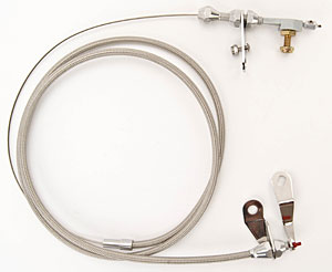

  10. JOHNPO
    Joined: Dec 1, 2010
    Posts: 76
    JOHNPO
    Lokar c4 kick down cable
  11. need louvers ?
    Joined: Nov 20, 2008
    Posts: 12,911
    need louvers ?
    I personally wouldn't use anything but the Lokar stuff these days. The stock lingage is double ugly.
