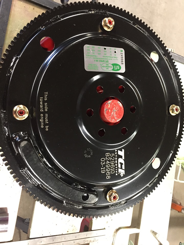

  15. LM14
    Joined: Dec 18, 2009
    Posts: 1,936
    LM14
    from Iowa
    I used TCI-529610 because I needed the earlier 157 tooth flex plate. The TCI-529620 would be correct if you need the larger 164 tooth flex plate in the larger bell.
    SPark
