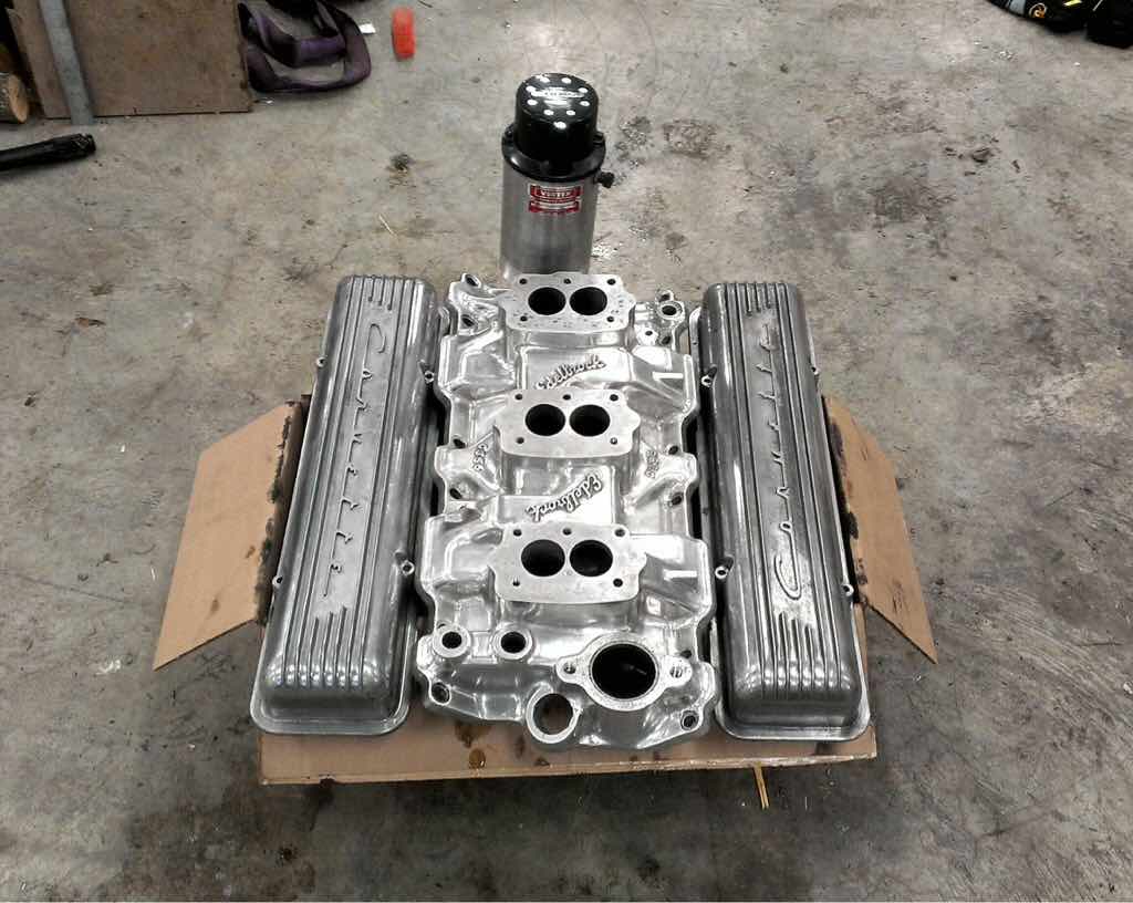

    So in a recent trade I acquired an Edelbrock C355 manifold and some other SBC parts, I understand this was basically a 1 year manifold and it has small ports for the early 265 heads along with a couple other one year only features. My question is, performance aside, can this manifold seal to and work with later 283 heads with larger ports? It seems to me that feeding larger ports into smaller ported heads (just the opposite of what I am wanting to potentially do) would be more difficult than feeding the smaller ports of the C355 into larger port heads.
    The only reason I have an interest in using this manifold is that it has some history that is close to my heart.

    If those valve covers are the ones you are going to use, you need to use pre '59 heads for the staggered bolt pattern. That manifold should work fine on all pre '59 heads.

    Got a set of 57 heads in the trade.

    The heads are I believe 1957. The ports in the heads are a fair amount larger than those in the manifold, but there seems to be quite a bit of meat on the manifold around its tiny ports. ImageUploadedByH.A.M.B.1419177746.731845.jpg
