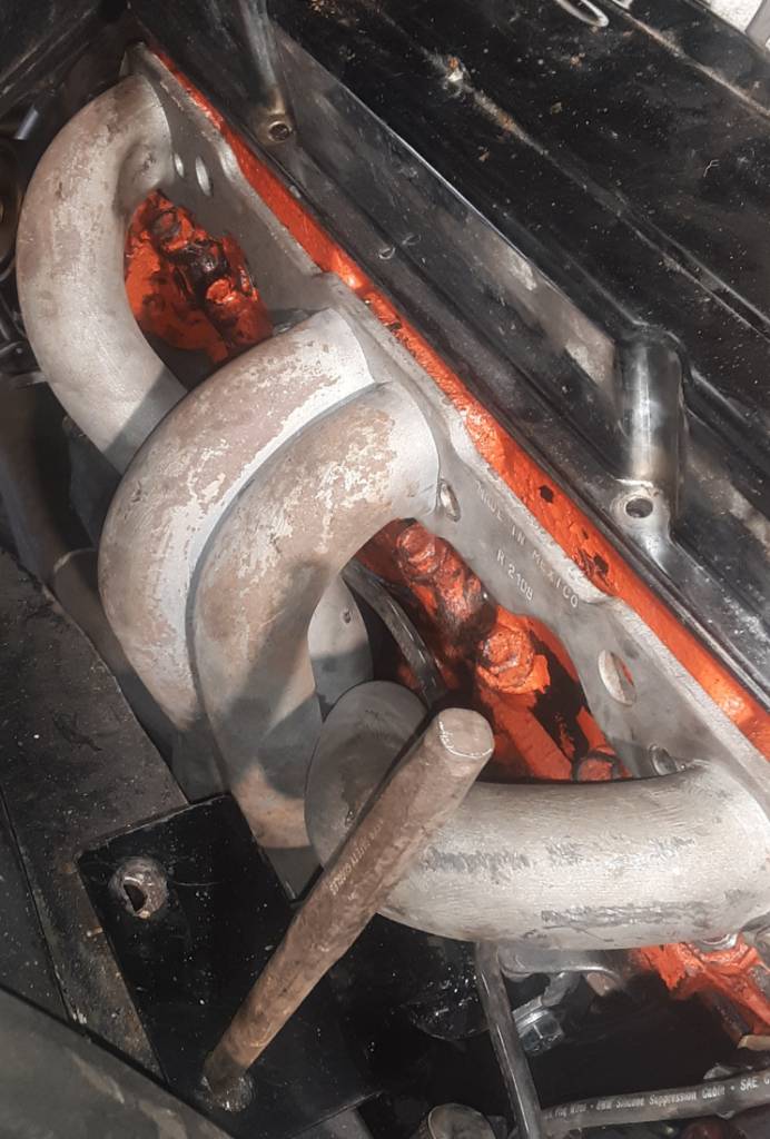

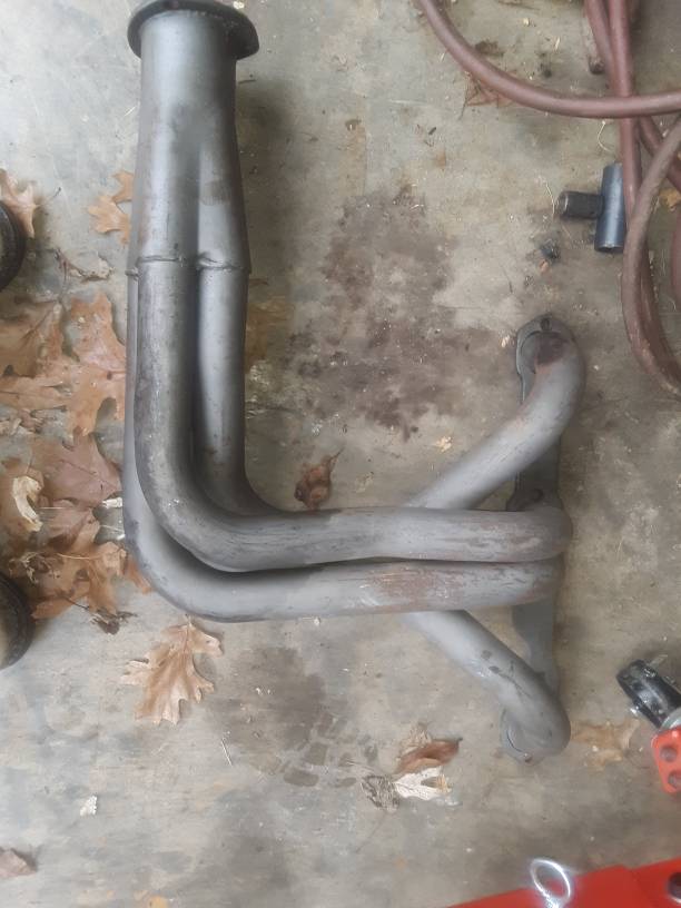

    I have a 66 c10, I put a sbc in it,I had a set of headers on it but in the location the motor mounts bolted up, the passenger side header hits the a arm. There is not a ton of room due to starter, a arm, and frame. I saw some rear swept headers on computer looked like they might work. Has anybody used them? The photo shows the space on passenger side, the center drop headers are the ones I pulled off. Thanks Screenshot_20201112-194549_Facebook.jpeg 20201114_120249.jpeg 20201114_133959.jpeg Screenshot_20201114-135602_eBay.jpeg

    Wouldn't it be best to just order a set of headers made for a '66 C-10 ?

    you have the engine in the wrong place. The frame brackets for the motor mounts are supposed to be in the rear position. The 67-72 trucks had the engine in the forward position, like yours is set up.
    at least that's what it looks like from what I can see. If you hold the camera back a bit further so we could see more of the engine, frame and firewall, might be easier to see.

    If the engine were in the rear holes only 1 of the lower mount holes line up.

    I can't see what brackets you have. There are several different ones, for different engines in different years. The 292 six engine has one mount forward, one back. Both mounts on the 230-250 from 63-72 are back. Both mounts on the V8 in 63-66 are back, but in 67-72 are forward. It's complicated.

    When I had the 350 in it I had a set of Patriot headers on my 71 GMC The right side came down like this as viewed from the bottom side
    It's too dark now to go out and get a photo of the header.

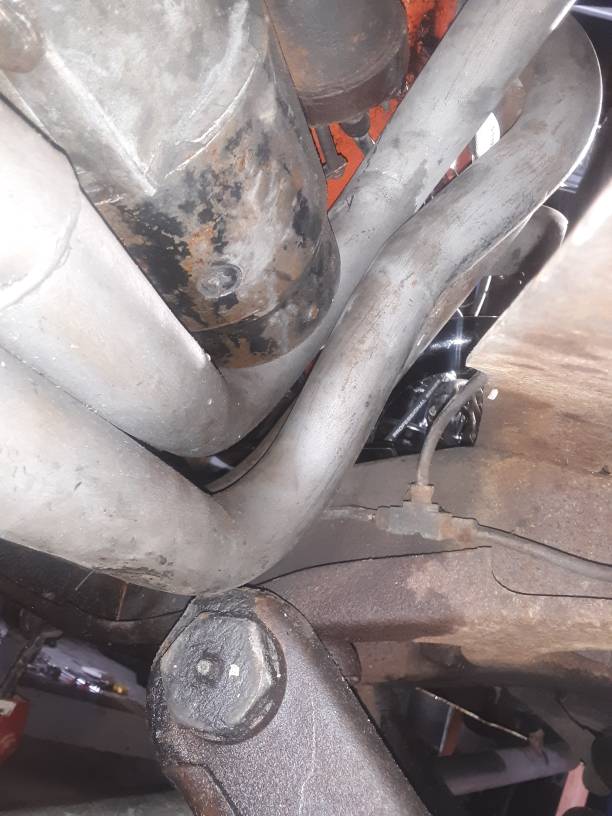

    The center dump headers will definitely not work. Moved the engine back to the rear position, headers are setting on the a arm and very close to the starter and trans pan. Not sure any center dump exhaust will work, not sure there is enough room to bend a pipe out???

    Why do you have an aftermarket crossmember for the mounts, instead of the original mount brackets?

    I bought the one I think it was brothers truck for 6 cyl to v8 swap. Bolt up no drill etc... came with new mounts and all hardware. Did not know old perches would work

    do you still have the old perches?

    Yes, the new one line up ok, they move the engine back
