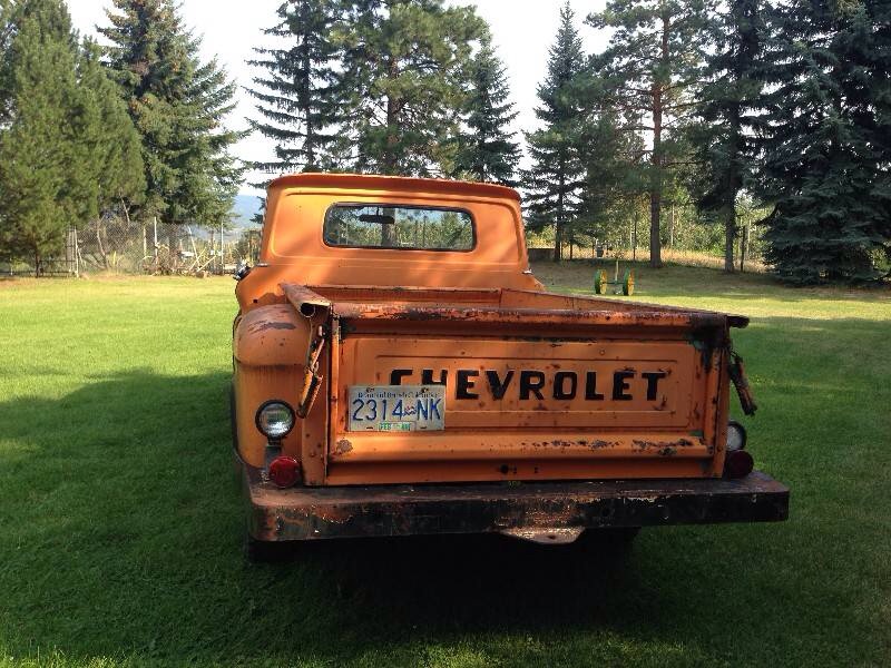

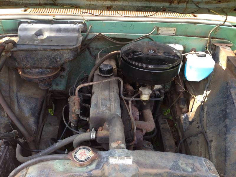

  1. I bought a 62 c10 stepside longbox a couple weeks ago and I am not sure if the engine is original. I know for sure it's a 261 because of the captains bars above the starter and the casting number. But my question is how did the engine get in this truck? They only came in the 2 ton trucks or in Canadian pontiac cars, but I am almost positive that it's original. The whole truck has never been messed with, the firewall even has the chalk markings from the factory and the original glass fuel filter bowl. One guy at a car show told me that on the assembly line if they didn't have a 235 available they would throw a 261 in it. Any info on this would be greatly appreciated. image.jpg image.jpg image.jpg image.jpg image.jpg image.jpg image.jpg image.jpg image.jpg

    Does the engine code on the tag, match the engine code on the engine?
    But yeah, you can actually change an engine without removing the crayon marks on the firewall, or getting rid of the glass sediment bowl. And 55 years is a long time for an original engine to last, it's pretty common to change an engine in an old truck when something happens to it.

    Just be glad you got a 261 with your truck. It's an excellent engine that's getting hard to find.
    Get it rebuilt, add some Fenton split headers, a dual carb intake and a mild cam.
    You'll be surprised at the performance.

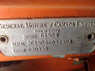

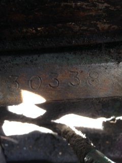

  14. photo 1.JPG photo 2.JPG i checked the numbers today and the number stamped on the engine matches the number on the truck info tag. the 261 has to be original. but now the question is how did it get in this truck?

    No mystery. I did a quick search for 1962 Chevrolet Truck Brochure and came up with The Old Car Manual Project, or something of the sort.
    They have a scan of the 1962 C10-C40 truck brochure where under the powertrain blurb it states that in 1962, for the first time, the 261 is available as an extra cost option in all Chevrolet light duty trucks.

    Looks like the factory put it there. Lucky eh?
