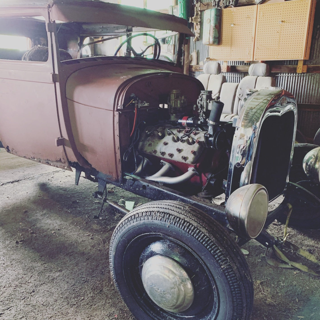

    7161A66D-3338-41CA-A332-7FF28D60BBCF.jpg looking from this angle I think it needs a drop axle More and more everyday. Not sure how much of one but needs it forsure. Have the brake parts head up this weekend so more progress and pics of that little adventure. I imagine it’s gonna be fun beating the old junk off and putting the new on.

  7. Reversing the spring eyes will lower it about inch or so, if it needs more a '33-'36 axle will drop the front another 1-1/2" or so.

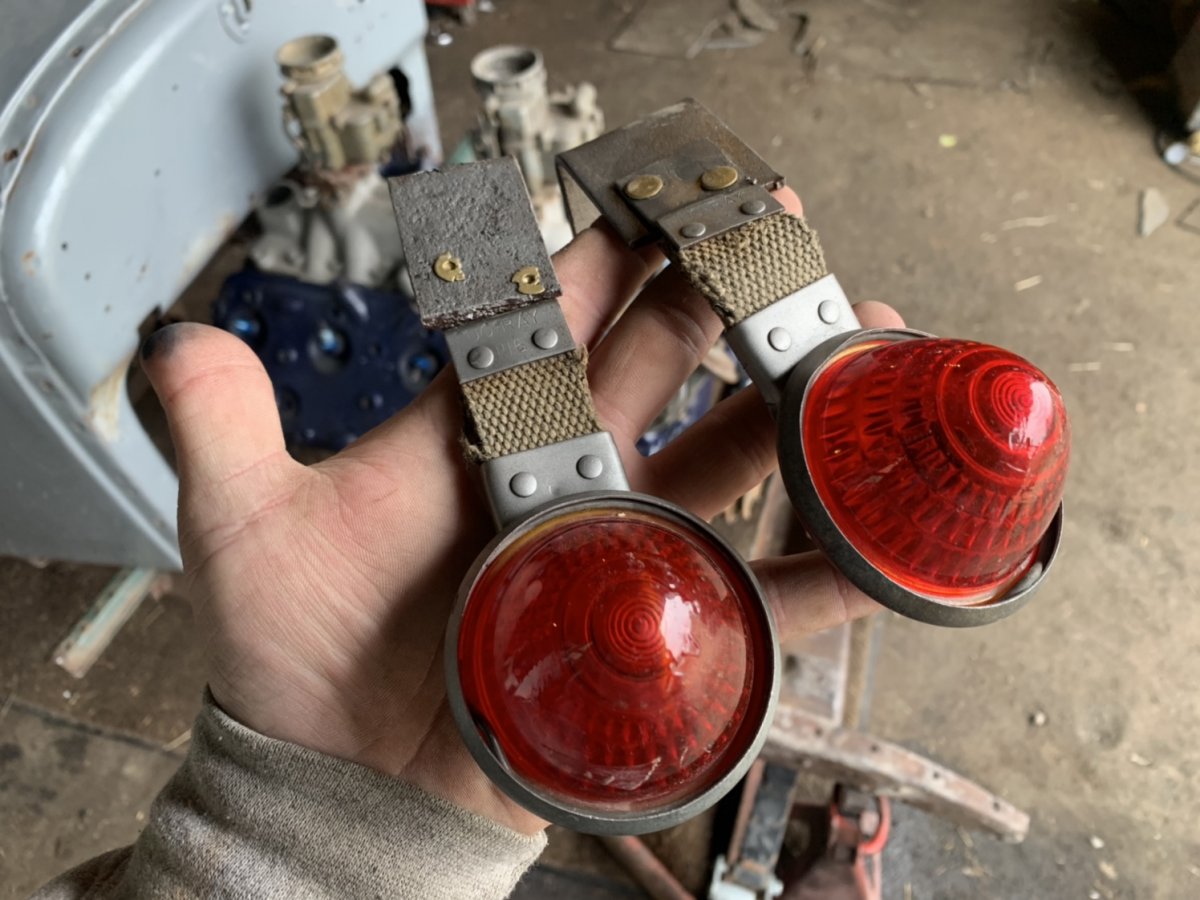

    IMG_0645.JPG IMG_0646.JPG well sand blasted my Doyle 1115 old tail light housings and trying to think of how to mount them. Maybe gonna use a nerf bar and hang them on each side of the rear plate.
    Stogy and modelacrazy like this.
  20. I can still remember when you could buy those at any parts store truck stop and some gas stations. When we used to pull everything from the front of a '57 Chevy but the lip around the grill hole we used to pull the gun sights from the hood and use those (amber or white) for turn signals in the holes where the gun sites used to be.
    Those are cool. I used to always have one or two of them hung off my rear end under the car.
    Stogy and Tim like this.

    Those lights are cool. How stiff is that fabric? Will they swing much?

    The fabric is kinda flimsy it will have to have some sort of solid mount don’t want them looking like bright red flags flowing in the wind!!!

    I wonder if there is some sort of liquid plastic or something that you could soak into the fabric to make it stiffer. Think when the you drop the dog leash and that fucker runs straight to the pond and goes for a swim. When the leash dries out it's stiffer for a little while lmao. Like that but more permanent haha. (Maybe that's just a me experience)
