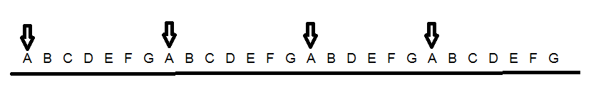

    OK, that helps. So basically, spread out your tacks to prevent heat build up. Then, go back over the panel. In attached image, do all A's then B's and so on...
  12. Pat Pryor
    Joined: May 28, 2007
    Posts: 1,877
    Pat Pryor
    Yep

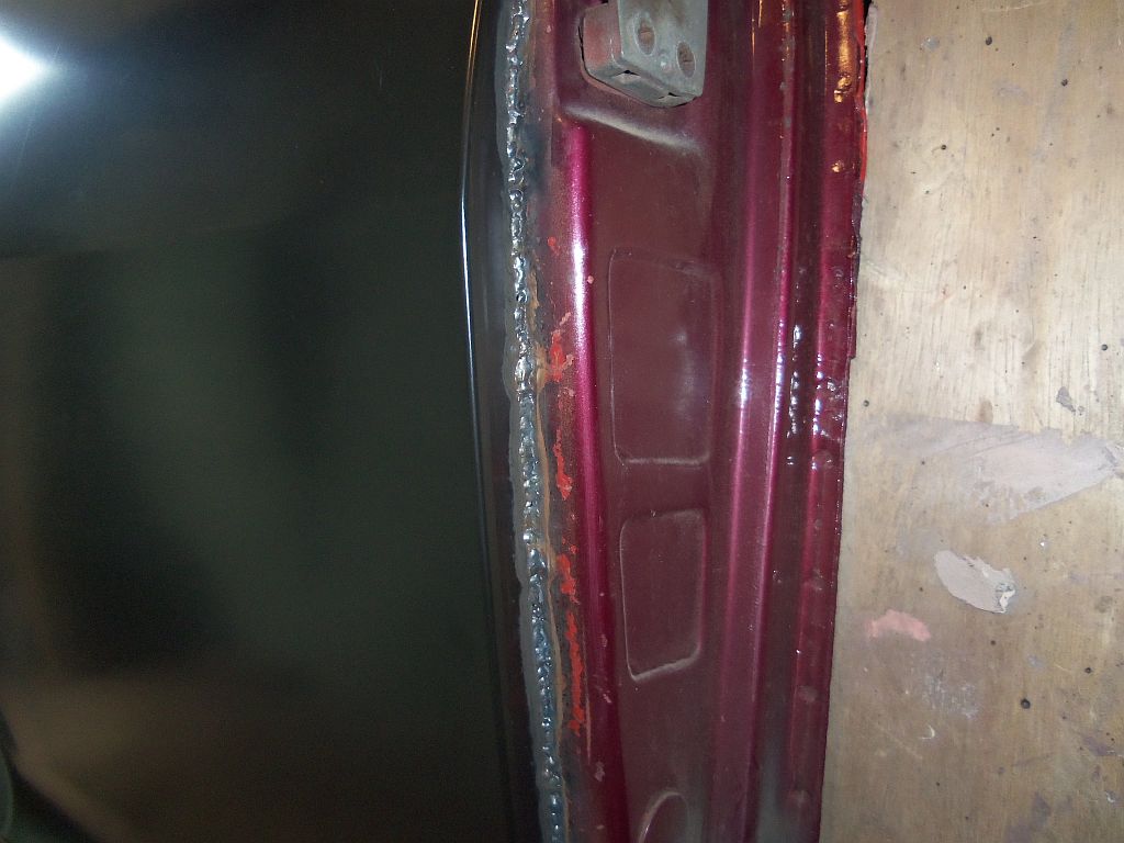

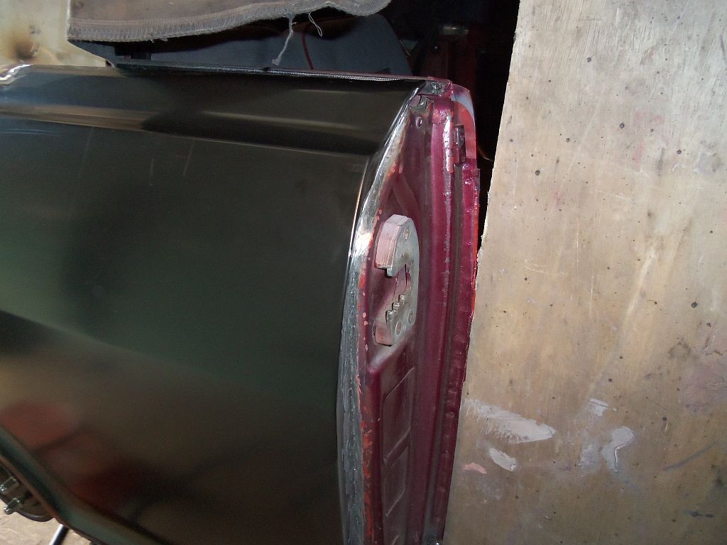

  27. Mig welding has such a bad rep and for what I am not sure......it is precise- it is strong.
    it will weld when the back side is dirty-rusty and contaminated with paint or even undercoating....whats to bitch about?
    turn the heat to the correct setting =get the gaps as good as ya can=and all is possible....we all cant have a tig and we really do not need one for patch panel repair.....
    I think the most common thing causing problems with Mig users is the small 110 underpowered machines and also using .023 wire results in gobbed up weld beads, a 1/2" tall.....
    Here is a picture of a simple example of how you can weld thin steel to thin steel[Taiwan replacement quarter panel] with controlled heat.....
    notice the seam is in a corner and I didn't even clean the paint off to start,but when it was done the paint is not burnt off even a 1/4",but it is securely welded together....try that with a Tig,or Oxyacetylene=even the black coating isn't burnt off....this was welded with my 220 Mig set on#2 heat and#3 wire speed[.030 wire]
    I did not run beads /just spots.......
    I did have to touch up a couple pinholes but its bodywork/not critical suspension parts....what else does one need on old car body repairs?

  28. ebfabman
    Joined: Mar 10, 2009
    Posts: 671
    ebfabman
    The OP was asking about butt welding with a mig.
  29. I thought that was what I just showed a 24" joint irregular butt joint welded with a mig..... you can post something yourself if it would show it better.........
