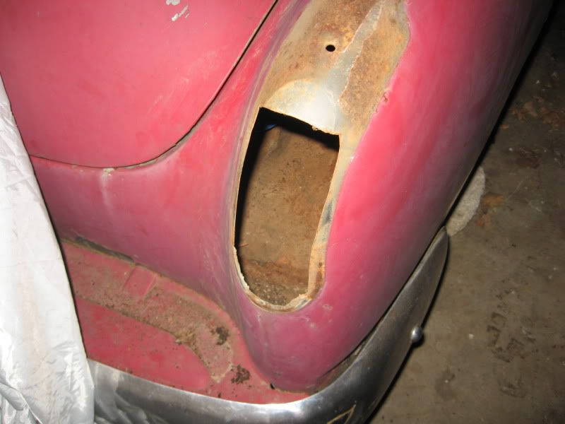

    I am going to try this on my 51 tail light repair kinda tricky area with an extreme curve.
