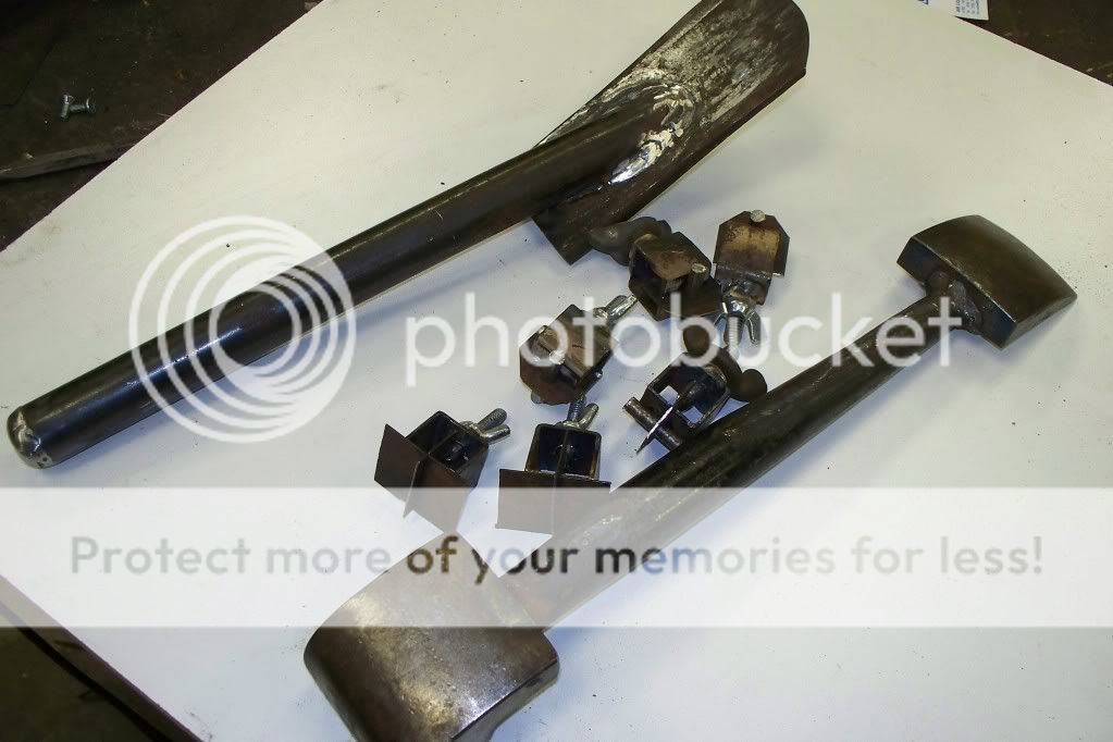

    bct
    i used wide steel strapping/banding like the stuff from a lift of 2x4s......
    you can see the bottom two that use a cut slot for a small piece of banding for the backer....they work well with anything with a compound curve....
