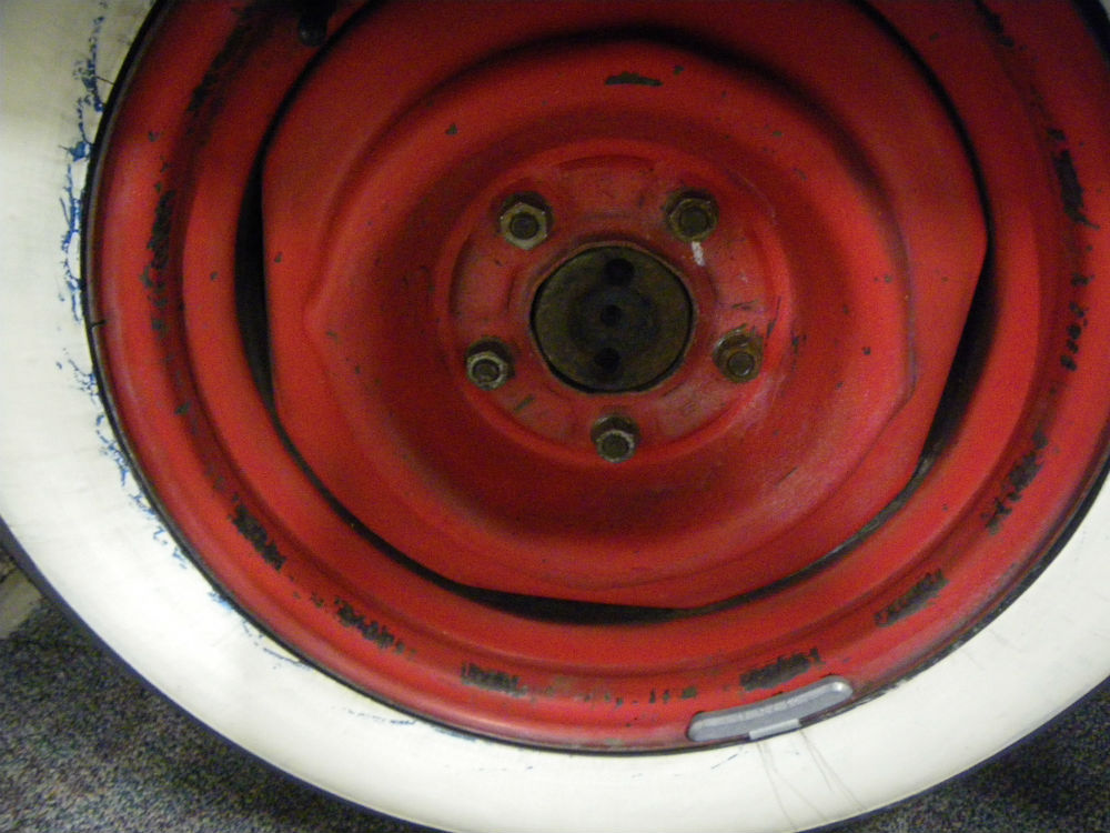

    This is one way I've used, to get around having to use spiders on hubcentric wheels, and saves you opening up the centre hole.. the flange is just wide enough to sit under the edge of the nut

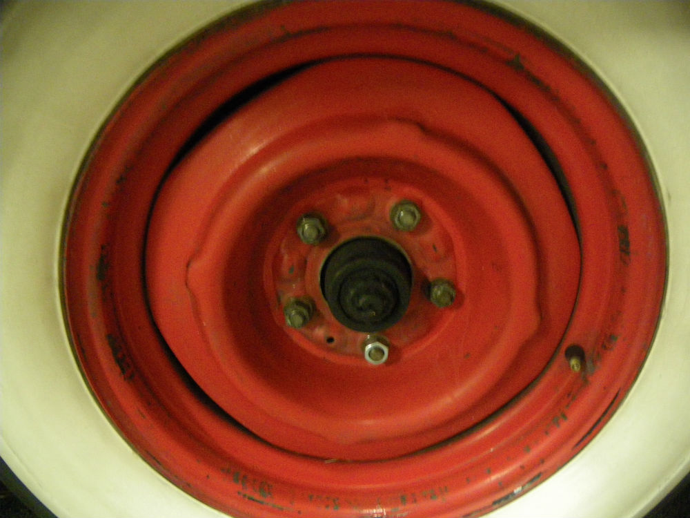

    That's an interesting trick for sure! Is it really that hard to grind the bore of the steel rim? For instance I measured 2.90" for the opening and saw some of yours are 70mm or 2.95 inches. My worry is the rear. I have a 57 chevy rear on my 53 chevy but not sure if would need to grind out the axle/drum as well. Also the bore/hole on my rear steel rims don't look perfectly circular. It seems I need to grind out the tabs.

    On my '54s wheels, the center opening is just about 2.75". To open it up enough for the caps to push through (3") I would have to grind the center holes lip completely off. The problem is keeping it perfectly round. You dont want the f-ing thing all wavy cause you'd be able to tell once the bullet went through. On the '57 rear, it looks like it's the same exact size as the front hub so it should take the same amount of grinding to fit
