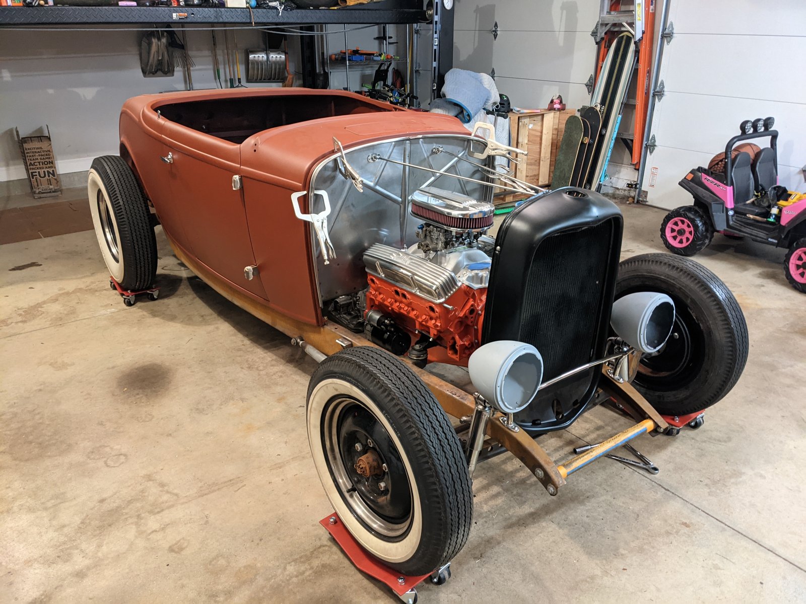

  4. SDS
    Joined: Apr 28, 2011
    Posts: 827
    SDS
    I'm hoping that this build thread will help me keep up my momentum.
    When I put the radiator and grill shell on the other night, boom! It started to look like a 32 Ford - That combined with the headlights really gives it a face.

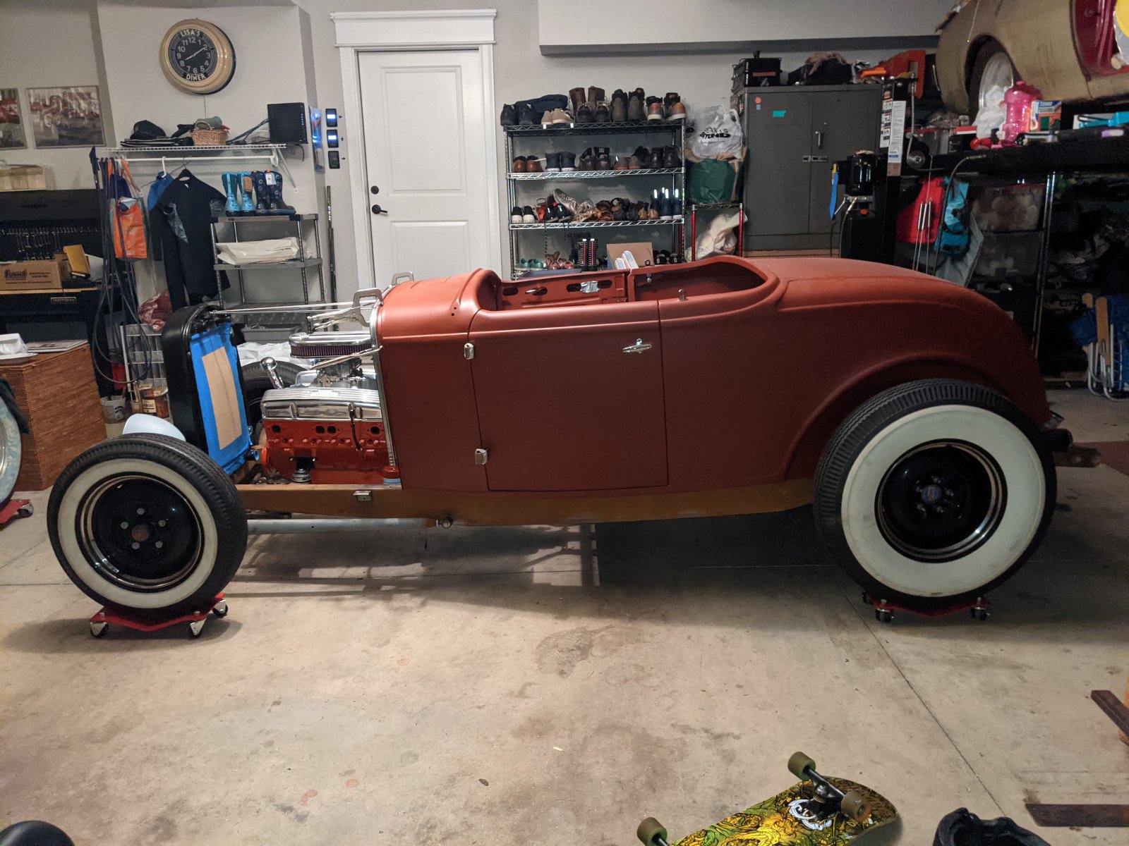

    I've debated on whether or not to leave it like that... The thing that I really don't like about it is the gap between the tail lights and the body. When I had the fiberglass body on there they were tucked up real nice under the tailpan.
    I think I'm going to go ahead and do some surgery on those rear frame rails to raise them up, along with the gas tank and spreader bar

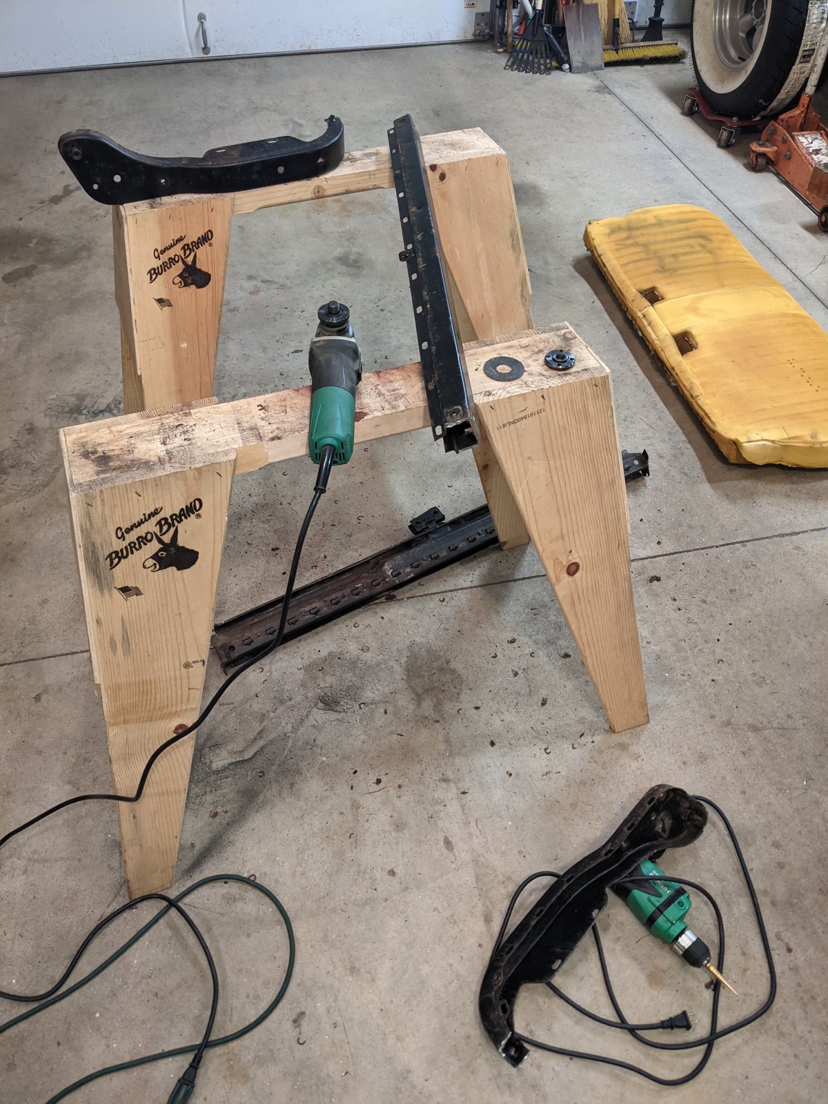

    So my son acted like a 10-year-old tonight and forgot his hockey jersey, so we turned around and came home. That gave me some time to work on the car tonight.

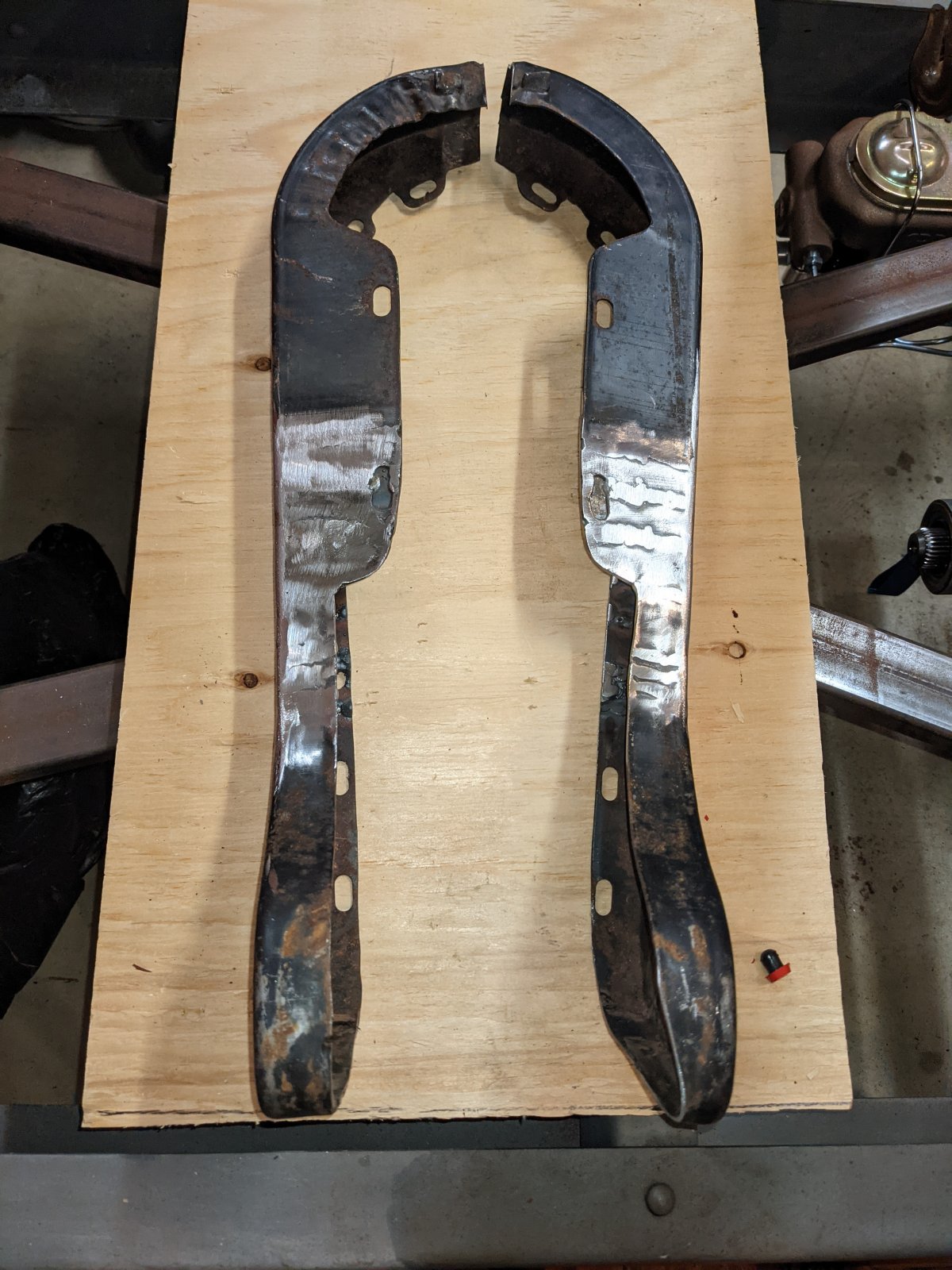

    I started whacking away on my junkyard purchased S10 seat. I'm following a dimensioned photo I found from Glide engineering as a guide. The seat is 46 and 3/4 in wide at its widest point, so I have to flatten, narrow and taper the sides of the seat bottom first. I cut the bottom frame apart pie cut the heck out of the bins to straighten them out. I'll straighten the other one tomorrow then PXL_20211015_002443745.jpg PXL_20211015_004707289.jpg PXL_20211015_011153024.jpg weld everything up.

    It’ll be a cool build! Glad you got the body mounted. I would for sure bring the tank closer to the body, it really isn’t much work to correct.

  18. SDS
    Posts: 827
    SDS
    PXL_20211015_150455619.jpg PXL_20211015_150514058.jpg Thank for all the kind words and encouragement from everyone!
    I got one side of the S10 seat all straightened out. It's nice to wack away at something that just needs to be straight and not have sharp edges (No need to consider how it looks)....

    Total time invested to this point including disassembly and fabrication - 3 hours.
    I think straightening these two end pieces is the most intensive part of the whole modification process.

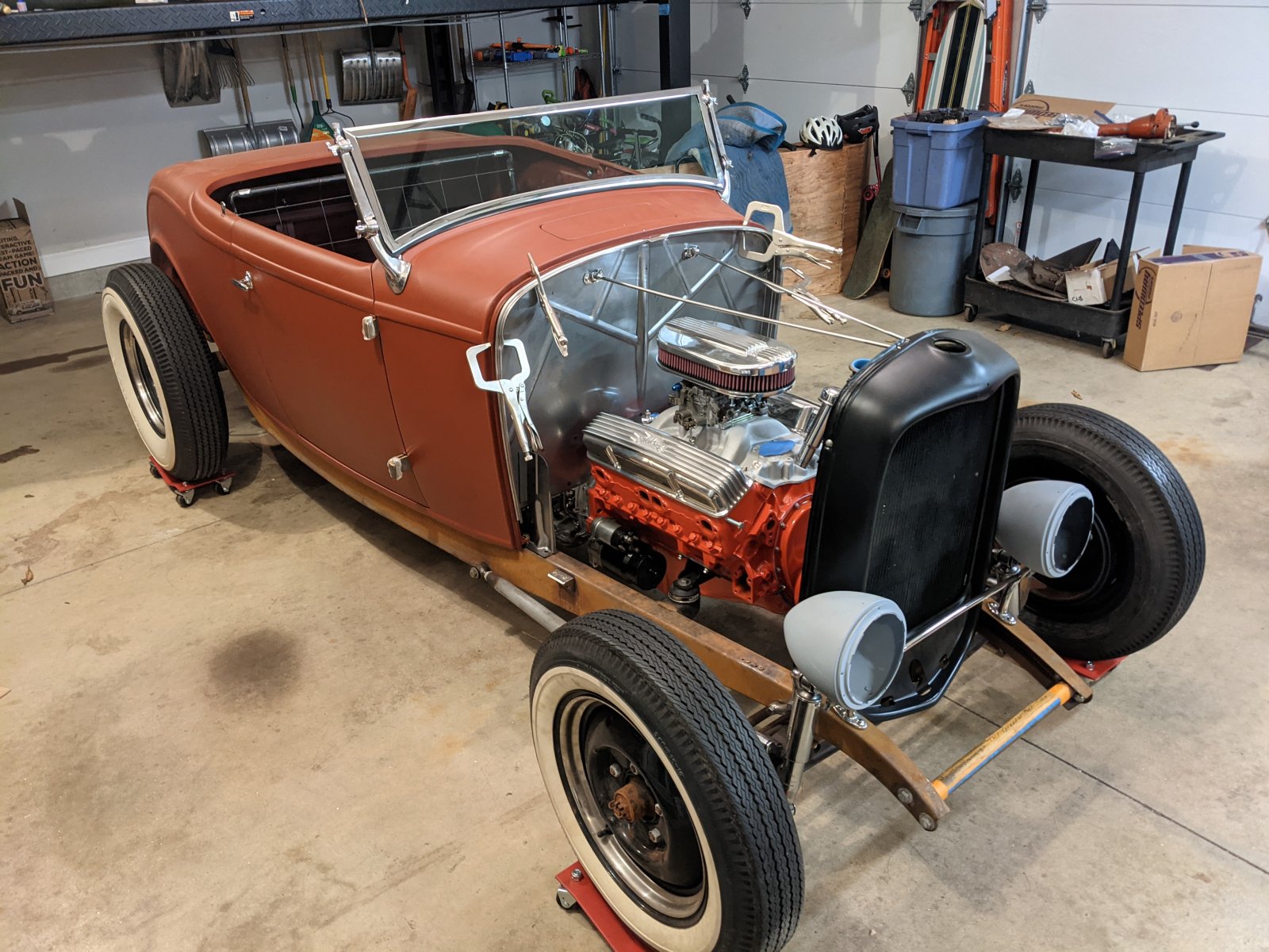

  20. SDS
    Posts: 827
    SDS

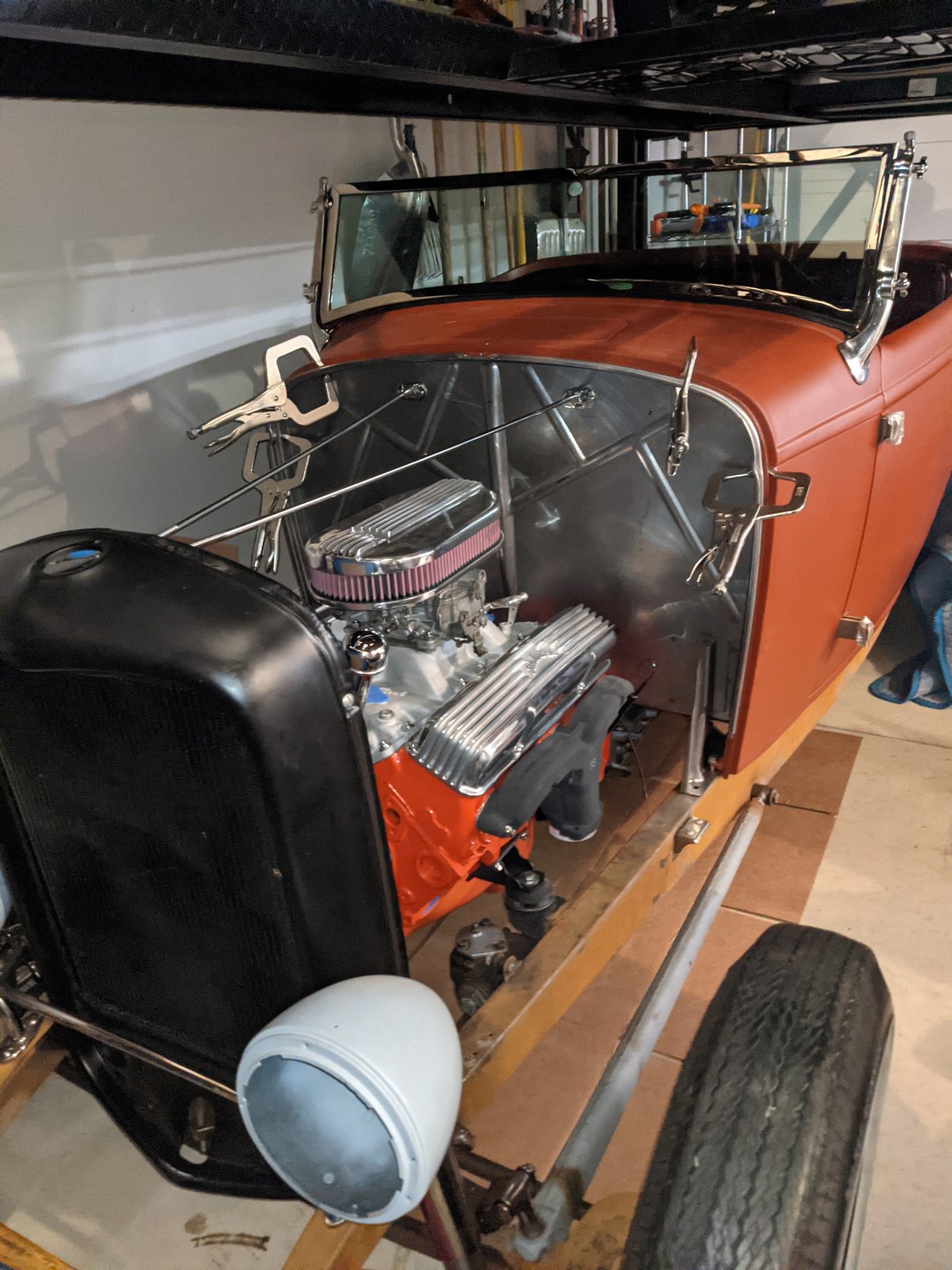

    God was watching over and I was able to get a used 2-inch windshield assembly for the car - A super cool guy on the HAMB sent me a message that he had one, so I went and picked it up yesterday.
    As soon as I got it on the car, my 10-year-old son says, "now it looks like a real car" :D
    PXL_20211016_225919434.jpg PXL_20211016_225846531.jpg PXL_20211016_225904585.jpg I'm planning on elongating the lower hole to lay the windshield back at least one inch, possibly two...

  22. Looking forward to seeing some pics when you lay that windshield back…makes ‘em look like they are going a hundred miles an hour sitting still!

  24. A Boner
    Joined: Dec 25, 2004
    Posts: 7,444
    A Boner
    Too vertical of a windshield on a Deuce sticks out like dog balls! Bravo, glad you are laying it back an inch or two.

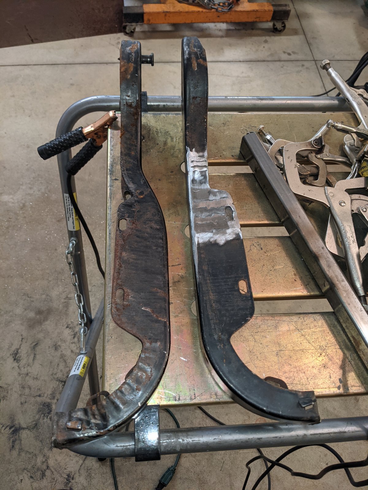

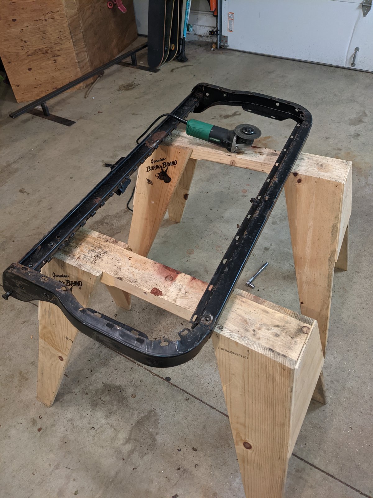

    Sorry for jumping ahead and not taking pictures step by step, But I got the S10 seat frame all done last night. After measuring measuring and a trial fitting, I decided not to go with the Glide engineering seat dimensions. I prefer the look of a square seat, like the one in this article
    https://garage.eastwood.com/eastwood-chatter/channeled-bench-seat-1/
    So I made the seat a little over 42" wide, top and bottom, front to back. I put the stock S10 seat tracks underneath. I have a little finish welding to do and I have to install the wires on the bottom told the phone, but it's almost done. Total cost of this- $65 (including foam and a seat cover to use as a pattern). The photo at the bottom is of the remnants.

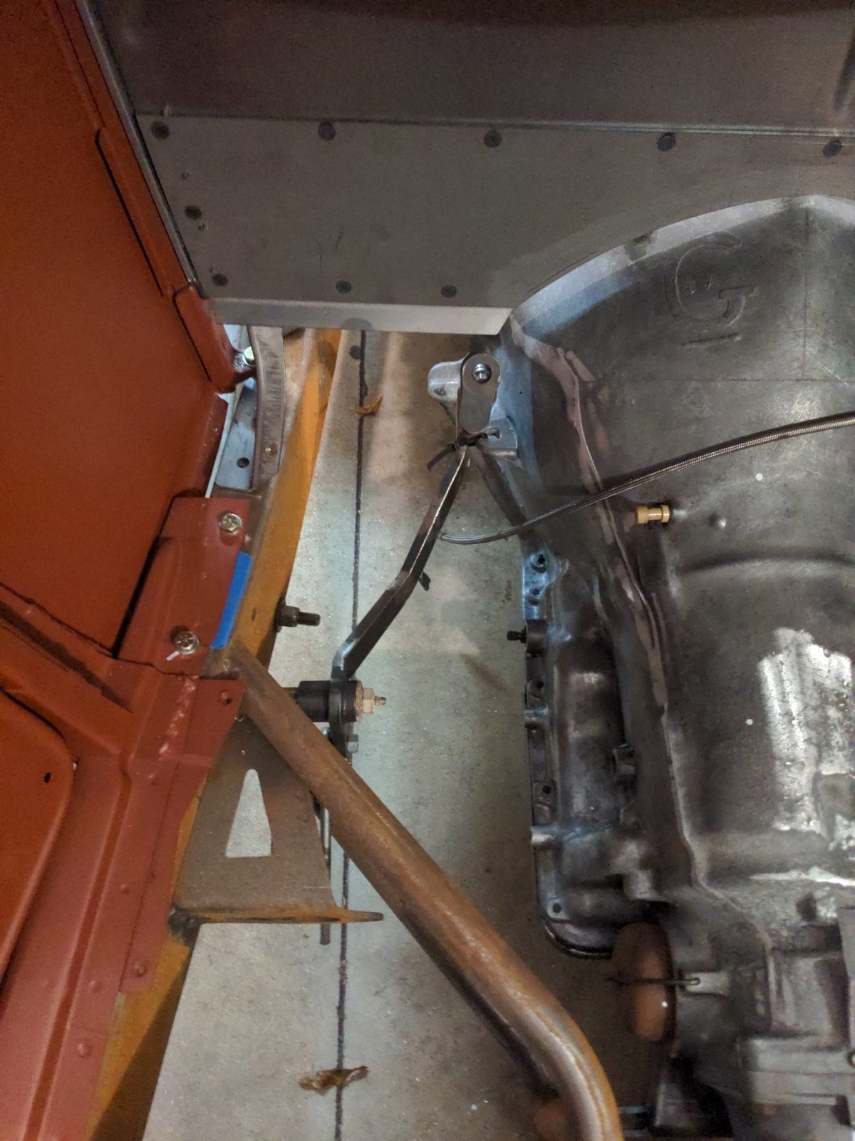

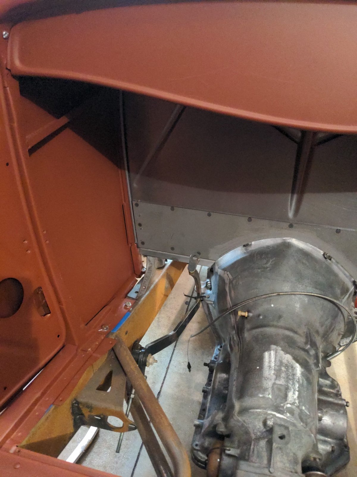

    SDS
    My son says it now looks like a car because we got a windshield :D

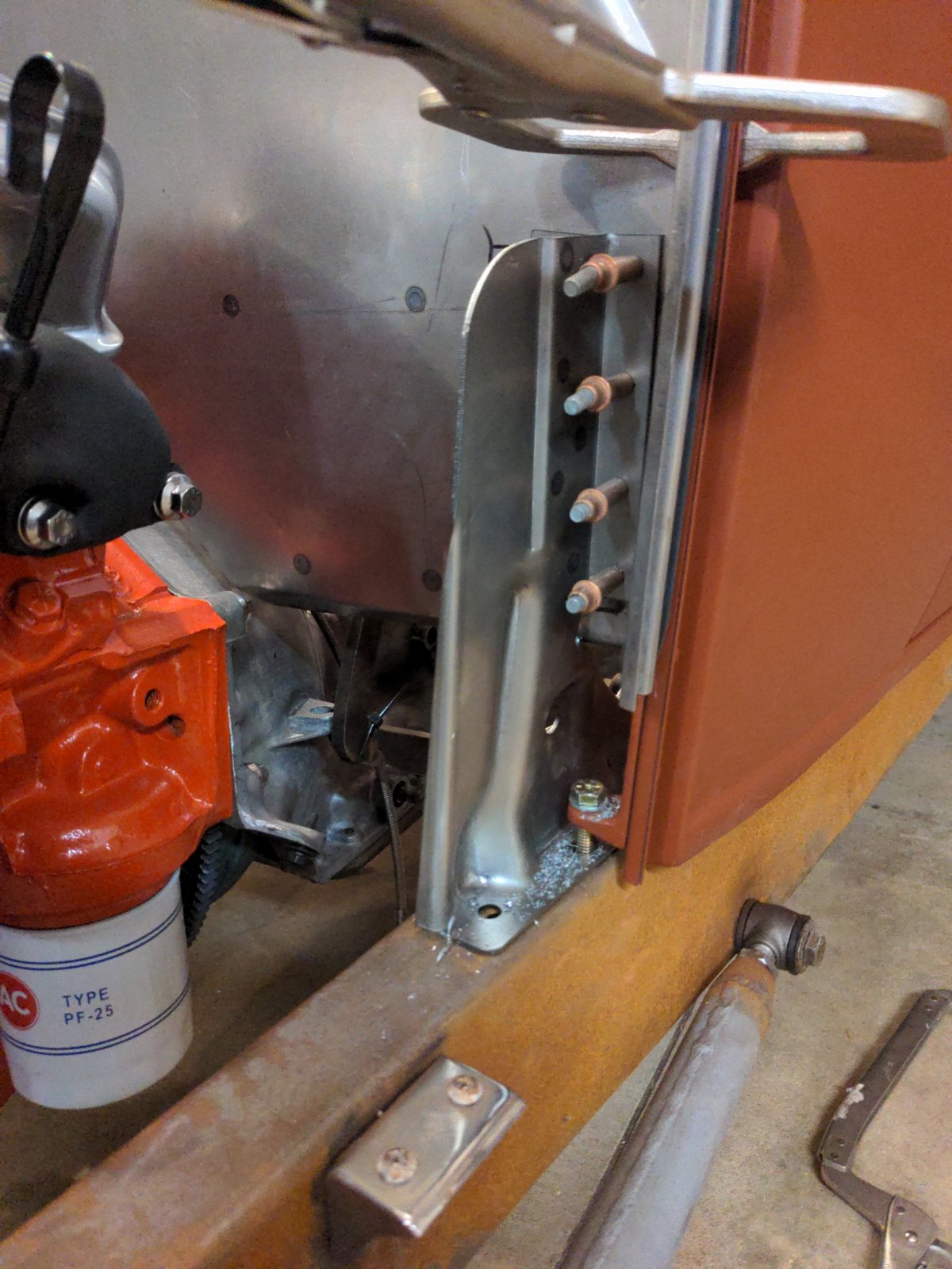

    I finally got those pesky cowl feet mounted yesterday and started working on the brake pedal placement...

  29. SDS
    Posts: 827
    SDS
    I got a steering column and a wheel... Getting ready to pull the firewall back out and figure out the placement.
    As I mentioned, I built a car on this chassis almost 20 years ago as a three-window coupe with a fiberglass body... To get that steering column and wheel in a nice spot, I had to jog (cut and paste) the brake pedal over to the right quite a bit to get it to be on the right hand side of the steering column.
    It looks like in this iteration (Brookville roadster steel roadster body), there's not going to be enough room to the right of the brake pedal for my gas pedal... Maybe I'll have to do some more modification to the brake pedal, or order a new one from Kiwi connection and start from scratch?
