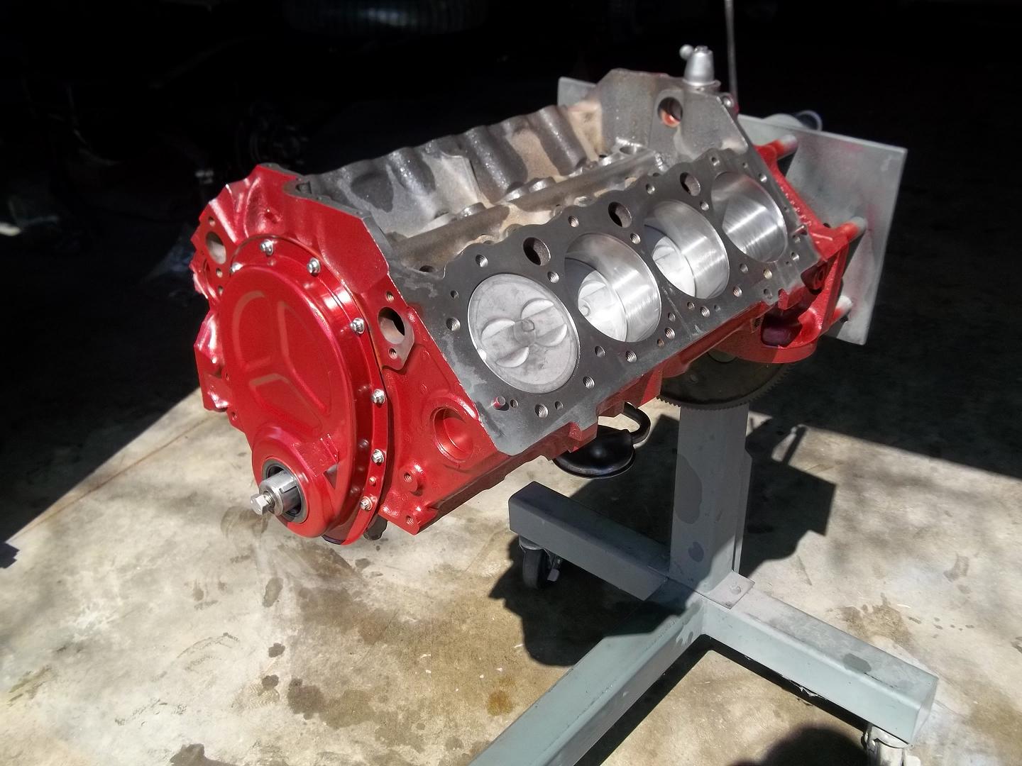

  6. Here's mine under construction. I've had the block, a NOS unit since '90. It came with pistons, rings and bearings. I installed a standard steel crank I had, an RV cam and power pack heads. Has all the power I need in the cabrio. Love these "little" engines. Tim
      254.8 KB
      372
    slammed likes this.

    That's a fine lookin unit ya got there timwhit, I remember when mine was in that stage, on the stand newly painted. I was 11. My brother was tireless in his R&D and buildup. Little did I know it was for me. Cool brother huh?
