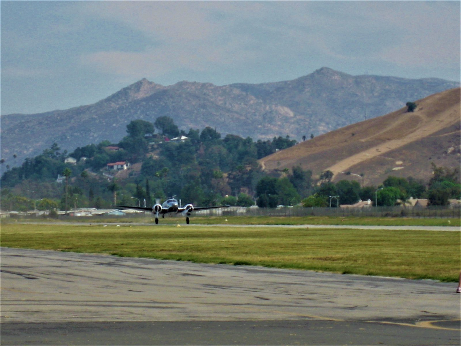

    That is going to be very cool. There is a lot of history there at FLABOB, its always been one of my favorite airstrips, and there are a lot of cool people there, that are into hot rods there as well.
    Thanks for the heads up about this upcoming event, I may have to break a personal rule about flying on commercial airliners, and just go for it to attend this event.
    Thanks from Dennis.

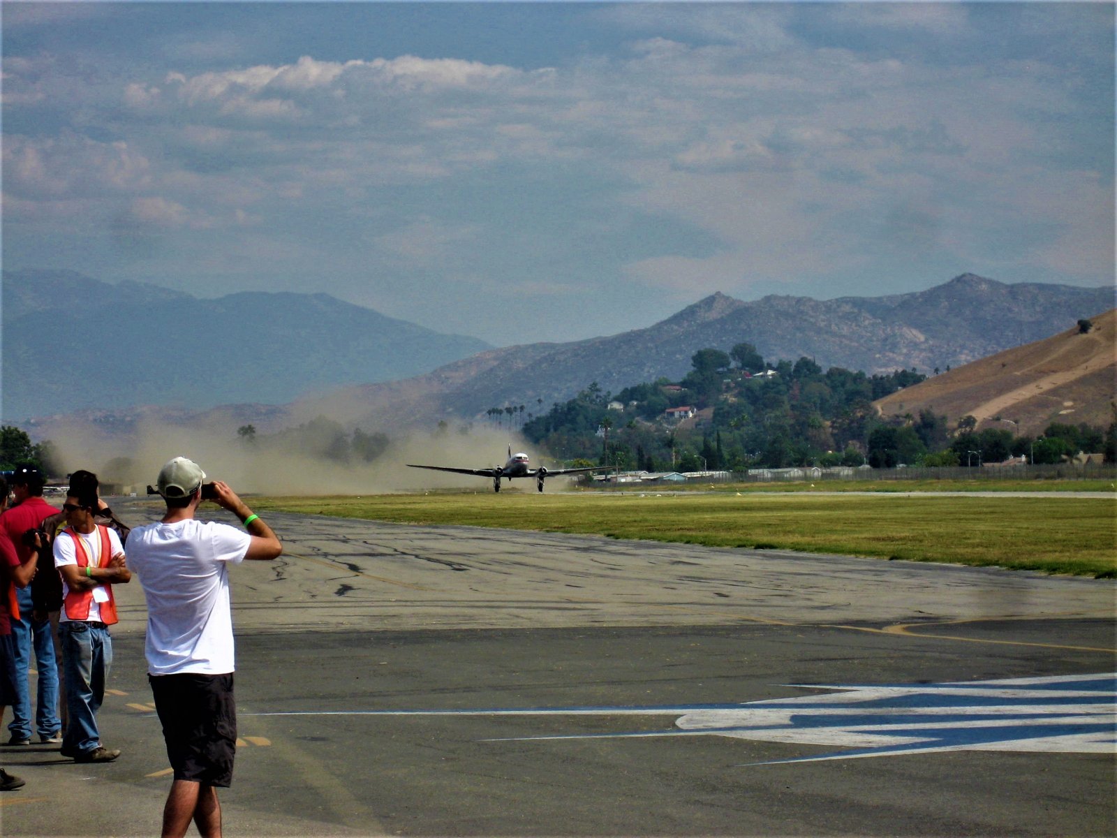

    These pictures are from FLABOB.
    IMG_1026 (2).JPG IMG_1024 (2).JPG DSC_1002 (3).JPG DSC_1004 (2).JPG DSC_1006 (2).JPG

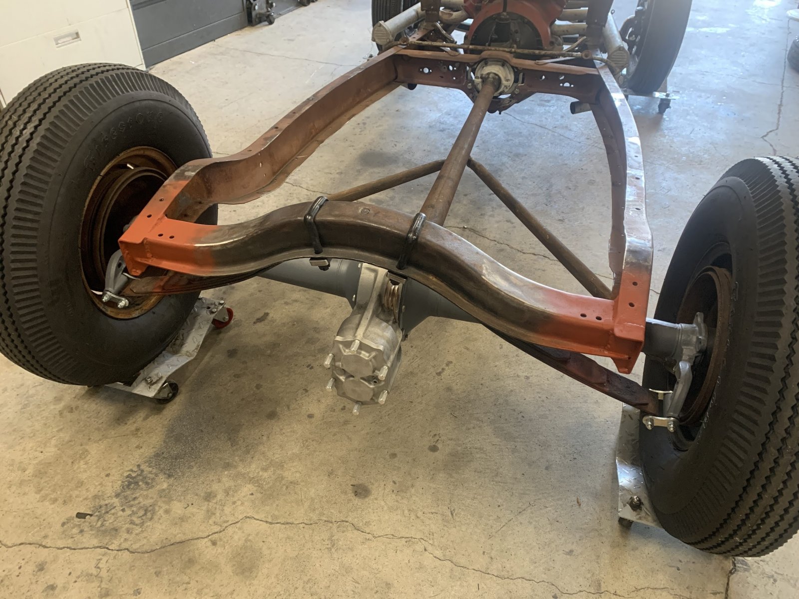

    I focused my attention on the rear crossmember, which was only tacked in place. Using one of the sturdiest periodical mailers of all time, I created templates for my mini reinforcement plates.
    When they were all cleaned up, David welded them into place.
    Having the rear crossmember sorted out means that I'll be able to cut the rear frame horns next time I'm there. Can't wait!

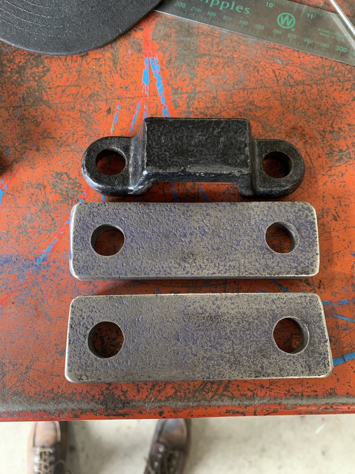

    While I chipped away at the frame plates, David built a pair of rear U-bolt clamps out of some very old steel.
    Since we added the spacer springs to the rear leaf pack, the stock clamps no longer work. These will do the trick.

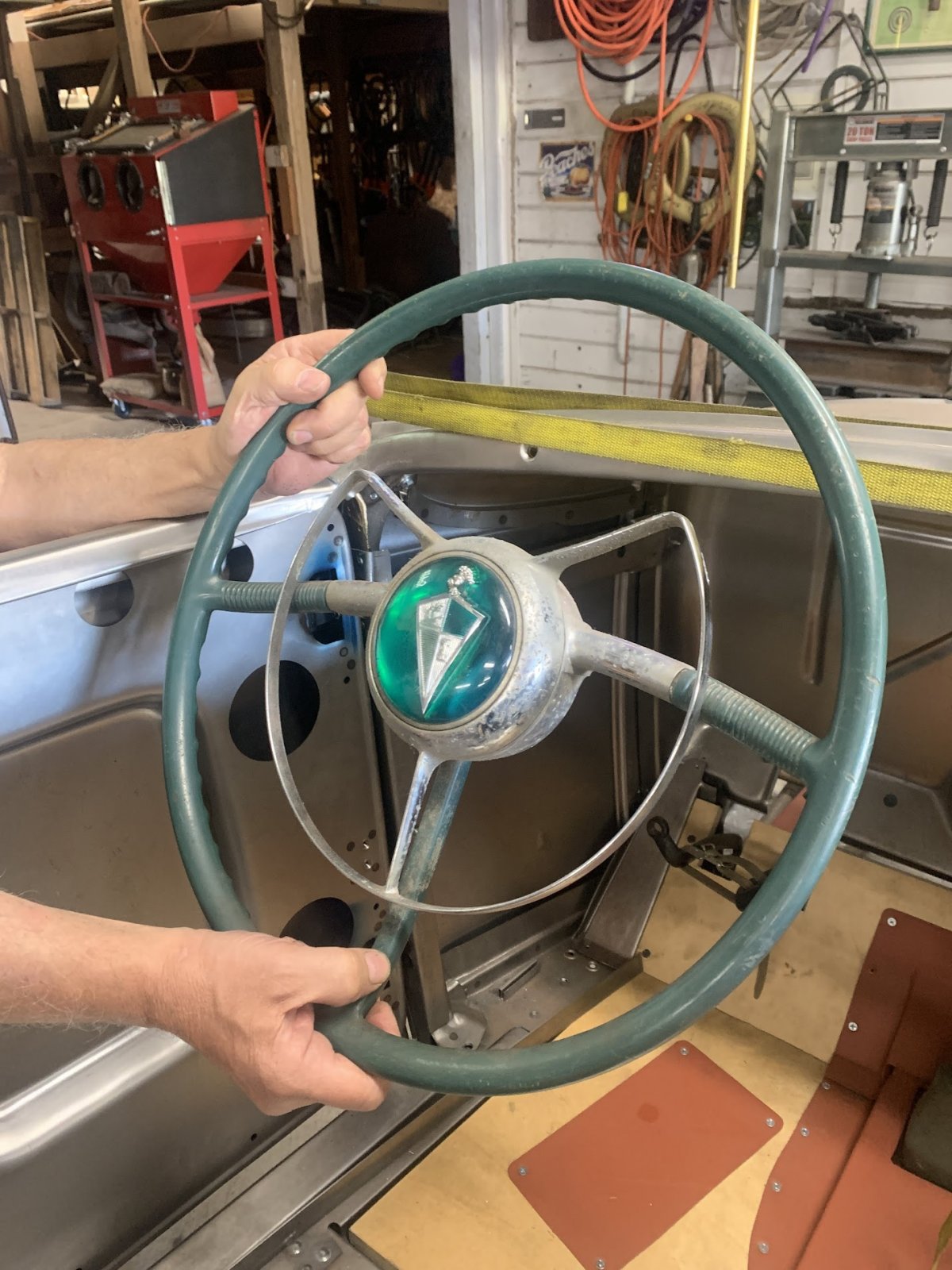

    Right before cleaning up for the day, I was able to break out my new, original King Bees from @nickthebandit. As I'm sure many of you know, Nick is a real-deal hot rodder who lived in San Francisco in the 1950s. IMG_6212-1.jpg
    I still remember how exciting it was to mock up headlights on Version 1.0 of the roadster. The same applies for Version 2.0!
    Now I need to find some tags. Building a headlight bar is going to be so much fun.

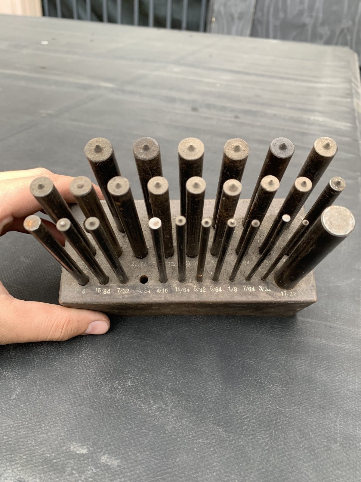

    Tools of the Trade
    When David was making the U-bolt clamps, he was using center punches like these. He asked if I had ever worked with them and if I had my own set. The answer to both was no. Moments later, he walked over with these and gave them to me. They originally belonged to Bruce Gordon. What an honor!
    Is the pen mightier than the sword? In this case, maybe, because I now have a custom di Falco Fabrications Sharpie to cross more items off the roadster list!

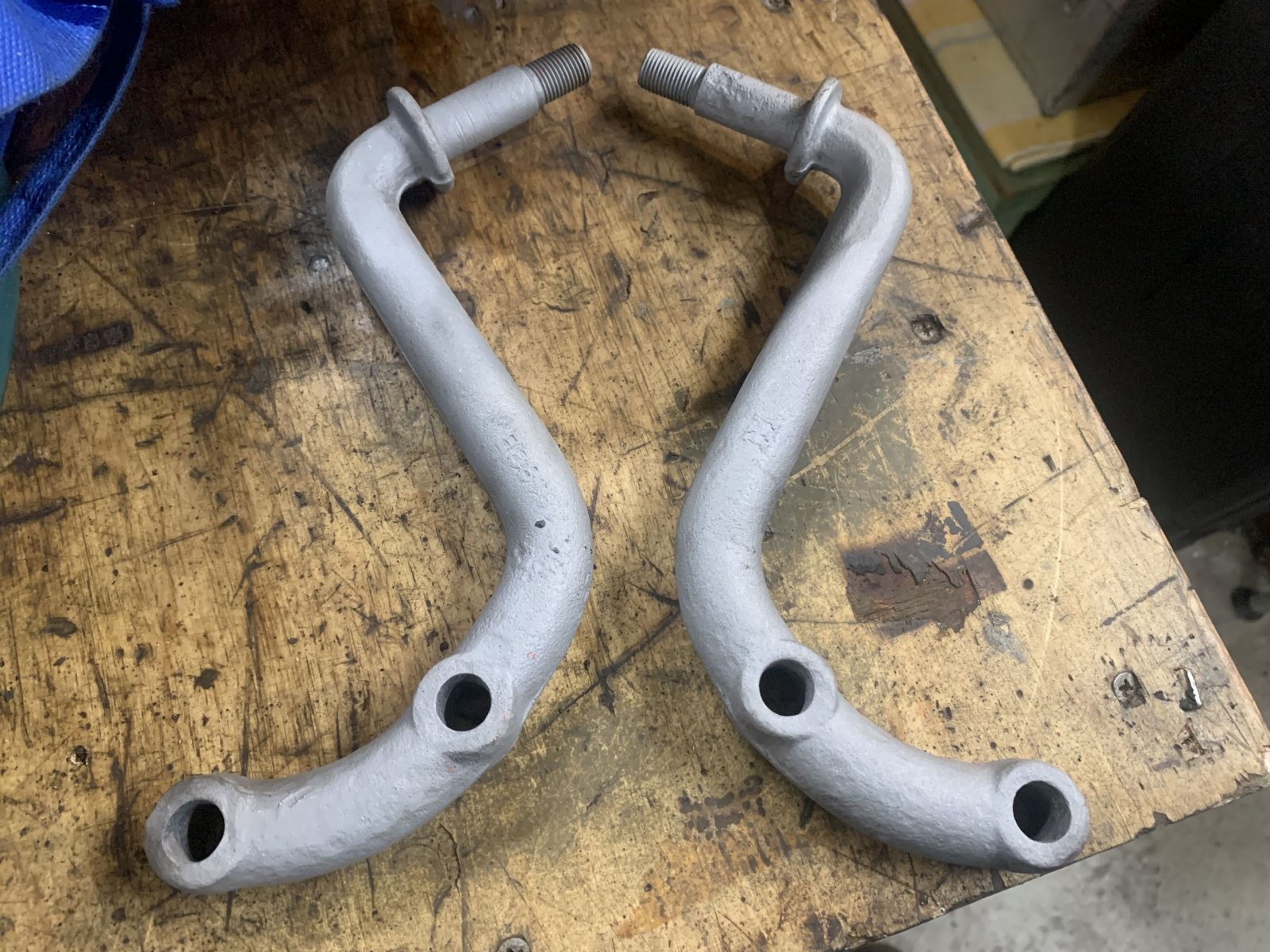

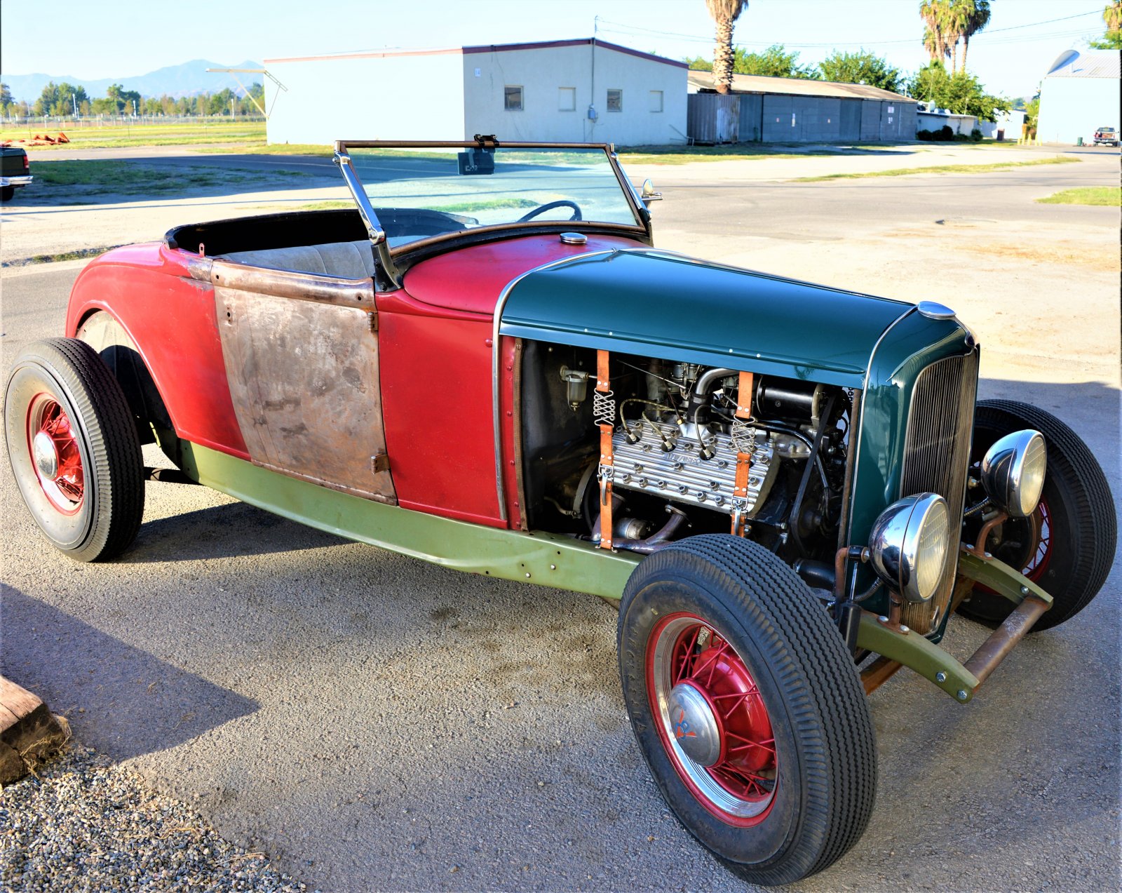

  15. Just a note. But if you flip the hairpin steering arm and have the tie rod come up from below, they are in about the same spot, as if you heated and dropped it and have it come in from the top. The reason I mention this, is that I have seen a significant amount of early hot rods with it done that way. While I won't say that heated and bent wasn't done. It certainly was. I think it was a slightly later addition to the "play book". Regardless. Heating and bending it makes it match the axle. Which is certainly more attractive. Especially on an open wheel car.
    Stogy, warbird1, Six Ball and 3 others like this.

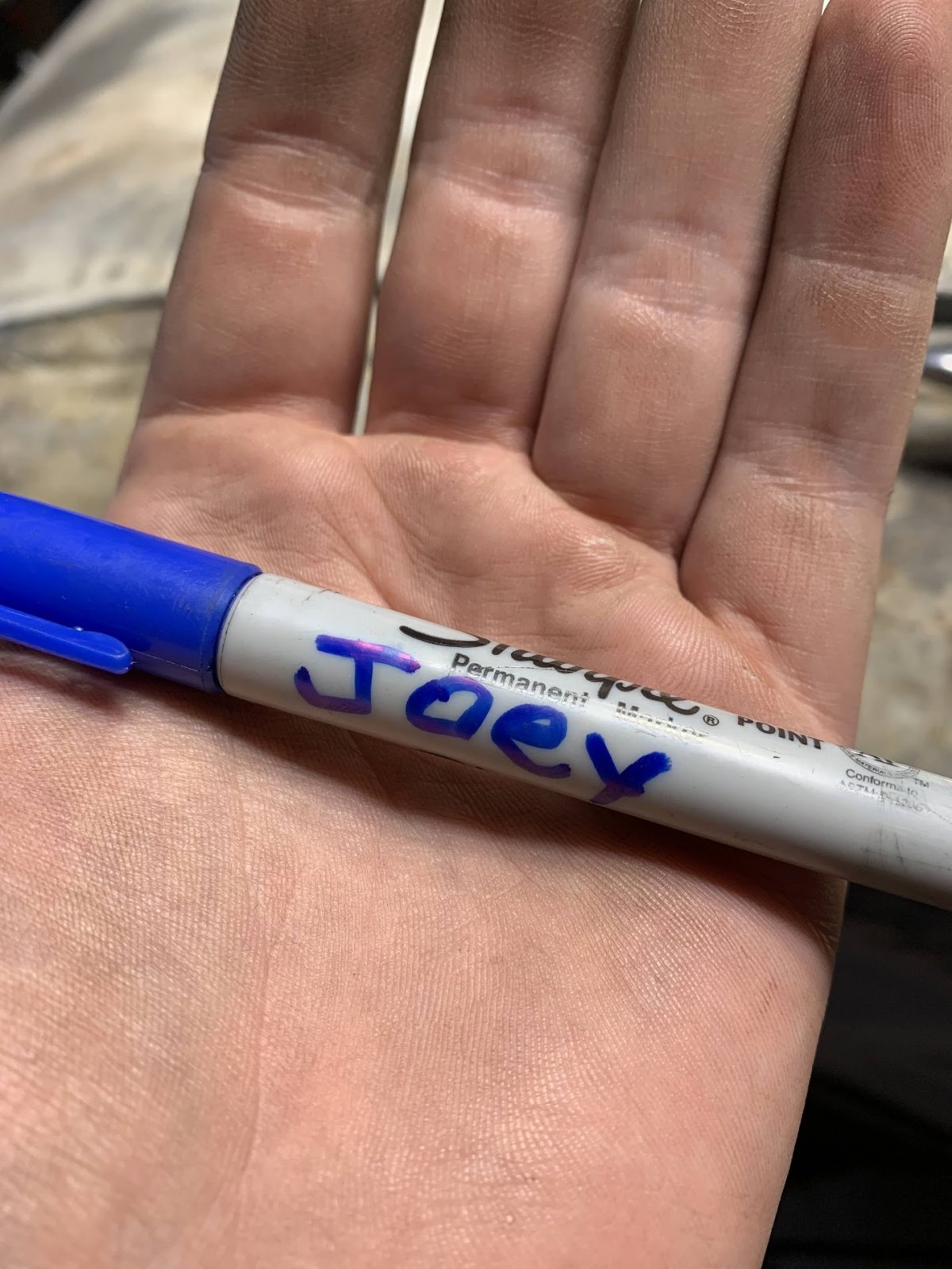

    The most lost item in my shop, the Sharpie! I now have dedicated holders for them in specific sites in the shop, and yet they still run off and hide!
    rpm56, Stogy, Atwater Mike and 2 others like this.

    Man those lights are perfect! My favorite for sure :)
    when you pop the retaining ring off if you find some fabric in there I’ve found quite a few like that and have gathered that it was factory to keep it all tight to the bulb. Conversely if your bulb is lose maybe add some “shim” to it.

    If David wrote your name on that without using another Sharpie he is more skilled than I thought. :eek:

    Thank you! Day by day, this thing is getting closer and closer to becoming a car. I often ask myself, "When was the last time these parts were on the road?"
    Great info! We plan to drop the hairpin to match. I think it'll have a nice, less-reproduction look.
    Hahaha that's so true. We're trying to keep them all in order.
    I've always loved King Bees. I actually put in the NOS Wagner bulbs. Great tip about the fabric.
    He's a magician with this stuff.

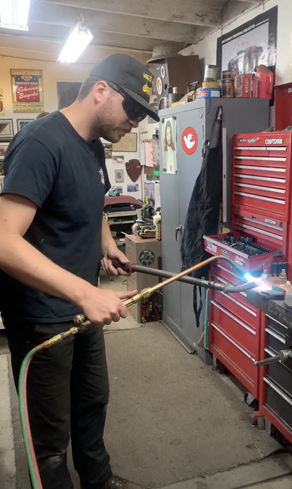

    IMG_7019.jpg Initially, I planned to combine the shock mounts and the headlight bar. The more I thought about it, the more I realized that it would be best to make them two separate entities. That meant it was time to get to work on the F-1 shock mounts. As you can see, they were pretty crusty to start with.
    After cleaning them up, we put them in David's trusty fixture that he built while working at Vern Tardel's.
    Next up, heavy heat with the O/A torch. David handled one side.
    "If you don't apply the heat correctly, the metal will take on the consistency of dry Play-Dough," David said.

    I gave it my all. I heated the bending point until it was bright orange, then I used the homemade breaker bar to slowly bend it to shape on the fixture.
    With a little sandblasting, they turned out excellent!
