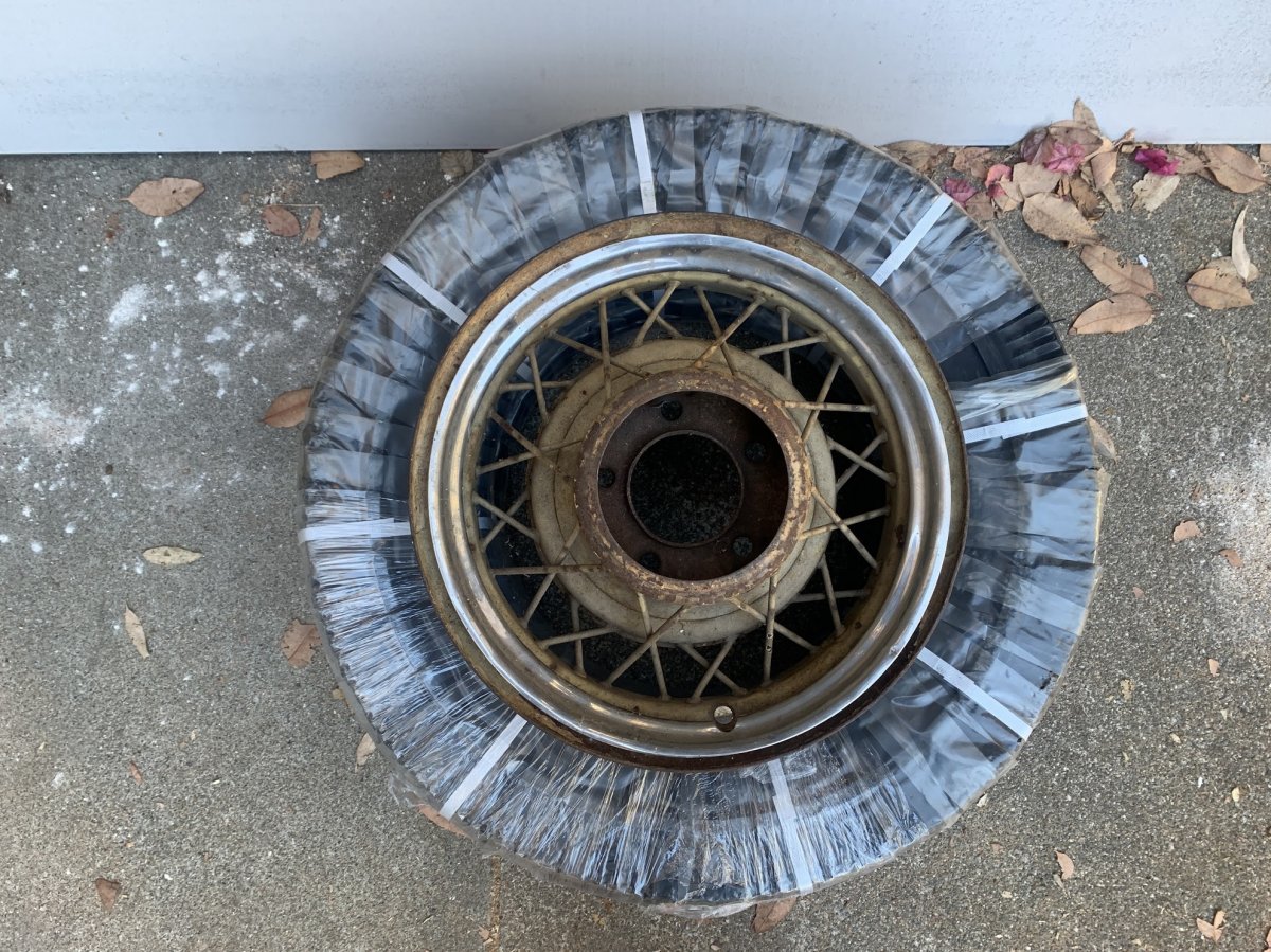

    just got a lesson in tire mounting... those new tires wrapped in plastic won't open enough to make an air seal when mounting them tubeless... so put a tube in it without a rim, pump it up big and let it set for a few days... tube on the shelf, waiting on a 165 75R 15"...'51 ford car rim...

    Good info for sure. I talked to the tire shop who have been working with hot rods since the 1960s and they recommended tubes and rim strips for them. I'm taking that route.

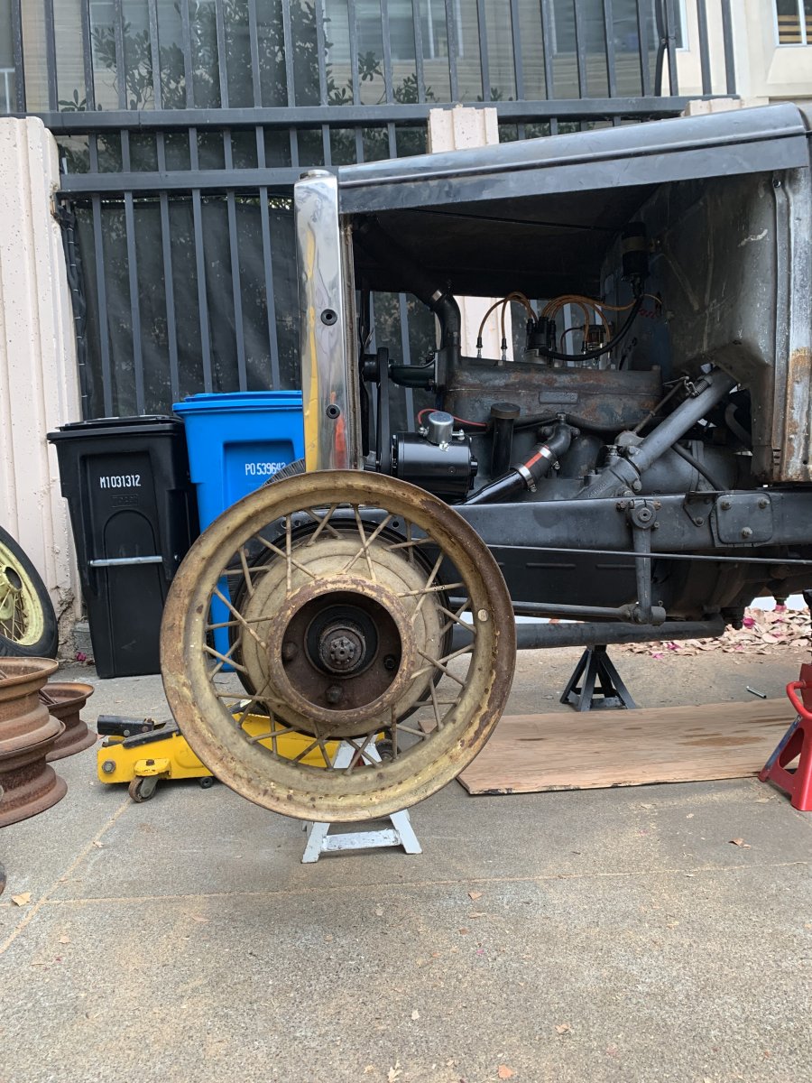

    Yesterday was a full and very fun day. On Friday night, I could hardly sleep because I was so excited to wake up early and work on my car. Does that ever happen to you guys?
    First and foremost, I rolled it out of the garage and fired it up. It started easily and sounded good. Next, I got everything in position to test all five '35 Ford wire wheels for runout. Safety measures included a swept driveway, jack stands (4x), wheel chocks, jack in position under the axle and two friends nearby. Before working, I leaned on it pretty hard and it did not budge. With that sorted out, I proceeded.

    The verdict on the wheels? Out of the five, three seemed to be good according to my primitive measuring system. One appeared to be okay-ish and one was bad. Interestingly enough, the worst one was one of the original paint ones. That's just the way it goes.

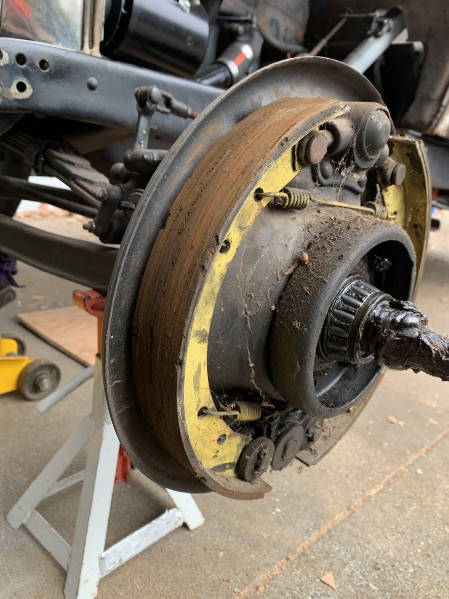

    So do I have a full set? Hard to say. I'm going to go down to Andy's Tires and Wheels in South San Francisco on Monday morning. They handle all the rolling stock for Roy Brizio's builds and they know their stuff. I'm really hoping that I'll be able to use them. If not, I'm back on the hunt.

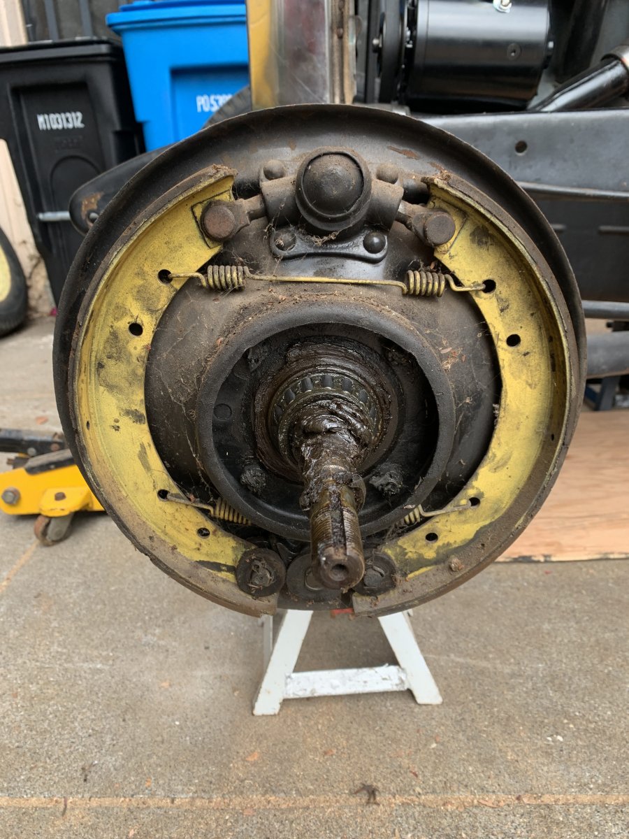

    With the wheel off, I decided to take a look at the brakes just for fun. It's no surprise, but they've seen better days. I was surprised to see yellow shoes. Were these stock or an early aftermarket replacement? Either way, it became immediately clear why the braking left a bit to be desired.

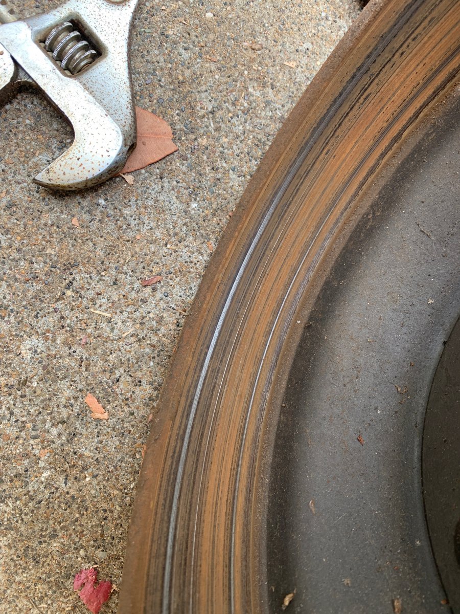

    Once I get the wheel situation sorted, I'll clean and sand everything. I'll mic the drums to see if they're within spec, and then I think I'm going to buy new brake shoes all around.

    1. Northwest HAMBers
    @J.Ukrop Those appear to be aftermarket "bonded" brake linings. The original ones are a woven, riveted type. The bonded material is too hard and doesn't work as well. (too much pedal effort) Check out a Model A vendor such as Brattons or, closer yet, Sacramento Vintage. They can help out.

    When you say bad, how bad? How far off was each?

    Three seemed to be within 1/8th of an inch as measured by the lip and have no major wobble. The inner portions seemed straight and true. One has a slightly wavy lip and the last one seemed pretty lopsided. Like 1/4-inch or more. I’ve only done this with motorcycle wheels so this is pretty new to me. As mentioned earlier, these will be installed with tubes.

  27. Sometimes that wavy lip can be improved with a tire iron and a hammer.

    Put the best ones on the front. As has been said rims can be straightened - to a point. Love your build!
