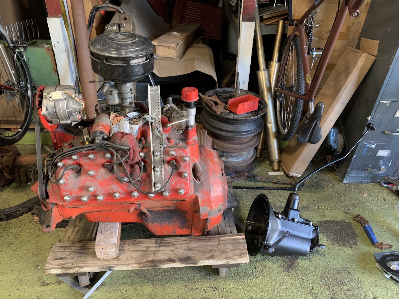

    Well, even though it's the middle of the week, I have some catching up to do from this weekend's fun.
    First, I was able to put the engine and the transmission next to each other. We were hoping to mock up the motor mounts, but my rear bearing retainer didn't show up at my house until later that afternoon. That'll be a project for next week.
    Also, after further inspection, we decided that a double-detent shifter would be the right move. Does anyone have one that they would be willing to part with?

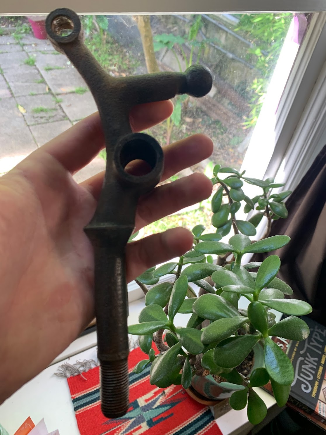

    IMG_9969.jpg I was able to fully disassemble the steering box. We'll clean and inspect the components next time so then I'll know what pieces to buy.

    What year gears are in that box Joey???

    Ah,er, um..... I am pretty sure the car still has a banger at the moment! H 10s won't work there! And if the gearbox doesn't have a double detent top on it , it probably doesn't have the large diameter shifter forks and synchroniser hubs . The later parts all must go together! You can fir the early forks to the later shifter top, but be careful that the parts all match.
    Mac Van Pelt has drawings , books parts and good advice
    http://www.vanpeltsales.com/FH_web/flathead_transID_3speed-shifter.htm
    http://www.vanpeltsales.com/FH_web/flathead_transID_3speed.htm

    The 39’ double detent shifters came with both the narrow and wide shift forks so always check what you actually have. Must have been a transition year. But yes make sure your forks are correct for the guts you’re using inside the trans.
    ~I also realize joey’s guru helping him will tell him of such things but it’s good info to have out there and it got brought up

    Thanks Tim. Didn't know they came with both sizes.

    These are plugs for the current 'banger. Every resource I could find recommended the W18s for my driving application.
    So the story on the trans is that its an early style case with later internals. I'm going to try to find a double-detent top with the correct corresponding shifter forks. I'm very quickly realizing that just because it was rebuilt and a good deal doesn't make it the right trans right out of the box. That being said, I am learning!

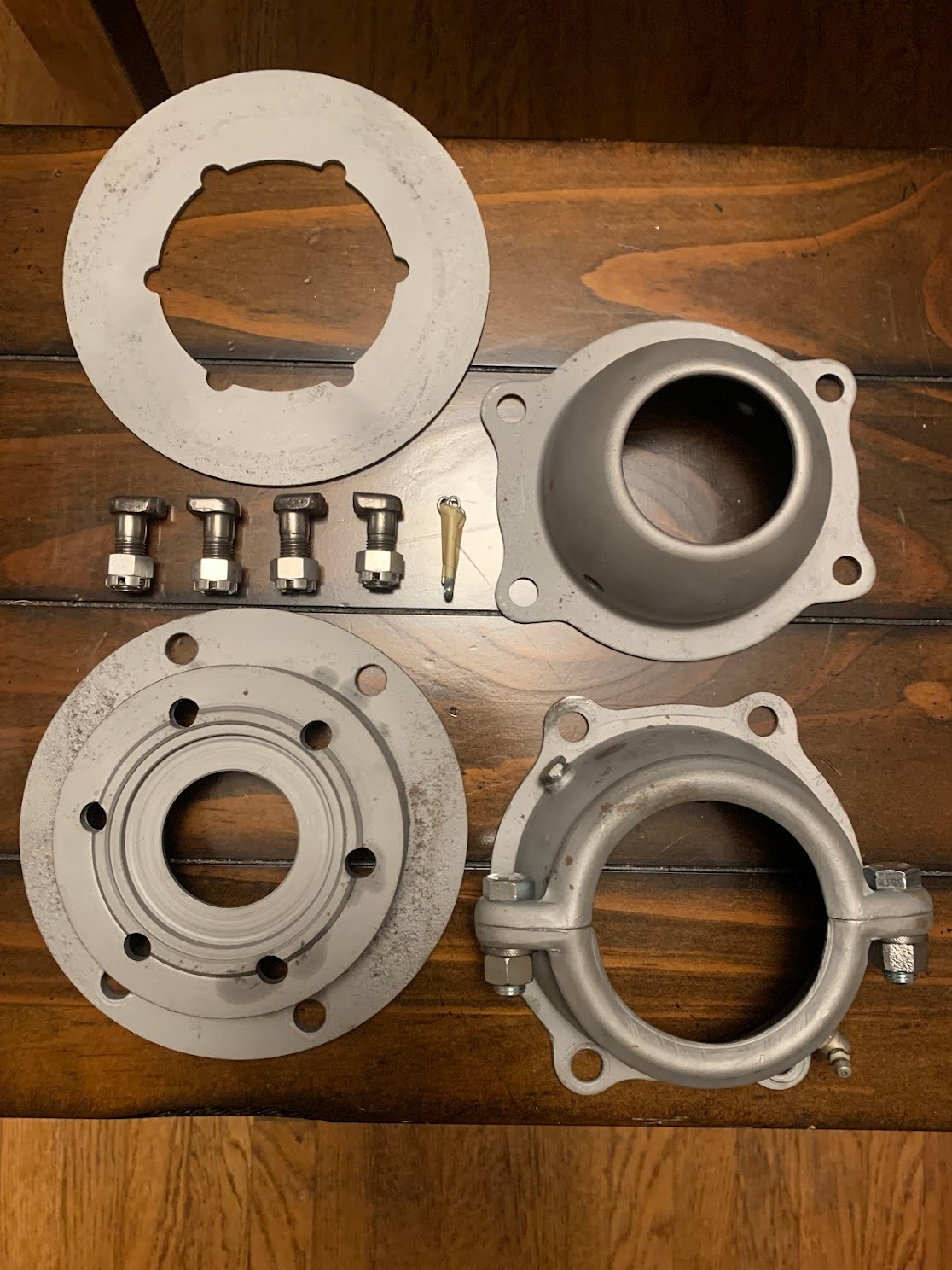

    So, where did we leave off? I’ve spent the past few weeks gathering parts—lots and lots of parts. Now that I’m actively building Version 2.0, it’s finally hit me how many little pieces I need to turn this thing into a functional vehicle. I’m chipping away at my list, but I still have a long way to go.
    Just like with Version 1.0, I need to remember that the best way forward is to take small steps one day at a time. Whether it’s ordering a part, painting an assembly or bolting two pieces together, every little thing helps.
    Last Saturday morning, I made my way up north to di Falco Fabrications. The sun was out, the air was warm, and I was ready to make some progress. My assignment? Prep and install the rear bearing retainer.
    First, I removed the 1934 bearing retainer and scraped away the old gasket.
    You’ll note that I painted it white. I suppose now is as good of a time as ever to let you know that I will be painting the driveline and suspension white with black accents on Version 2.0. For as long as I can remember, I’ve been drawn to the look. Will it get dirty? Yes. Very much so. But that’s okay by me.
    Back when I was in school, my brother had a 1960s Harley that was red with white flames reminiscent of Earl Bruce’s Mercedes. The bike sported a white seat and a matching kicker pedal and shift rubber. After years of year-round use, it all aged together perfectly. No, my car won’t have flames, but I’m hoping the white components will do the same.
    Anyways, with the parts painted, I bolted everything together for mockup. I’m still waiting on my six rear bolts with safety wire. Once the trans is painted, I’ll install the gasket and get it ready to go.

    The forks you have should fit the double detent top when you find one...its the other end of the fork that is different...where they fit on the synchro hubs....that being said the top you have should shift the gears....just change it when a double detent top turns up.
    Any working flathead trans is the right one....its not a huge job to change at a later date.....you will get good and quick changing them after a few years.

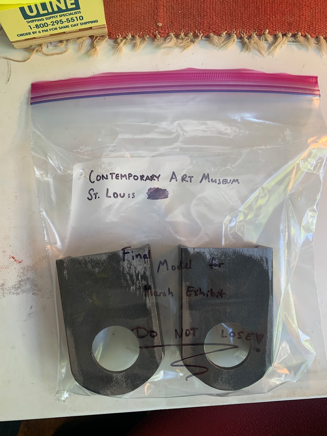

    While I was in Illinois, Luke helped me finish up my motor mounts. I had a feeling they were going to look questionable to TSA, so I made sure to let them know they were for a very important art exhibit.
    Now they're blasted and ready to rock. I also have my biscuit motor mounts from Bob Drake.
