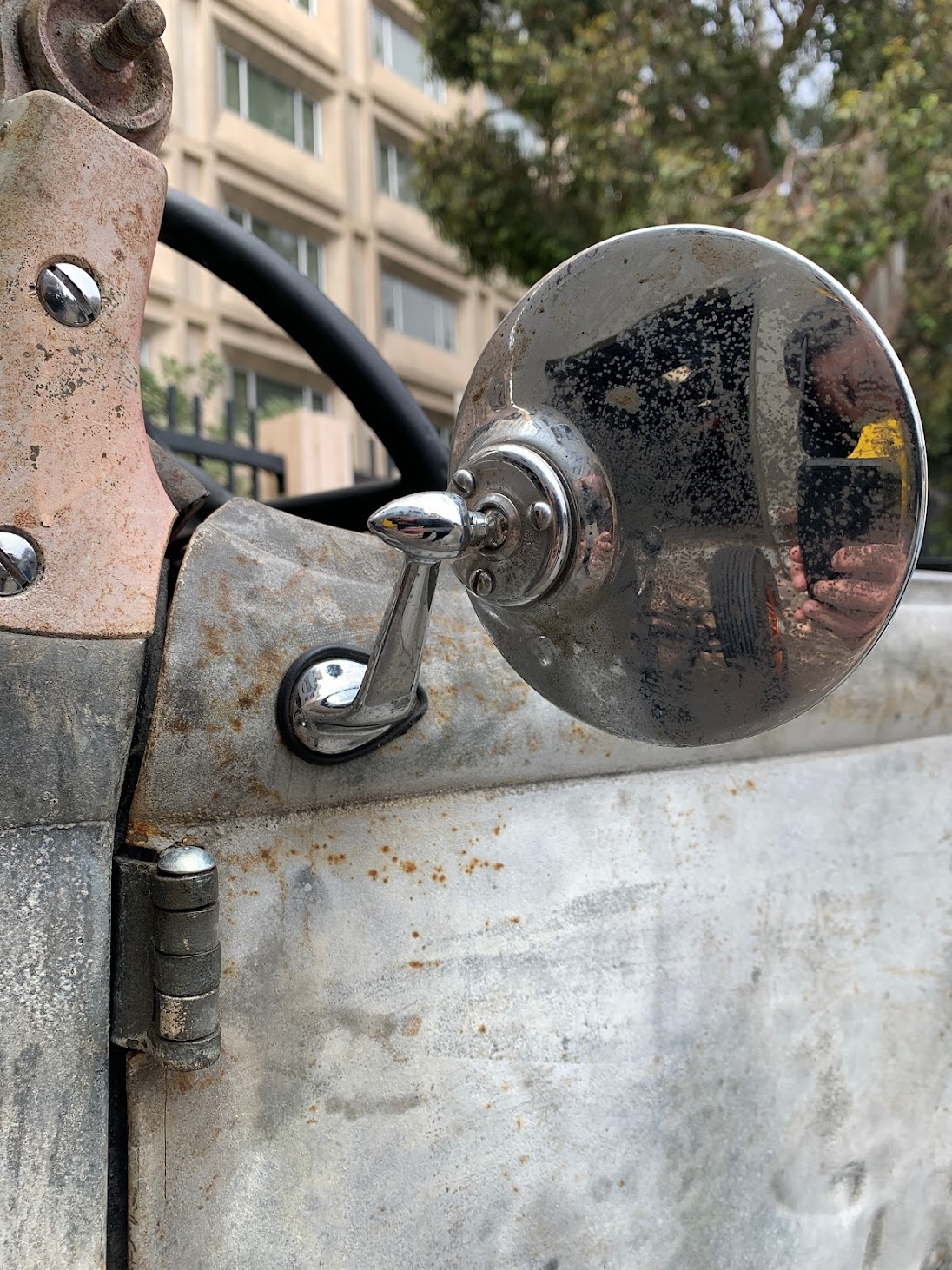

    I’ve seen re-pop mirrors similar to that that I thought would be perfect for the right rod. Seems like maybe they were listed as being for an MG? Looks perfect on your roadster, keep it up :cool:
    found a link for the re-pops…I imagine the original is made much better ;)

    I’ve got those mirrors on my Morris Minor Traveller, I noted the British look too. Nice!

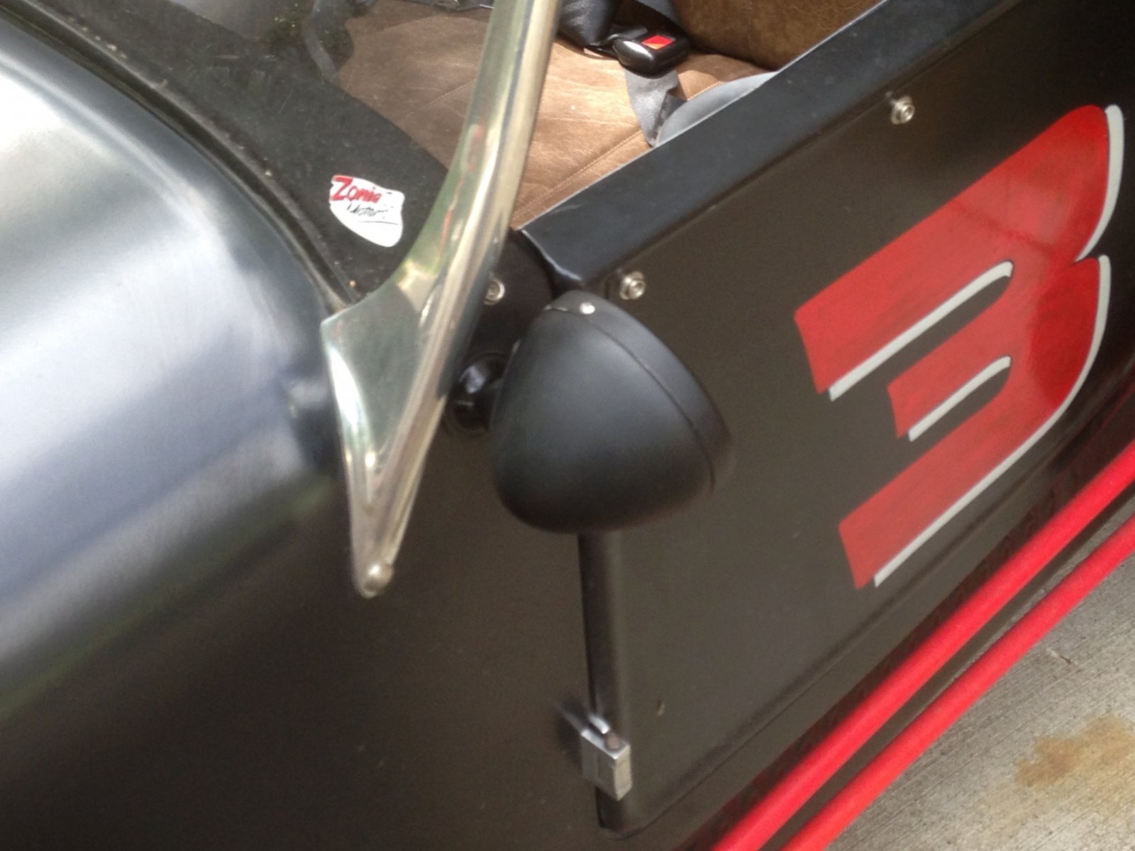

    Found something similar in the Moss Motors web site (on sale for $39.99):
    https://mossmotors.com/raydyot-reproduction-mirrors
    It is brushed aluminum, should be easy enough to paint.

    MG seems right to me. And thank you! I know I'm not the first to run a British mirror, but I think it fits the look and feel of the build just fine. And it's a tip of the hat to my Triumph days!

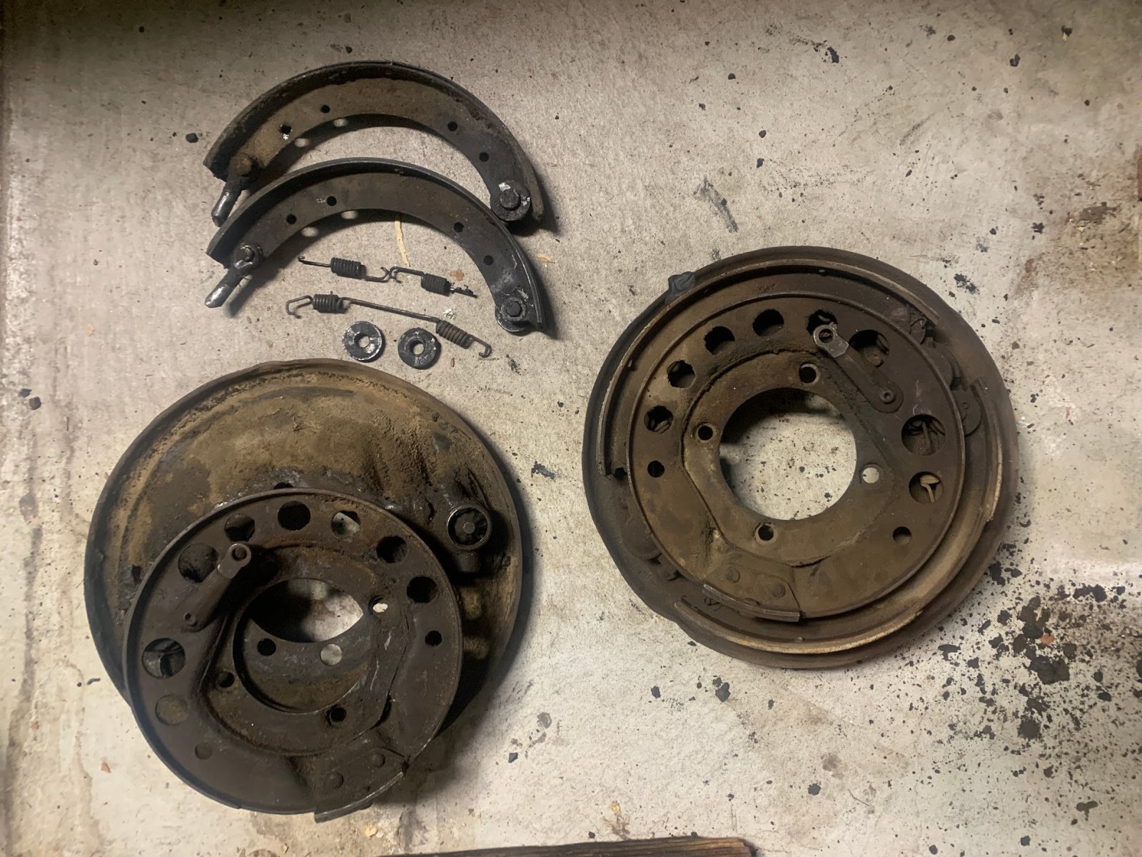

    Last night, I broke into my spare set of brakes. The plan was to strip these clean and build my second set on the bench while the car was still in use. Well, after breaking into them, it became immediately clear that these were in rougher condition than the ones on the car. IMG_7267.jpg
    The main issue was a seized E-brake lever on one and a pair of broken external E-brake springs. These are both fixable, but repairing them and putting them into play seems like a step backwards compared to the decent set that are currently bolted in place.
