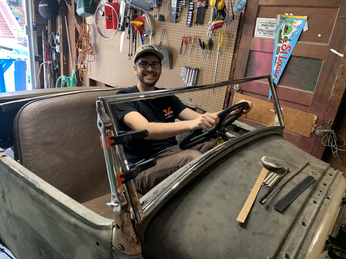

    My brother is in town this week all the way from Michigan and, as you can imagine, I've asked if he could help me with my build in between all of our other San Francisco excursions. Andrew is a diehard hot rod enthusiast and has been a huge player in this project since day zero. He's built a handful of vintage motorcycles and plans to put together a '28-'29 Model A roadster with an early Hemi in the next couple of years. I couldn't be more excited to show him the car. IMG_3640.jpg

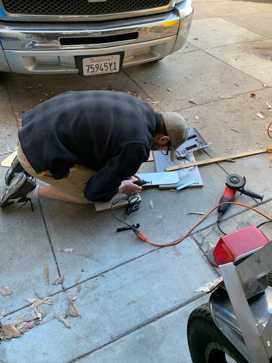

    As soon as we had the pump in position, we decided that it would be a good idea to make a heat shield. Even though it's tucked into the frame several inches above the exhaust collector, we want to keep the pump and lines as cool as possible.
    Andrew making the notch for the fuel pump in the heat shield.
