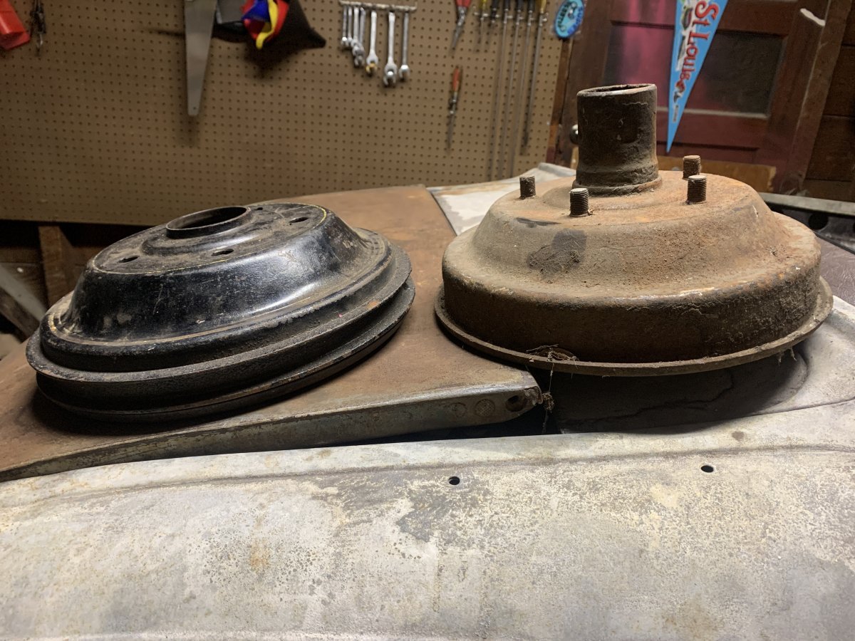

    First and foremost, I've spent a good amount of time and energy figuring out the best way forward for the brakes. At this point, I think I have a plan of attack for Version 1.0, and I intend to start the rebuild after Thanksgiving.

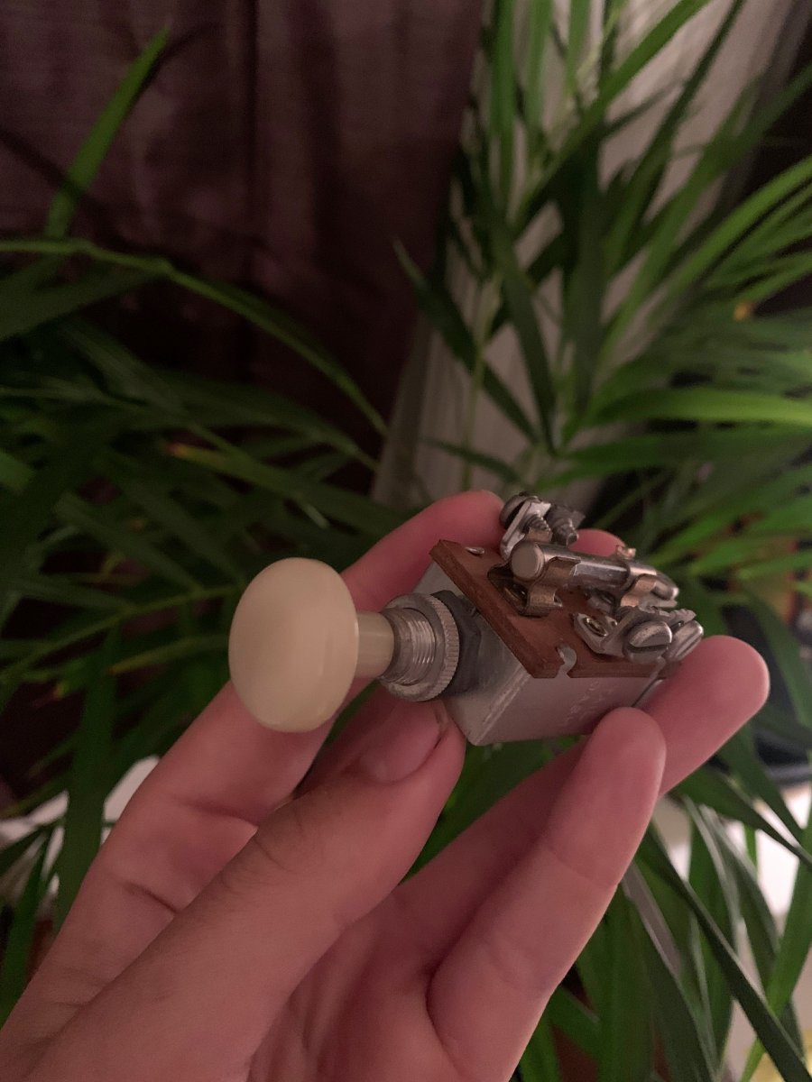

    IMG_1489.jpg Next, I've been collecting/ordering pieces for the headlight setup. My switch arrived on Friday, and my 12 gauge wire should get here early next week.

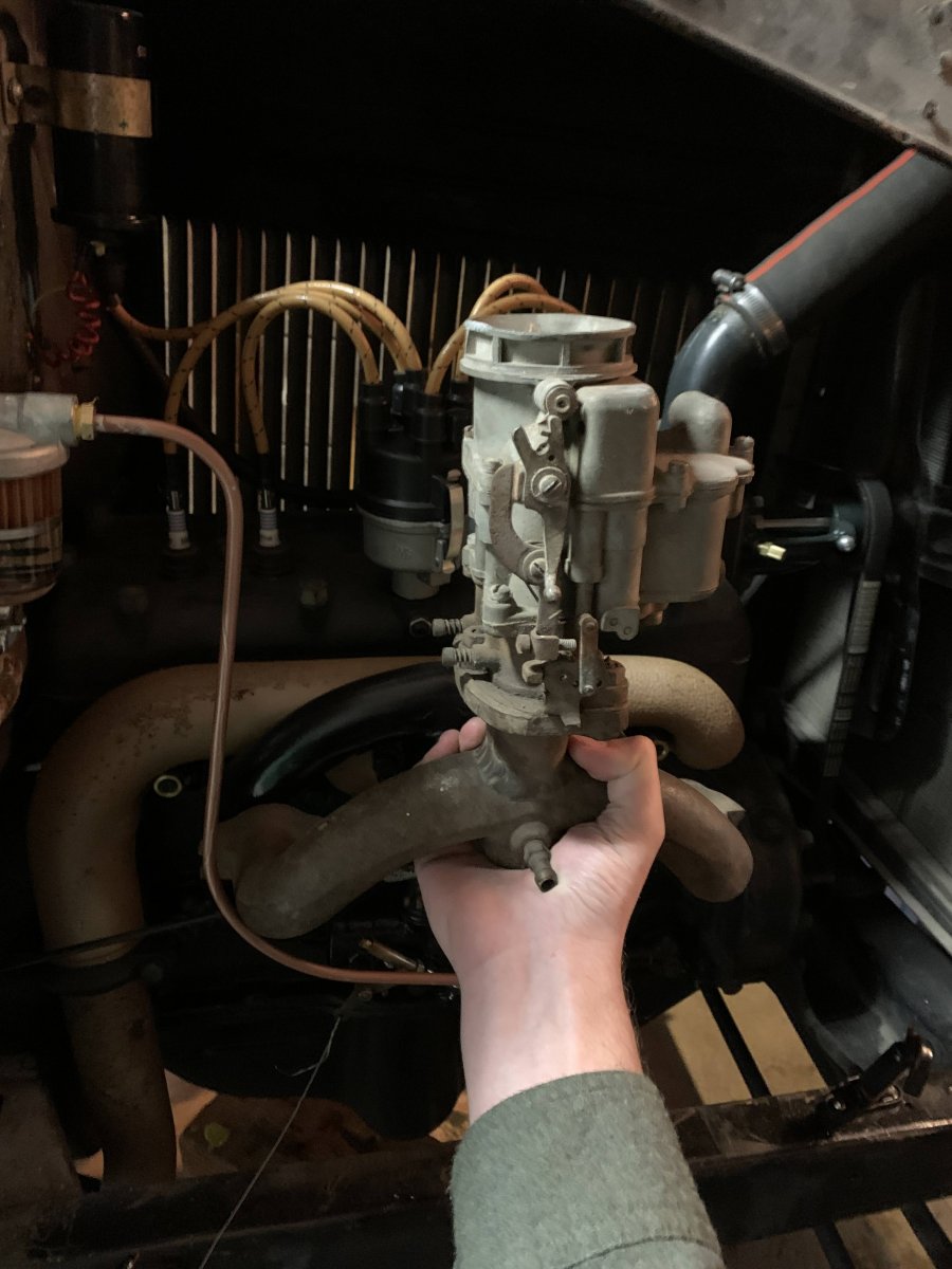

    Today was a big day in the Speed & Power department. This morning, I drove north to Petaluma to swing by David di Falco's shop. As soon as I rolled up, I saw his channeled '30 roadster parked out front. I couldn't help but smile. I've always loved this car, with its deep channel, faded yellow paint and healthy flathead. Now that I have a roadster of my own, I was able to appreciate it in a completely new way.
    A portrait of man and machine, November 2020.

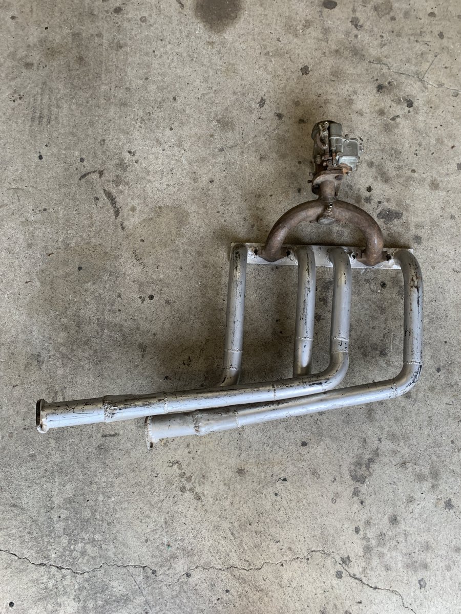

    David had a number of parts for my car, including a homemade downdraft intake and Holley 94 from back in the day. When paired with my gas welded tube header, it's going to make for quite the combo. He and I talked everything from throttle linkages to fuel lines, and it was so fun getting to learn the ins and outs of it all.

  5. Just a heads up about your light switch. I have one of those in my roadster and if there is any kind of tension or pull on the wires they fail to work properly. I thought I had a bad switch and bought a second but did the same thing. There is very little contact with the switch parts inside the case so it doesn't take much tension to lose power. Everything would work but the rear parking lights. This was on both switches. Once I put more slack in the wires everything works as it should.
  6. Mikko_
    Joined: Aug 3, 2018
    Posts: 454
    Mikko_
    from Sweden
    What is the reason for using that kind of light switch instead of the stock one in the center of the steering wheel?
    Just curious since I'm debating with myself whether to use an original style wiring harness in my car or to make my own using the schematic in the Tardel/Bishop book.
    Stogy, chryslerfan55 and J.Ukrop like this.
  7. I went with the later switch because of using a later banjo wheel plus I added turn signals. I also made my own harness. 20190501_080923.jpg

    you can use the banjo wheel/light rod/horn button with the stock ford 28 and up switch at the bottom of your steering box, and still make your own wires coming out of it. not a big deal to shorten the rod

    To be honest, I just thought it felt natural as a left-hand pull and I went with it. It would work just as well using the steering wheel switch. I wired my car from scratch (what feels like a lifetime ago). Let me know if you would like me to PM you the schematic.

    NOTHING wrong with mechanical brakes, there are improvements on the Model A brakes , but hydraulics isn't necessary.
    Use a 32-36 axle( it's already dropped compared with a Model A, use the brakes that came on that axle, they are cast iron, (36 will be wide five) , but all the rest are already set up for wire wheels. I would also use the rear brakes from the same car. You will need the tall perch bolts from a 32-34 to keep the parts all in line.
    Now you have "Rocky Mountain Brakes" on the cheap, a dropped axle and all Ford parts.
    The improvement I would make would be Ted's floaters on all four brakes, AND perfect rods and clevises, brake pedal bushes etc.
    Remember Henry used mechanical brakes for most of the 30s and a third of the life of the flathead V8...all they need is a bit of maintenance/adjustment . With Ted's floaters you will outbrake the tires , before you will need hydraulics.
