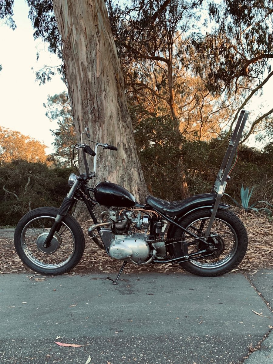

    Love the Triumph in front of the eucalyptus like the ones you described on Yerba Buena. Hard to believe they are not native. Reading your work, I'm beginning to see where your eye and inspirations are coming from. I'll keep watching the build and reading the stories. This build really takes me back. It's good to see you getting so much support from others here and other rodders within striking distance to you.
