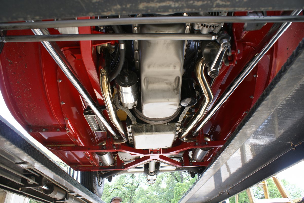

  4. Here's a picture of mine that I built. I used the 2 1/2" kit from Summit for the X.
    HiHelix, mgtstumpy and loudbang like this.

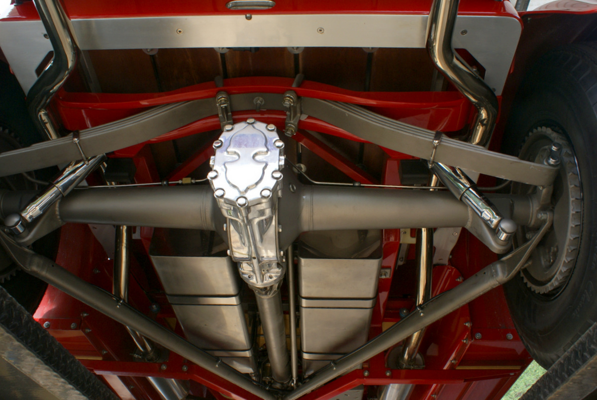

  7. Think it might be hard to get an X pipe in an "A" unless you hung the exhaust pretty low. Here's one we did with cut, fit, and welded U-bends.
    DdoubleD, mgtstumpy and loudbang like this.
