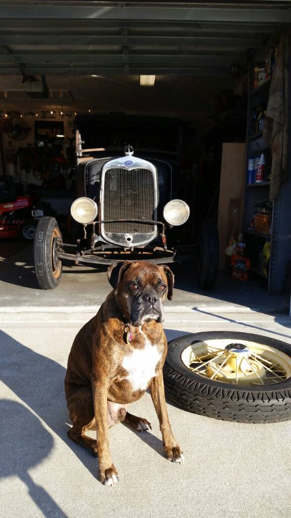

    Great dog, awsome picture! Facial expression reminds me of my ex-wife, when I spent too much time in the garage.
