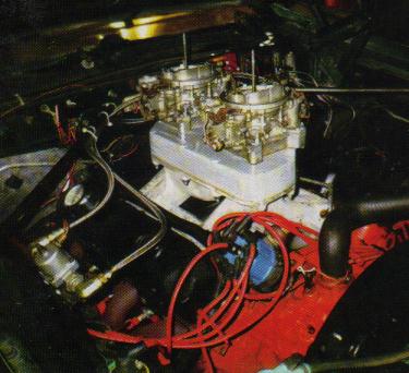

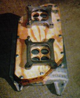

  14. iwent the otherway. I took a wiend SS manifold for a six pack cuda and made a 2x4 tiop. it worked very very well. That manifold is a crossra m/tunnel ram if you will but the work would be the same. I made it first in 3/4 plywood. Sealed it wth garage floor paint (oil /fuel proof) and ran it on the car. When the ET slip said YES!!!!!! I took the wooden part to the local foundry and had it cast in aluminum. . There was zero difference performance in the two (wood vrs aluminum) which was something I worreid about.
    Article about it appreared in Chrysler Power mag in the 90s.
    Don
    There is a pic of the finished aluminum one on my website under some of the projects pages.
