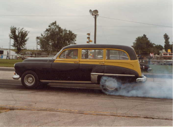

    Can't be too hard, that's what we did when we put a 67 425 and switch pitch in this car in the early 80's. May not of been pretty but I don't remember any leakage issues, transmission is still here somewhere...
