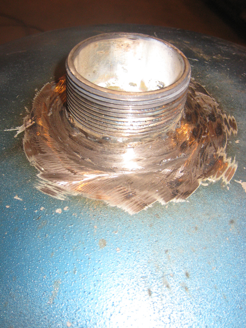

    It's done. I had a lot of fun putting it together. Wonder if I'll have as much fun using it. Here are some pics. I basically spent as little money as I could, within reason, while still building it strong.
    I recycled an old compressor tank. I've got about $40 in plumbing fixtures, ball valves, t joints, nipples and such.
    I spent $45 and ordered a Kuryakin (sp?) hose from the local hose shop.
    I spent $5 per wheel, and $10 for the 5/8" rod I used as an axle. I think the washers, and coder pin were maybe another $5 at Checker.
    The air seperator was a b*&ch! It was the smallest/least expensive unit and it still cost me $40 at EVCO. Fetchers. I think I paid another $10-15 or so on barbed couplings and 5 feet of 3/8 hose at EVCO.
    And lastly I spent $25 on a deadman valve blasting gun from our favorite store, Harbor Frieght. I also spent $20 on 80 grit media from them as well.
    All in all I think I spent about $170 and have what I think is a pretty sweet little media blaster. It's looks like it's comparable to a $400-500 blaster I'd get elsewhere. But the fun was in building it.
