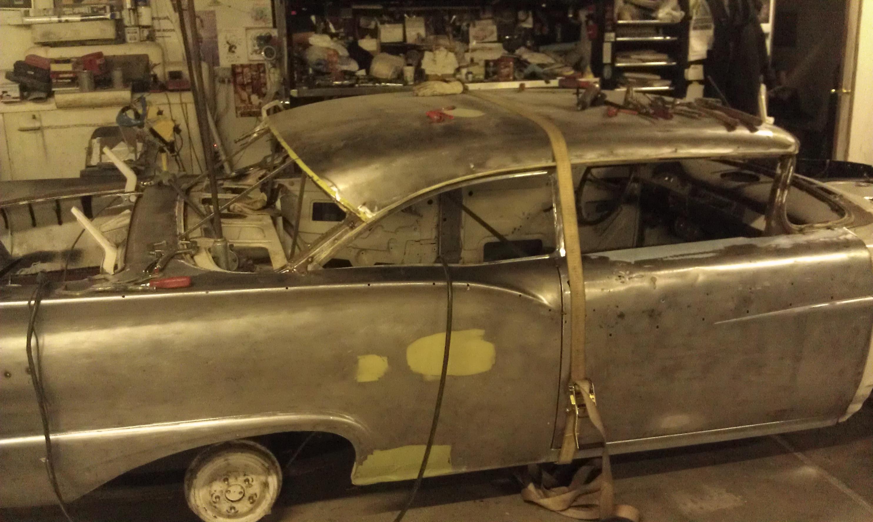

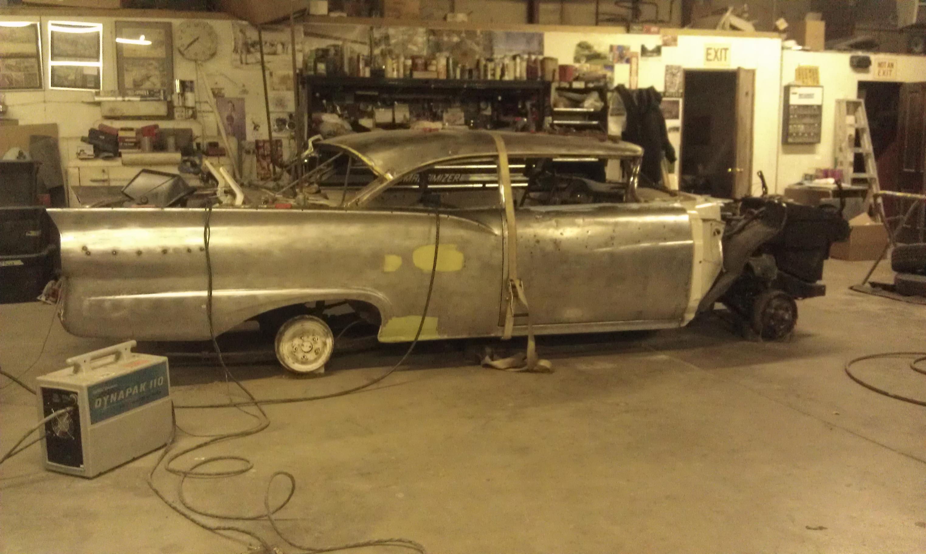

    The 41 is still in cali, at fatluckys getting what is sure to be a stellar interior done, I have made a lot of changes in my life this last two years,(all for the better) I now own 100% of my shop , premier body and paint. I am back on track in my kustom life and have been working hard the last 4 months getting some old stalled projects underway, and some new ones started. 2014 should be a very busy year and I plan on having 3 or 4 new customs out...anyway,...I started working on this car about 3 weeks ago, it is another build for roy(guy who owns the 41 ford), I have some crazy things I want to do, I hope I can pull it all off. Here is the progress soo far, chopped 3.5 inches, working quarter windows, dual antennas, next is extending the fins, taillights and rear end treatment.

    how are u going to cut the windshield?
  17. finkd
    Posts: 1,500
    finkd
    traditional glass cutting method, with a glass cutter and then sanding the edges..

  21. finkd
    Posts: 1,500
    finkd
    WELL, cutting the glas on this can't be that much different then on my chopped 57 caddy, and it was chopped 4.5 inches where this car is just 3.5, and we didn't(knock on wood) break any on my caddy, got it right the first time. just takes time , cut lil half moon chunks out until you get close to where you want to be then sand the edges, sounds easy , but it is harder then that description.. but that's the gest of it...
