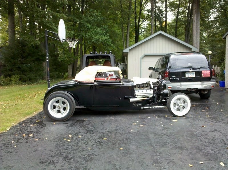

    decided a lift off top would be cool for the 30 COUPESTER i just picked up in a trade deal! here it is , step by step , headed off to an upholsterer this week . i'll post finished pics as soon as i get it back and take some.
    Shot at 2011-10-09
    grabbed a bunch of 1/2" electrical conduit from work and a hand bender and got started the other day after work.
    started by bending the side opening shape that i wanted and began wrapping around the back side of the seat area.
    Shot at 2011-10-09
    figured the best way to get it where i wanted it and have a spot to secure it would be to go to the top of the posts so i cut some of the material out with a cut off disc and bent it over in a 90* and will have one small bolt go through here in the end to hold the top to the posts and will also incorporate a strap that will snap to the inside of the windshield post to hold it down in the front as well.
    Shot at 2011-10-09
    i was working in the rain so i had to move it inside for the rest of the night. notice i taped all of the joints cause i don't have a welder at the house right now , i just use the one at the shop , so i fitted this all together and taped it untill i could get to a welder .
    Shot at 2011-10-09
    added some more tubes
    Shot at 2011-10-09
    then added some more
    Shot at 2011-10-09
    i made a header panel and some more braces front to back with some sheet on them to be able to secure a rear view mirror inside cause with a top on this thing it is much harder to see than it was without a top!
    Shot at 2011-10-09
    Shot at 2011-10-09
    finally got to the shop and had my buddy steve tack it all together
    Shot at 2011-10-09
    and here is a quick mock up of the basic look it will have when done . i am going to chicken wire and pad it and have it wrapped in white cordura , and then putting a tuck and roll white headliner in it!!
    this mock up is just a piece of bubble wrap taped onto the side so i could stand back and make sure i was getting the look right when i first started it !!
    Shot at 2011-10-09
    notice that in the mock up pick the top material will end up covering all of the red interior so from the outside it will not be visible . it will snap to all of the snaps that hold the interior to the outside part of the body on the fold over and the main frame work will also secure with some straps to a couple anchor points behind the seat.
    I will add more pics as i go and show details on how i plan on securing the rest of the top to the car without interfering with the current interior upholsery in any way!!

    Good idea, however just a constructive critique. I would drop the top sides to fill in more like a steel roof would have...either way it's neat. Good luck..
  5. brigrat
    Joined: Nov 9, 2007
    Posts: 5,620
    brigrat
    from Wa.St.
    What Dreddy said and the back isn't flowing for me ( I know there isn't much room for "flowing"), maybe angle of pic? Please don't let this hurt your feelings as I will be stealing some of your great idea's AND that is one nice coupster!
  6. Koz
    Joined: May 5, 2008
    Posts: 2,707
    Koz
    Man that is one gorgeous coupster! I'm seeing more and more on here that look "right". I agree with Dreddybear, I feel the top should be a little fuller over the rear window, more like the profile of a deuce rag. Not knocking your stuff, it's really nice, just my opinion.
    Nice ride no matter what. Keep bangin' on it.

    i went back and forth with the same thoughts you guys are having and still as of last night when i posted this was unsure of the final look . i have a couple more pieces of conduit and was going to mock up fake bows to make it look like a real fold up rag top . i like the idea of making it more traditional but the stretched out wheel base on the car and the wheels and tires kinda made me think the rounded no bow look would suit the car better ,and i still have an actual folding top planned for the future if i keep the car long enough.(bought it to flip it and free up some cash and get into something cheaper,plus i have two other builds in the works for myself and a couple bikes and i am only one man and can only drive/ride one at a time) . i will make the fake bows tonight and look it over in mock up !! i may still go that route but i second guessed it originally for a reason so maybe i won't.
    jp
  8. HOLLYWQQD
    Joined: Apr 23, 2006
    Posts: 722
    HOLLYWQQD
    from central NY
    1. New York H.A.M.B.ers
    i mocked up some bows and looked it over and i didn't like it !! i didn't get pics so this post doesn't mean much but it is definitely gonna stay exactly as it is pictured here . the idea was a carson style top , not a fake rag top ,so i'm happy with the final decision , until i change my mind again tomorrow : ) ;) thanx for the input guys and i will post pics as it progresses.

    ok this post is in need of an update . i was very torn between making this top look more original like and leaving it as is . i threw the frame on the car and looked at it at least a hundred times . i let it sit in the yard and just stared at it with the top frame on it for hours at a time and thought my mind was made up then second guessed myself every time . so i dragged my ass on getting it covered cause i didn't want to waste the money and have to tear it apart to change it later! finally i added one more bow to the top , then i painted it real quick and brought it to an upholsterer . i figure i could go back and forth for years and never finish it or sell the car before its done so i said F&%$ it and dropped it off . here is a couple pics of the final look of the frame and i should have it back within a week or two and will post finished pics right away when it gets mounted up !!
    Shot at 2012-07-07
    here is a profile pic . the bow i added will give it a little bit more traditional look but still fit the not so traditional but not too tasteless look of the rest of the car , it is being covered in white cordura this coming week and should be done the following week .
    Shot at 2012-07-07
