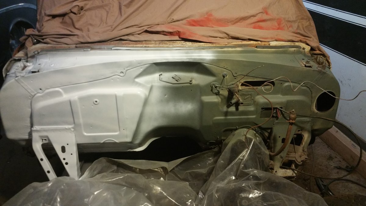

    Stripped the firewall down and after sanding and sanding I primered and began painting the firewall! 20161029_194802.jpg 20161029_194812.jpg 1477792725466.jpg 1477792734837.jpg

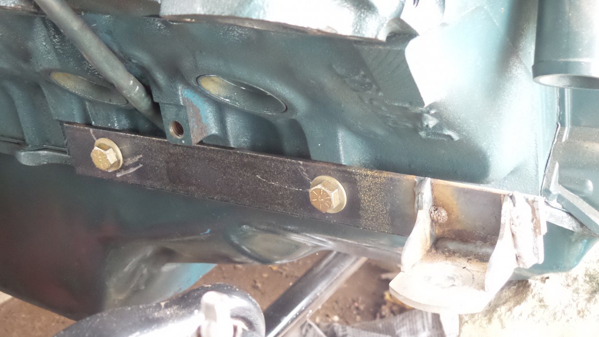

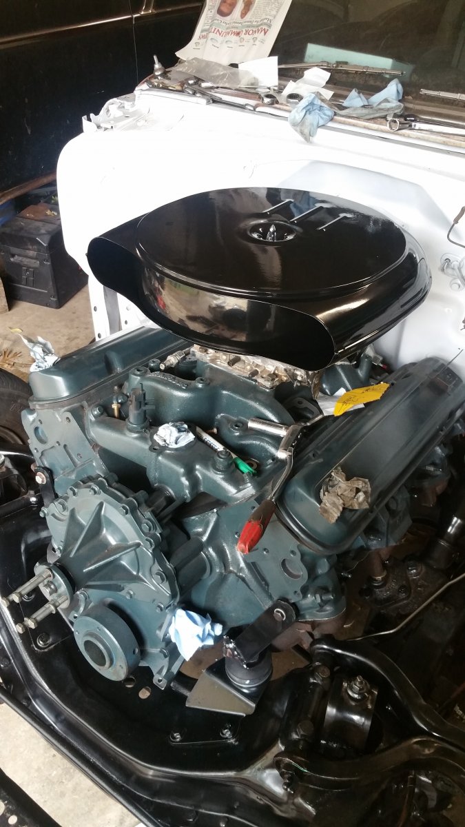

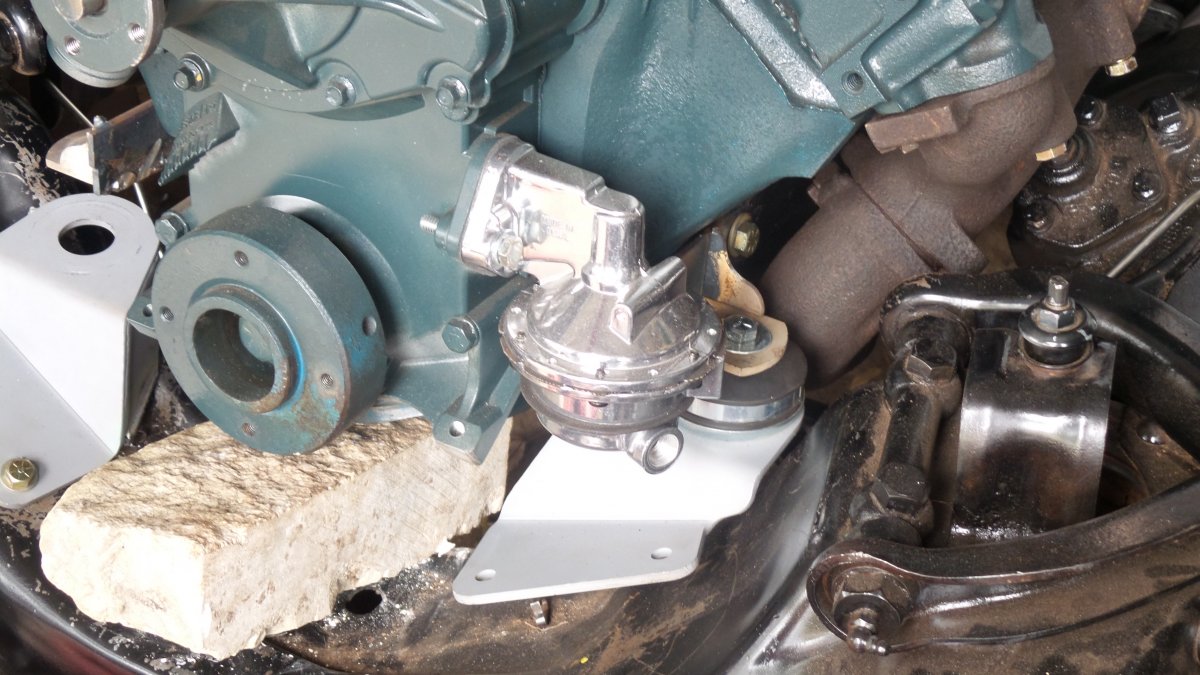

    from Austin, TX
    Heres where things got interesting... So with the help of some member of the HAMB (Yall are bad ass btw) I used a rough idea of the 2nd design Hurst Mounts. My Dad not long after I got my '56 Pontiac got himself a '56 Chevy so we would have matching year model cars. SO that also allowed me to be there and get my hands on the Chevy engine modern engine brackets. SO I ordered a set after finding that the original plan of 2nd gen Fbody frame mounts would hit on the 1958 Exhausts I had bought as they port matched my 6X heads. 1479954253935.jpg 20161211_134454.jpg 20161211_134459.jpg 20161211_134509.jpg 20161218_180122.jpg 20161218_180129.jpg 20161218_180140.jpg

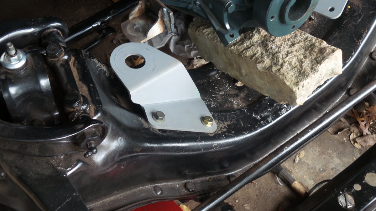

    Bought a Tri-5 Convertible rear Transmission Mount and did a few mods and got it to fit nice. All in All Really Really Happy with how the swap turned out. 20161223_125054.jpg 20161223_125103.jpg 20161223_125118.jpg

    I really like the way this build is going
    What are the ft mounts that bolt to the crossover from?
    Did you mount the trans by the tail shaft? Do you have any picks?

    Omg it just dawned on me that I hadn't posted any updates in a while. I have actually driven her now. So Poncho I will find more pics but the basic engine mount is a tri-5 350 engine mount kit with a Hurst inspired custom made engine bracket that I then welded to the tri 5 engine gussets. I then bought a tri 5 convertible transmission mount that works but I think I am gonna modify what I originally did.

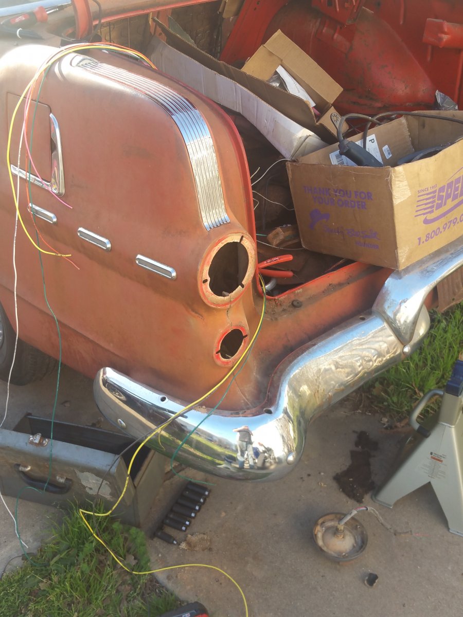

    So ALOT has happened since I last posted a major update. I bought a new jegs wiring harness as I have had good experience with those. I bought exterior lamp lenses form California Pontiac and could lamp harness from Ron Francis Wiring.

    Got some Terminal blocks from Lowes and mounted them in the factory location and wired up everything
