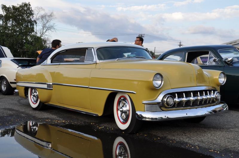

    Here is a picture of the way I bought it, progress pics, and three other hardtops that appeal to me. All three have a similar stance to what mine will be, since it won't be bagged. I feel a chop will be a must! Last one I chopped was a 53' 2 door sedan, so I am looking forward to the 54' Hardtop chop!

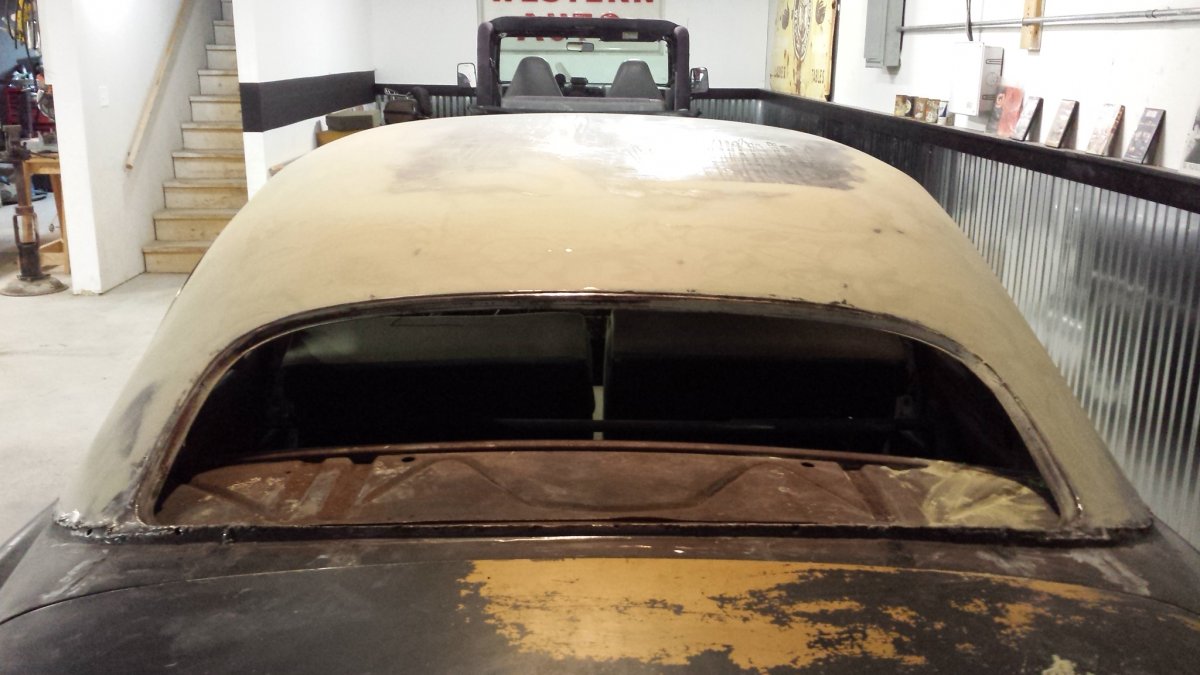

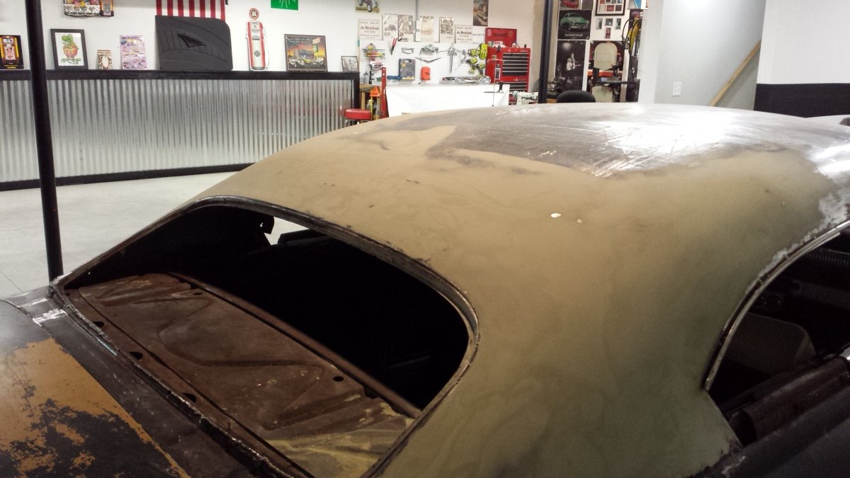

    Been a while since I had time to work on the 54, but the last two days I got the top finished welded and the old paint stripped and ready for filler work.

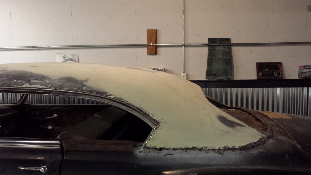

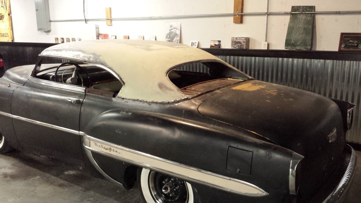

    Made quite a bit of progress the last two days. Admittedly, I'm not building a metal finished show car here, just something different to take the family rides in and enjoy. I did however get everything within an 1/8" of shape so there is mostly a skim coat going across the roof of filler to get it straight. Very pleased with the contour of the new shape of the top and donor rear window.

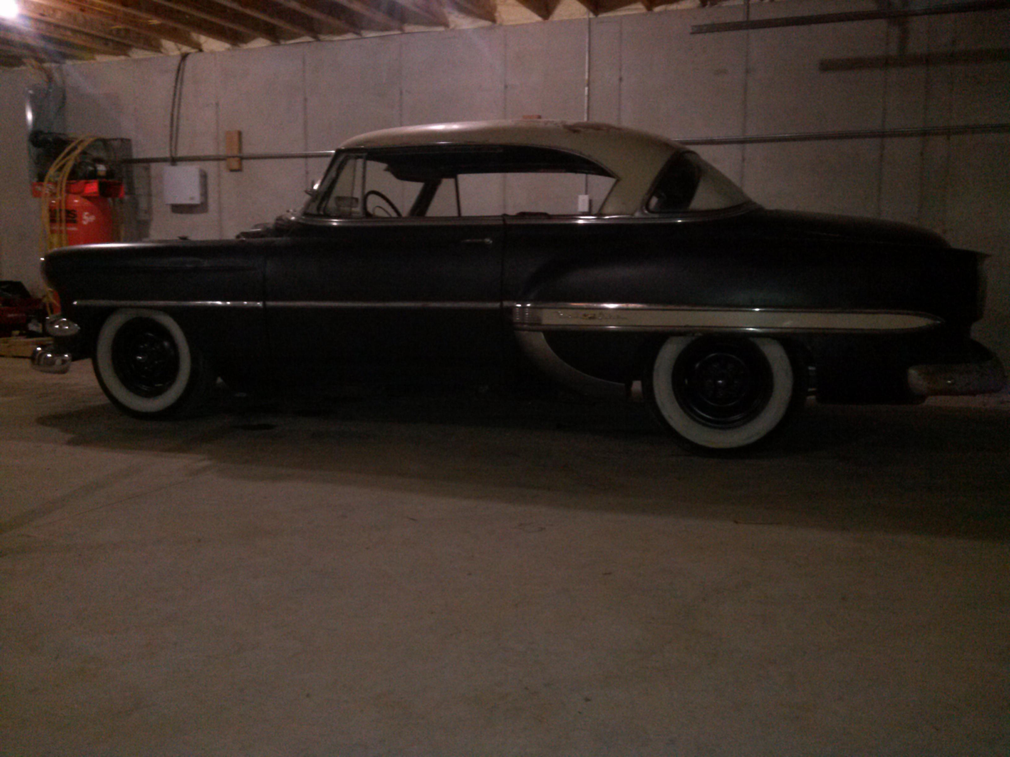

    It's been a while since I've posted, but I have made some progress. The car got a fresh coat of satin black just to get all the panels looking the same for now. I've been working on cutting and trimming the stainless to fit the new roof lines. I'll be cutting the windshield down and getting it put in. Hoping to take her on it's maiden voyage this fall!
