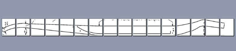

    I wouldnt mind getting a copy of that stencil he used to cut the frame with, or an idea of where to get one!!!
  9. Click on Sams profile and view his other threads, he has several updates.
    I took mine off a rail a pal had, I used rosin paper. Worst case I could trace my pattern for you. Wescotts has a measured drawing on their website as well.
  10. PoPo
    Joined: Jan 3, 2008
    Posts: 1,102
    PoPo
    Hey definately keep your stencil, I dont have any friends that have any 32s nearby so I might need to send you some shipping cash to send me a copy of your stencil. I saw someone one time someone printed the whole dimension off on a computer printer and taped all the pages together but I can't find that thread any longer.

  12. I found a roll of tracing velum in the shop, shoot me a PM and I will copy it off for you.

    Great post. I also built my own 32 frame rails. Sam referred to it at the beginning of his post. Here's the link again:
    http://www.jalopyjournal.com/forum/showthread.php?t=299105
    Looks like a lot of guys would like a full size pattern of the 32 rail ( I get a couple of pm's weekly asking for it) so I'm attaching a file that you can print yourself. It was created with Microsoft Publisher 2003 so you'll need that program to print it. It's pretty common (part of MS Office Business Ed.) so if you don't have it just ask around. The file will have to be unzipped. (sorry but zipping was necessary because HAMB does not recognize .pub files)
    It will print in 16 pages with crop marks for overlaping and taping together.
    Piece of cake...go for it!
