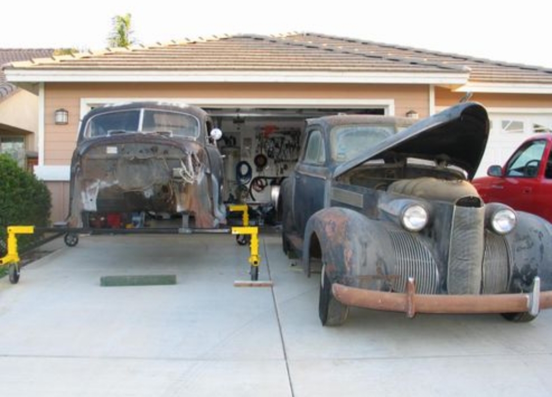

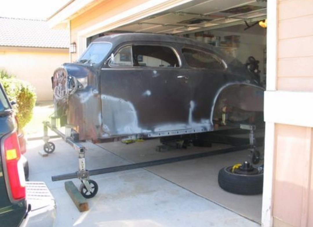

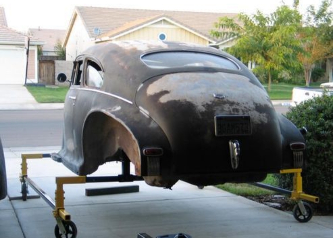

    How many of you have limited garage space to do a full on frame-off restoration? I see many hands flying in the air! Well, with me being one of them, I don't have the luxury of having two separate car garage bays to place the body on a body cart in one garage bay and the frame in another. So, after scratching my head, I thought, "Why not have the body roll over the car frame so I can easily place the body on the driveway while I work my magic on the frame"? The current body carts out in the market are great but they do not allow the body to be rolled over the frame of the car.

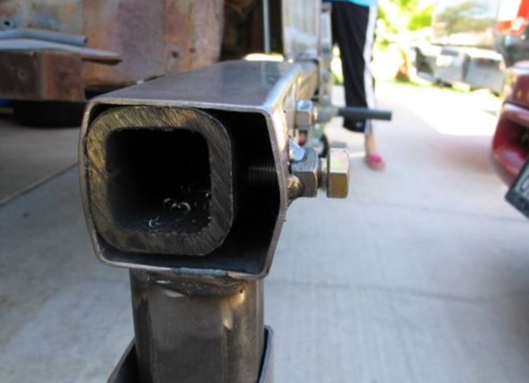

    As you can see, I wanted to make this cart adjustable. What I first did was take measurements of the minimum/maximum height, width, and length of the car chassis and the garage ceiling height. Basically, make sure your car’s body can make it over the car chassis and still exit the garage without any obstructions. By making the cart adjustable, one can tweak to make it suitable for their application. One can always drill a new hole on the body cart to adjust length, etc.

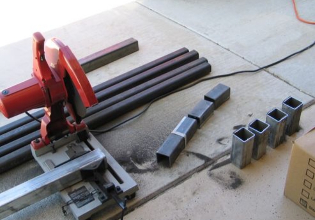

    After getting the dimensions squared away, I worked on what materials to get. I originally was going to make a simple body cart out of 4x4 wood, which could have worked perfectly, but I wanted this particular body cart to be taken apart and stored in a plastic tub when not in use. Also, I knew in my mind, this particular project (1947 Chevrolet Fleetline) was not going to be my last and wanted a cart to be used on any type of car. I simply obtained mild steel square tubing. My thought was using 2 and 2.5 in2 tubing so one can slide into the other. To save some $$$, I got remnant steel from the metal supply. Unfortunately, the 2.5 in2 had a galvanized coating which needed to be grinded away. Also, the 2 in2 tubing had a thicker wall versus the 2.5 in2 but it was still going to work for me (see Figures 7-10). For 40-feet of 2 in2 tubing and 20-feet of 2.5 in2, the total cost was $100.

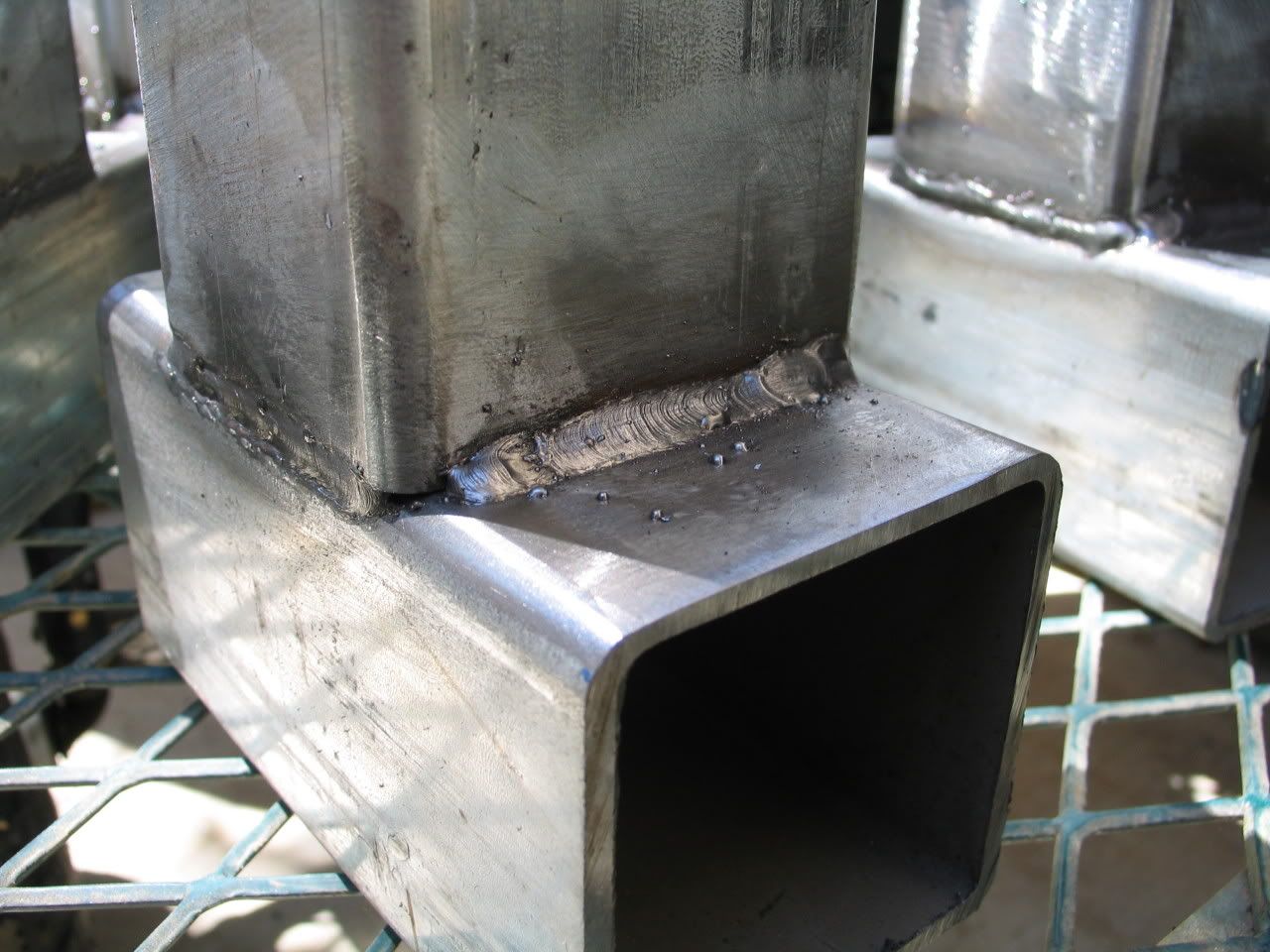

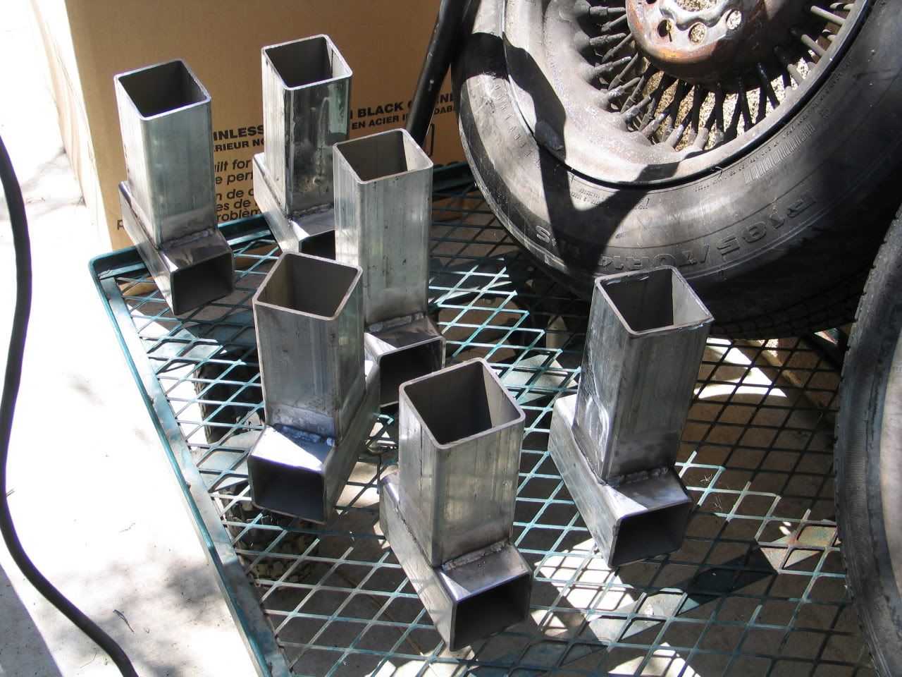

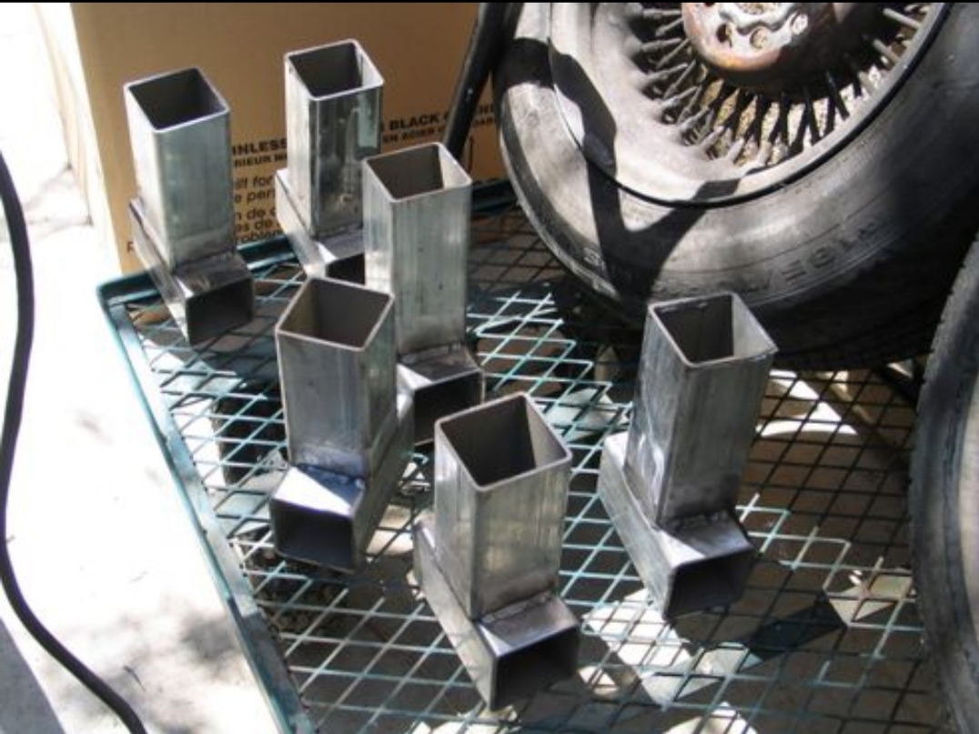

    Construction:
    <o></o>

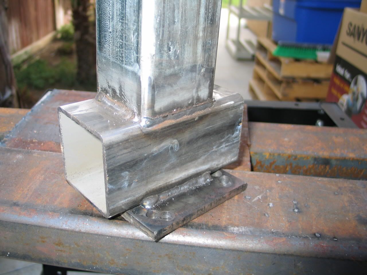

    I began cutting, grinding, and welding the components using a Millermatic 175 220V welder. After all of the pieces were welded, I then proceeded to drill ½” holes (See figures below).

    I used Grade 8 and Grade 5 hardware. I wanted to have the peace of mind that I had tough heavy duty hardware. Here are some more images which tell the story better:

    So, for under $300, I had a heavy duty cart that fit my application of rolling over the chassis and storing it in the garage. I plan to either paint it or powder coat it. Hope this helps many of you. Take care.

    Thanks. It has some tweaks that need to be made but you get the overall idea. I used both set bolts and through hole bolts to make adjustments.

    Never hurts to paint it either:

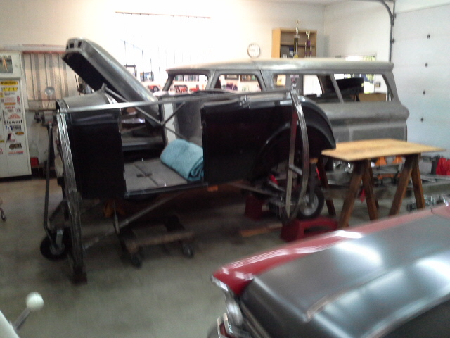

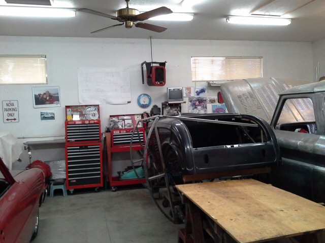

  23. DDDenny
    Posts: 11,637
    I did something similar to roll my 66 Suburban body over the frame. It was not connected front to back as yours is though. I had previously removed the front sheetmetal, doors, engine/trans, and front and rear suspension so it was substantially lighter. Most of the materials were whatever was laying around, including a pair of trailer tongue jacks that neeed repair. The jacks were mounted at each cowl side, they could have been more HD and longer but by dropping the frame to the ground first, they got the job done.
    The only real purchase were the pair of wheelbarrow tire/wheel assemblies from Harbor Freight that were mounted on each rear corner and connected together with a one inch axle that increased the rigidity substantially.
    With lots of wood blocks, jackstands and patience I was able to do the job myself.
    I ultimately repurposed most of these components to build a roll around/rotisserie for my roadster body with the only purchase being two one inch square bent hoops that I cut in half and welded together making (two) one by two inch arches (photo should help make sense), these are used to build the front framework on enclosed trailers.
    BTW, I repurposed the two front stands that had been used for my Novas' rebuild.

    I was tempted to use 1/4 thick for both the 2" and the 2 1/2" thick sections to see if I could get a tighter fit. Rely less on the bolts to keep the steel at vertical. The fit was super tight and would have prevented me from keeping any paint on the pieces. Probably always require a mallet to move pieces around.
    So, I went with 1/4 thick in the 2" pieces for strength but 1/8" thick in the 2 1/2 sleeves.
