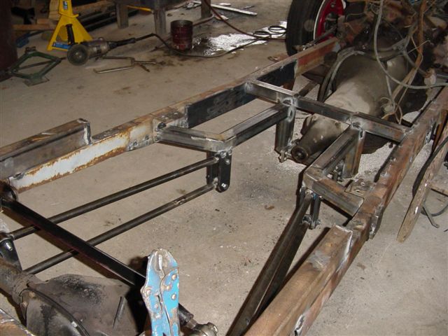

    Been building the frame for awhile, and finally am making a little progress.
    MarkX is working on the chop and filling the roof.

  13. Looking very good. I hope its in your plans to add some K type members into that frame to keep it from flexing and parallelograming. I have built a few A frames, and they are a much more stable platform with a bit of additional internal bracing.

    It definatly will....I plan on adding it after I get the motor / trans positioned in there correctly....Not alot of extra room in there.

    Plan on a 383 sbc / T-5 combo...

    Awesome work man, I love the frame. How long did it take you make it, what all goes into it. I kinda was thinking about building my own as well. Keep us updated man.
